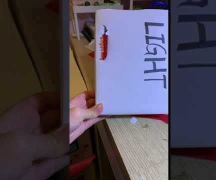

Step 5: Step 4: It's the Time for DIY
first, you need a block and you can add it with some color or even stick it with the paper than make some holes that allow the button and the light to get through it. Before you plug the light you have to make sure that the space that your cover of light so you won't pock it too small or even too big. For this time I'm doing DIY name papercraft so when the light opens the shape on the paper will be shine on the wall. If you are not confident of doing DIY, you can put a very thin paper and cover it. make it circle will fine.
Step 6: The Last Step: Finish Your Lamp
Put the broad in the box also plug the light into to box and put the decoration on the top.
YOU FINISH IT
