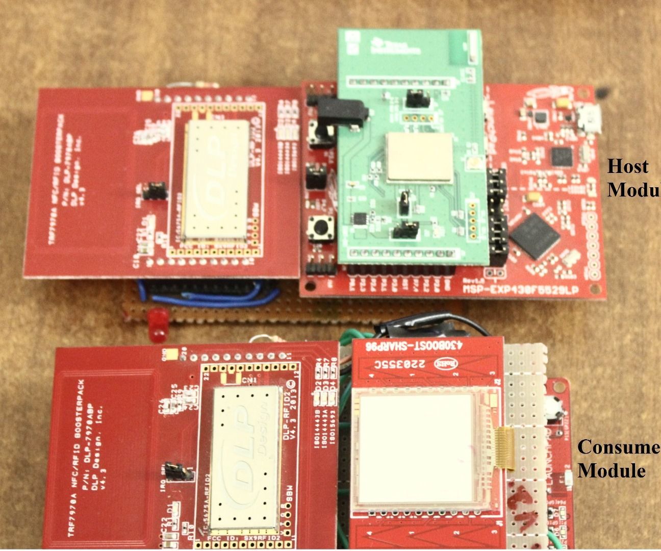

My current project: (Check this)
IOT enabled NFC Shopping
Working Video: https://www.youtube.com/watch?v=6t5t8SaKrW4
Instructables: https://www.instructables.com/id/IOT-Enable-NFC-shopping/
