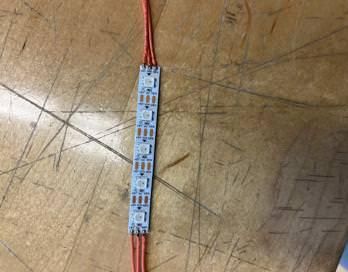

Led Strips (20 pixels)

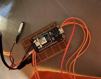

Proto Board
4-Digit Digital Display
Particle Argon

When making this, I divided the wiring into three steps: The LEDs, the Servo, and the 4-Digit Display.
LEDs:

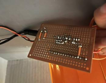

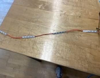

I used a total of 20 LED pixels, cut into 4 strips of 5 pixels. I then soldered the 4 strips together, connecting them with ~3-4 inches of solidcore wire. I then soldered them to a proto board attaching them to the power, ground, and a digital pin.

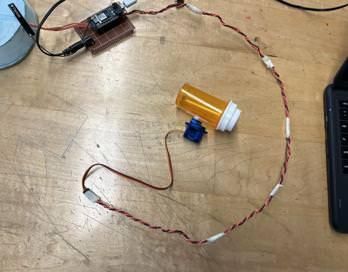

Servo:
I attached a servo to ~15 inches of solidcore wire so it could wrap from behind the box to the side of the box. I attached a small pill bottle to the servo that would go off while the Argon was gathering the data from thee Chicago Data Portal. I soldered the servo to a proto board, connecting it to the power, ground, and a digital pin.
4-Digit Display:
I attached the 4-digit display to two digital pins, as well as the power and ground. I then soldered the display to the proto board.

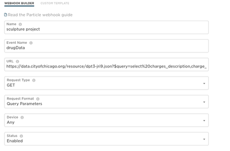

    Particle.subscribe("hook-response/drugData", myHandler);

    // Particle.publish("drugData", data);

Step 3: Putting It Together
  1. We placed the LED strips inside the plastic pills.
  2. We cut a whole in the back of the box so that the wires could flow through the back.
  3. We placed the plastic pills in the large pill bottles, cutting slits in the back wall of the bottle so the wires could slip through. We also cut a whole in the front of the bottle for the 4-digit display, and s;lid the wires through the slits in the bottle.
  4. The proto board was hidden behind the pill bottle, and the servo was pulled through the hole in the back of the box, and brought through a hole in the side wall.
  5. We decorated the box with smaller pills.
