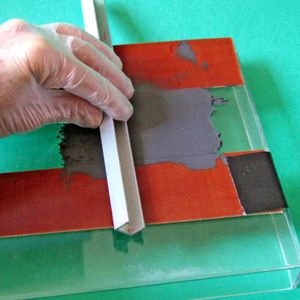

Make A Form
Step 3 pic shows the form which is composed of two 1/16" thick phenolic sheets that are taped to a plastic base about 2-3/8" apart. I used phenolic because I have surplus sheets of it, but any kind of plastic can be used. Oogoo and Oogoo II will stick to any plastic but can be peeled off cleanly using medium force.
Mix Conductive Rubber (Oogoo II)
Oogoo II is basically Oogoo with the addition of graphite to make it conductive and a solvent (Naphtha) to make it possible to mix.
To create a sheet of Oogoo II about 1/16" thick x 2-3/8" x 3-1/2", add 3-1/2 parts graphite powder (by VOLUME) to one part silicone caulk to 1/2 part corn starch . A mix of 5-1/4 Teaspoons Graphite to 1-1/2 Teaspoons Silicone Caulk to 3/4 Teaspoons of Corn Starch gives more than enough to cast one sheet.
First mix the graphite and corn starch together with enough Naphtha to make a thick paste of the powders. Then add the silicone caulk and mix it very well with a popsicle stick or stirring rod. You want to end up with a mix about the consistency of smooth peanut butter.
WARNING: Naphtha is a sickly-sweet smelling solvent that wants to dissolve your brain cells if you breathe too much of it. Make the mix outside with good ventilation or
inside under a vent hood. Wear safety glasses and nitrile gloves, as it can be absorbed by the skin.
I tried at least a dozen different solvents. While other solvents can be used instead of Naphtha, it has the advantage that it evaporates extremely fast and most of the odor is gone in a few hours. Other solvents can take a day or two to dissipate and increase the set up time.
Mix in small batches and use it quickly before it starts to skin up. It will typically set up enough in two or three hours to de-mold. Let it completely set up overnight before using it.

Screed The Sheet
Spread the mix carefully to avoid bubbles and screed it with a stiff piece of metal or plastic and let it set up overnight.
