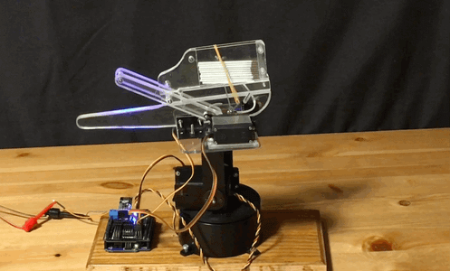

I have provided an illustration of the blueprint for my crossbow above. In the diagram, the length of 65 mm represents the size of the arrows I use, which are fashioned from Q-tips or toothpicks. If you're considering constructing a larger crossbow, you can proportionally scale up the dimensions based on the size of the arrows you intend to use.
My crossbow is crafted using 1/8” Plexiglas and assembled with 2mm bolts and nuts. The bow itself is fashioned from a segment of fiberglass rib that I salvaged from a broken umbrella. The upper part of the bow is connected to the lower portion through a lever mechanism. You can observe a prototype of this design above.
Key Components of the Crossbow including:
Magazine: Holds multiple arrows.
Lever: Connects the upper and lower parts, draws the bowstring, and places it in the cocked position.
Ridge and Groove: Guides the upper part as it slides through the bottom part.
Notch: Catches the bowstring when the pin is in the lower position.
Pin: Moves up and down. When lowered, it allows the bowstring to be positioned for firing; when raised, it releases the bowstring from the cocked position, with the spring force of the bow returning it to its original position.

To facilitate remote control of the crossbow, we will replace the manual lever operation with a servo mechanism. This servo will be strategically positioned at the pivot point of the crossbow. Following this, I secure both the crossbow and the servo onto a piece of plexiglass using two angle brackets. Additionally, I integrate a 5mw laser module at the front to enhance the precision of aiming. Depending on the specific design of your crossbow, you'll need to determine two servo positions: one for raising the pin and another for engaging the string. These positions are demonstrated above and are crucial inputs for the main program.
I've included a small Arduino program that facilitates control of the servo angles via the serial monitor using the Arduino IDE. To successfully run this program, ensure that you have chosen "no line ending" in the serial monitor and then follow the on-screen instructions. You can access the program for download on my GitHub repository.
I repurposed the base and shoulder components of a Lynxmotion robotic arm to design a pan-tilt mechanism for mounting the crossbow, as depicted. The integration of the Sensor shield has significantly simplified the wiring process. In essence, three servos are connected to pins 9, 10, and 11, while the laser is connected to pin 8. The 5V power bank is linked to an external power inlet of the Sensor shield, providing power to both the UNO and the servos. The program is well-documented with explanatory comments placed alongside lines to clarify their functionality. Fundamentally, this program responds to Bluetooth commands received from a phone, enabling precise adjustments to the crossbow's orientation.
