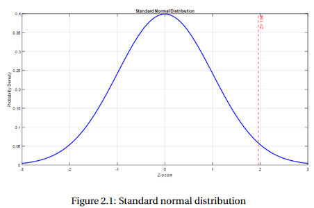

- The critical value of the normal distribution (Z) at the required confidence level. As seen in the Figure 1, Z = 1.96 agrees with an area under the curve from Z = -infinity till Z = 1.96 equal to 0.95 or thus 95%.

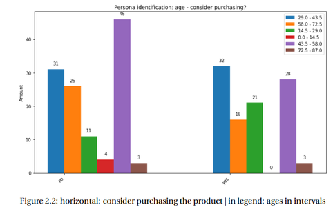

In Figure 2.2 it can be seen that 60% of people that would buy the product have there age around 29 to 58 years. This result is not unexpected since the age from the people who filled in the survey was normally distributed with an average of 48 years of age.

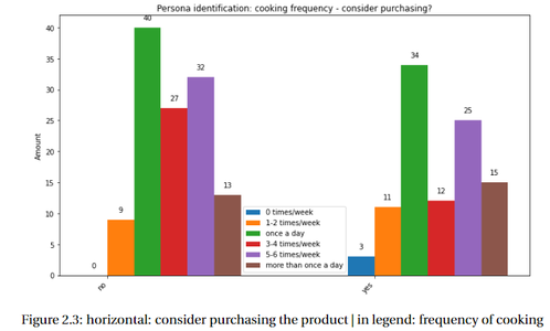

From Figure 2.3 it can be concluded that most of the people interested in the product, cook once a day (and thus not more than once a day!).

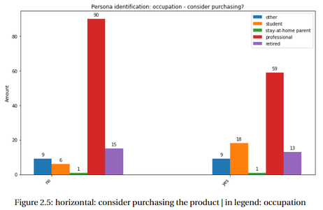

In Figure 2.5 it can be concluded that the amount of interested students is triple the amount of students not interested. This is particularly noteworthy, considering that one might expect students to have fewer expenses compared to, for instance, a retired individual.

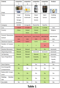

Making use of the criteria utilized for the requirement list we can obtain a series of categories:
- Accessibility: Refers to how possible and how easy it is to get the product, the criteria are:
- Cost: As of now the most important factor since it can by itself make a product viable or not, the ability of a design to stand in common ground with products of the same category is key. For the next comparisons the cheaper the product is, the better.
- Country: The closest the factory or a distributor is to the target audience mean an advantage.
- Geometry: Refers to physical size and capacity of the parts that conform the system, such as:
- General dimensions: Is the height, width and thickness of the system, in this scenario is desirable for the products to occupy the least amount of space possible.
- Maximum Capacity: The total volume of ingredients/items the system can hold, in contrast with the previous criteria the objective is to hold as much as possible.
- Number of containers: The quantity of different elements that the system can contain at a time, having more would be an advantage since it would translate to more variety and grant better management capabilities to the user.
- Operation: Refers to the active or passive action the system to be compared does to achieve its objective. In most cases an automatic action would be easier, more comfortable and quicker for the user.
- Rotation movement: Is the ability of the system to rotate around its own axis, to give the user easy access to the different ingredients being held.
- Dispensing action: The possibility of serving the user the amount of ingredient required.
- Lid opening: In the case of replenishing content or getting access to big objects, the existence of a lid that would grant this action
- Type of ingredients: The different items that can be contained, usually granular items, spices or liquids.
- Smart options: The use of an app or the capacity to do smart actions such as following a recipe or recognizing voice.
- Maintenance: Refers to the approaches the system takes in case of cleaning, repair or replacement, to prolong its lifetime and ensure an optimal use.
- Interchangeable compartments: Individually handling the compartments away from the main system, so that the alternative of storing extra ingredients, changing damaged containers, and washing the compartments separately is present.
- Replaceable components: The possibility to change one or more parts of the system with new ones so that, if broken, the system can be functional again.
- Washing machine safely: The capacity of the machine to resist up to 60°C of heated water, important to make it easier to wash.
- Recyclable: The option of recycling a good amount of the parts of the product once its life cycle ends.
Direct competitors
A small description of all the direct competitor to the system.
- SENRN - Large Capacity Storage Container:
Inexpensive large capacity storage system that allows unmeasured dispensing of different granular, not too small ingredients like rice or cereals.
Has the possibility of rotating, giving access to all of its 6 compartments with ease, but lacks any smart functionality since it is a pure mechanical system. The containers are part of a single piece, accessible and refillable from the top thanks to its one lid. Comes in two sizes, the one being displayed is the smallest one.
- LIVESGOODS - Rotating Cold Kettle:
Super cheap beverage dispenser, made to be placed inside the fridge when needed can give you access to three (or four in the larger version) different liquids, has the ability to rotate so the user can have access to each liquid with ease and each separate container can be removed and used individually.
- PantryChic - smart storage system:
Smart ingredient dispenser, capable of using different size containers, can save and recognize a large variety of grains and spices. Able to precisely dispense each spice with easy and having a mobile app to help with recipes.
The smart storage system can only dispense one ingredient at a time and the replacement of ingredients has to be done manually by the user. There is the possibility to purchase containers, as well as to change and refill ingredients. The containers are washing machine safe and made of recyclable materials.
- TasteTro - Spice System:
Multiple spice dispenser. Having 20, RFID recognizable, spices inside, can easily create mixtures for recipes in a few minutes. The precision dispensing and fast selection makes the creation of recipes a lot less hard and with the smart screen allows the user to favorite their recipes, create their own or select from more than 50 existing ones.
The spice system pods are interchangeable, but they are sealed and cannot be refilled, needing to buy new ones each time one is emptied. As of now this prize-winning innovation is not on official sale but it's official website is still working.
The Table 1 compares the different competitors.

- Artemis - Automatic Cat Feeder:
Not in the same category as the product being designed, but with some changes it could become a threat. The Cat Feeder has smart connectivity with a smart app and the capacity to dispense precise amounts in regular intervals, increasing the number of containers this system has the potential to achieve the same objectives as the ones presented in this document.
- DIOSTA - Coffee Vending Machine:
A vending machine, apart from being a lot more expensive than any other dispensing/organizing system shown, is also a very interesting indirect competitor. Being able to dispense precise quantities, in the correct time and following multiple recipes in only part of its functionality. As a disadvantage this machine has a very complex refilling method and is very difficult to maintain.
Conclusion
Based on the research and analysis on competitors shown above, it is noticeable that the product Cooking Assistant presents a very valid space of opportunity since it mixes the idea of organizations, easy access and smart dispensing in a way no other system in the market does. Nonetheless there have been found, disadvantages as the size, being one of the biggest appliance in its category.
The current development should now focus on keeping the general size and the price of the system as low as possible to increase the chances of success, but based on the information provided the implementation of all the desired options on the product would give it a clear advantage over the competitors.
Therefore, the product Cook Assistant is an innovative system, and this analysis concludes that the development should continue.

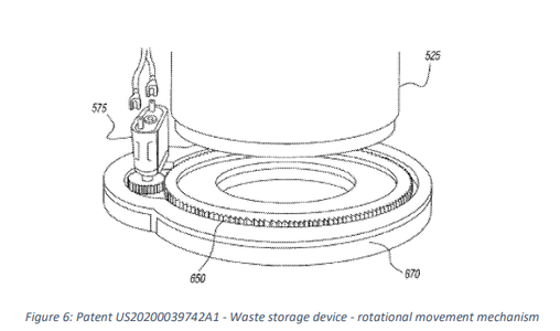

Rotational Motion Mechanism
Another important aspect of the project involves the mechanism designed to generate rotational motion, allowing the selection of various ingredients. This mechanism contains a motor that drives a gearbox, generating a high-torque circular movement around the center of the system.
In order to ensure that this concept did not copy any patents, extensive research was carried out into mechanisms similar to this project from a variety of sources. Many similar mechanisms have been identified in different systems. For example, the patent described in the Figure 3 illustrates a surgical platform which facilities rotational movement at its base. Additionally, Figure 4 represents a patent for a device that uses circular motion to seal trash bags.

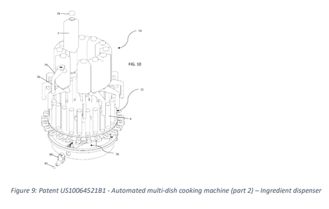

Possible Problematic Patents
As part of the search for patents held by potential competitors for this project, an interesting patent was found that could potentially be an issue for the design of the project. As shown in Figures 11,12 and 13; this patent describes an intelligent ingredient dispenser designed to be placed on top of a pan or saucepan, autonomously preparing complete meals based on pre-programmed recipes.
As this functionality matches some of the main objectives, it was decided to carefully examine the claims of the patent to ensure that the system does not unintentionally replicate this concept. The most important claims of this patent are as follows:
- Claim 1 :
- Multi-ingredient dispenser comprising a base with a collection of containers and a dispensing selector. The dispensing selector comprises a central hub, a geared motor system designed to rotate the central hub, and a pin positioned around the central hub, allowing rotational movement through the geared motor system.
- A set of ingredient dispenser units configured to removably couple with the base receptacles, wherein each ingredient dispenser unit comprises an ingredient container and a dispensing gate, the dispensing gate comprising a hinged door and a coupling mechanism configured to engage with the pin of the dispensing selector during rotation of the central hub and transition the ingredient dispenser unit between a closed state with the hinged door closed and an open state with the hinged door open.
- A control unit, which functions as a computer device, equipped with a user interface. This unit plays an essential role in partially overseeing the dispensing selector and is designed to manage and execute a multi-stage cooking process.
- Claim 2: The automated cooking device according to claim 1, including a cooking device embodying a cooking container equipped with a heating unit and a mixing unit. The control unit partially controls the heating unit and the mixing unit.
- Claim 3: The automated cooking device according to claim 2, including a liquid dispenser.
- Claim 4: The automated cooking device according to claim 2, wherein the base is removable and connectable to the cooking device in a vertical position, at least partially above the cooking vessel. In addition, the multi-ingredient dispenser is horizontally aligned with the cooking device.
Conclusion
After careful consideration and deliberation, the team has reached a unanimous consensus that the detailed claims mentioned above are not directly aligned with the primary objectives and goals of the current development. This understanding gives the team the assurance and confidence to continue smoothly with the design process, without fear of inadvertently reproducing or violating the specified patent claims.

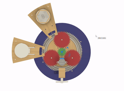

- Mechanical
- Ingredient Selection
This subsystem is the one in charge of moving the container to the front of the appliance.
- Rotation Mechanism
The main component of the subsystem, a mechanism capable of using a motor, the movement of the motor is managed in the processor.
- Lid Opening & Dispensing
Subsystem in charge of granting access to the desired ingredient, the main part is the Dispensing Mechanism, and there are three types.

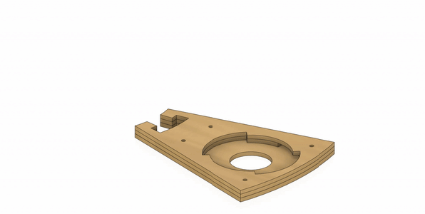

- Support of containers (30° and 60°) :
This piece has been modeled in a CAD software and 3 layers have been created in order to laser cut. 4 holes have been put also on the piece in the CAD design even if it could be done with a drill machine after the piece being produced but it will not be too precise. The wood of 4mm of thickness has been used for all the layers so it gives some space between the bottom and middle layer for the container to be fixed in easily. Indeed, the bottom part of the container has a small piece of wood of 3mm in order to be fixed smoothly in the support. To conclude, the laser cutting technique has been used because of its large cutting range and because it is less time consuming than the 3D printing for this piece specially.

- Rotating disks :
The gears in the rotational mechanism set have all been done in wood. The main reason was that the laser cut technique is time saving. It has been considered that this need to function for a long time, it must be stiff so a good thickness has been chosen for this set.
- Disk to place the triangular support of containers :
This part has been manufactured through the laser cutting machines because of its large dimension and its simple shape. A few layers of 3mm thickness wood has been put on the product and when needed, we added one more layer to increase the stability which could not be done or would not be too efficient if we went for this disk to be in plastic (3D printed).
- Disks to be placed in the bottom of the triangular support :
Theses pieces are mostly here for the assembly of everything together. Due to their large size and with several holes in it, it has been laser cut.

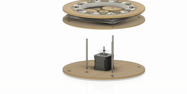

a. Planetary gears and rotating disks : torque and motor needed
One of the primary considerations in choosing the 'central' motor for the robot's rotation is precision. For ingredient distribution purposes, we need to rotate either 30° or 60° depending on the type of containers. Additionally, we also aimed for the motor to provide enough torque power to overcome the friction forces generated by the planetary geartrain and the bearings implemented in the center of the robot.
The torque calculation is performed as follows:
Tmotor needed represent the torque needed for the rotation, and Tfriction denote the torque opposing rotation due to friction. Applying the theorem of angular momentum to the rotating bodies:
I * (d2θ/dt2) = Tmotor needed - Tfriction
Where:
- I is the moment of inertia around the axis of rotation,
- θ is the angular displacement,
- t is time,
- (d2θ/dt2) denotes the second derivative of angular displacement with respect to time.
The model used to estimate the friction in this equation is by assuming the motor will need the highest torque when starting. This means the static friction has to be overcome. Thus:
Thus let's note that Tmotor needed = (1 / (safety factor)) * Tmotor given (the actual torque of the motor) and Tfriction = µstatic * m * g * (Dbore / 2) where m = mdiscs + 6mbig container . We consider the large containers because if we manage to derermine the torque required for rotation in this case, the torque will be largely sufficient for the small containers.
By applying the formula of steiner :
I = Idiscs + 6Ibig container + 6mbig containery2
Where y is the distance from the center point of the rotating disc to the middle point of the big containers and the ‘inertia moment of the discs’ is just the inertia of all the disc the central motor needs to carry. When assuming the containers are filled with water (mass density around 1000 kg/ m³), an estimation of I = 0.4 kg m² was obtained.
By assumating I * (d^2 θ/dt^2) = I * (Δθ/(Δt)^2), it follows that Tmotor needed = safety factor * ((I * (Δθ/(Δt)^2)) + µstatic * m * g * (Dbore / 2)).
We aim to achieve a rotation of 60° in 1 second, so Δθ = 60° and Δt = 1 second. The coefficient of static friction = 0.05.Normally this value should be smaller but when receiving the bearing, it did not spin very well as expected (reference : "Bearing - friction"). Finally, the safety coefficient is 2, which means that the maximum load permissible is half of the breaking or malfunctioning load. As a result we have a torque needed of around 2 Nm.
When it came to the motor selection, we had the choice between a DC motor and a stepper motor, ensuring that for each case, we choose a motor capable of providing sufficient torque. Given that precision and controllability were significant factors, the team opted for a stepper motor, specifically a NEMA 17(cf Figure Stepper motor NEMA17). This motor provides ample power for the robot's requirements and, importantly, is available in the initial project material stock. However, controlling such a motor is done using a driver, in our case, an A4988 (cf Figure A4988 and Thermic device), which comes with the stepper motor. Reference & tutorial : "How to control a stepper motor with an A4988 driver"

Step 8: Integration Guide
Easy step by step guide to integrate subsystems
Step 1. Container
The container is a hexagon made of 6 laser cut 3 mm sheets put together, and a 3D printed Lid connected by a 3D printed hinge to the hexagon. Don’t forget to add a 3 mm screw to the end of the lid’s effector so that it can work as a handle.
Step 2. Dispensing Mechanism
Consist of four parts, three 3D printed shapes and a 3 mm laser cut sheet. The three parts are a mill like actuator and its compartment (top and bottom), the sheet comes at the bottom and works as a lock with the cup holder. The middle part moves freely inside its compartment, all the other parts are fixed together with 4 screws. All of this comes under the Container as shown in the image.
Step 3. Cup Holder
Three 3 mm laser cut sheets, put one on top of the other and fixed with screws, create a locking system to keep the container + dispensing mechanism in place.
Step 4. Rotation Mechanism
As shown in the image, first place 3 long screws on the laser cut base, then place the stepper motor and fix it with screws to another sheet on top.
After that add the special rotation bearing to the same top sheet of the stepper motor and carefully add separators, the sun and planet gears of the planetary gear set.
Then fix the other side of the bearing to the inverted gear and finally the cup holder fixer.
Step 5. Lid Opener
The Lid Opener is very straight forward, there is a F shaped actuator connected to a spur gear fixed to a servomotor. To secure the movement the guide is made by placing laser cut sheets together like in the image. Both side sheets are 4 mm, and the rest is 3 mm.
Step 6. Dispensing Actuator
There is a special 3 mm laser cut sheet that places a 3D printed T shaped actuator to the right distance of the dispensing mechanism of a container, put the T piece in the sheet and the motor. After that the motor to the T shape with a belt.
Step 7. Integration
The sheet where the dispensing actuator is located has holes to fit in the same 3 long screws of the rotating mechanism and also space for the lid opener. To put them in the correct position just add the necessary number of separators between the planetary gear, then the hall sensor and the Dispensing actuator so that the actuator is at the correct height to activate the dispensing mechanism.
Step 8. Cabling + Electronics
All pieces have holes for cables, just pass the cables of the motors in-between the planetary gears thought the cable holes to the bottom of the system and use the space at the bottom to connect the electronics needed.
