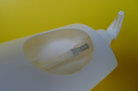

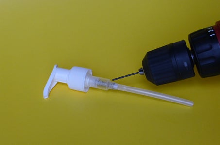

The Engineer's Approach II: introduce an internal by-pass in the pump's cylinder
This method is non-reversible: in the worst case your dispenser pump will be lost. The idea is to create a by-pass, or rather to introduce a leakage to the cylinder. Once the handle is pressed, part of the soap will leave through the sprayer (the standard routing), but part of the soap will leave through the by-pass and will thus flow back to the container. The hole is best located at the bottom of the cylinder in order not to speed up the piston's wear. A hole of 1 mm (0.04 in) resulted in a supply reduction of x%. An advantage of this approach is that the stroke that the user is experiencing is not being influenced. Attentive users might however still notice that 'something has happened to the soap dispenser'.
[End of draft text]

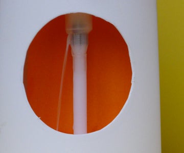

The picture taken of that first experiment is quite spectacular: it shows the soap squirting through the little hole, back into the container, see above (the round opening was only made to be able to visualize the concept).
The bad news was: the approach didn't work, simply because false air was sucked into the cylinder. It worked once only, and then the pump was dead.
The good news is that a new approach was born when documenting the current Instructable, in a similar but improved concept compared to the failed approach reported here. First tests show an output reduction of 60%, again by applying an internal by-pass. Praise the maker's process of iteration! This concept will be documented soon here at Instructables.

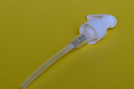

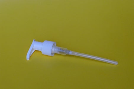

Step 1: More Pictures of the Failure
As explained in the previous Step, an on-purpose by-pass was made to reduce the soap output of the dispenser. The round hole in the container is only to see what's happening. The picture in the Introduction (first picture) shows what's happening when the dispenser's handle is activated: part of the liquid soap gushes back into the container.
