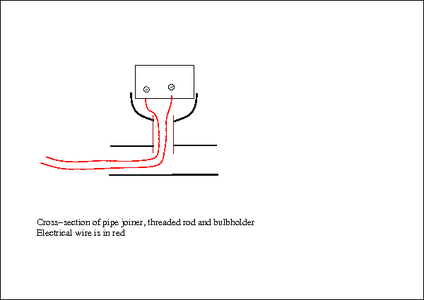

Drill and tap the jointing pieces to take the threaded tube that connects the bulbholders to the chandelier ring. Make sure that the threaded hole is perpendicular to the plane of the ring - use a pillar drill with the join flat on the drill table, and use a centre punch to get the hole centred properly. It may be necessary to cut the threaded tube short, so that it does not penetrate too far into the joiners and does not show excessive length. I chose to not expose any tube, so that the bulbholders are flush with the joiners.

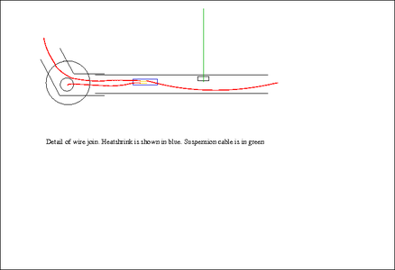

Drill a hole in one of the tube sections to allow eventual egress of the power cable. Drill a small hole in centre of four of the tubes to take the aircraft cable. If the electrical cable is to be secured to the aircraft cable, drill the two holes side-by-side.

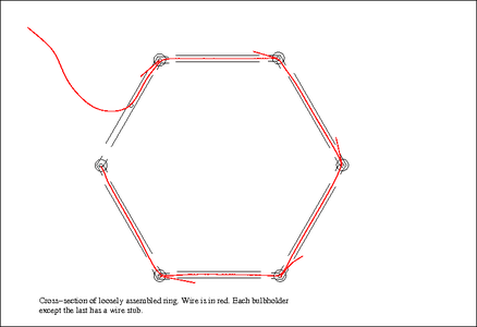

The power cable forms a 340 degree ring inside the copper tube, terminating at one bulbholder, with seven stubs that lead to the remaining bulbholders.
Cut lengths of twin cable for each of the seven joiners. About 5 inches; assemble one to check the length required. Disassemble the bulbholder, strip one end of the wires and fit the wires into the terminals as normal, screwing them down. Screw the threaded tube into the bulbholder base and the copper joiner, then pass the wire end through the tube and out the left arm of the joiner, and then re-assemble the bulbholder. There should be enough cable showing to allow the end to be stripped and a solder joint made - about 2".
For the first bulbholder, pass the entire length of electrical wire through the hole in the one tube, then through each joiner and the other tubes and joiners in turn, emerging from the hole in the last joiner to connect to the last bulbholder. The length of wire that lies inside the pipes should be split into two separate wires. In fact, the entire length of cable can be split, and later braided or twisted where it's exposed in the run to the ceiling. Thread seven 1" lengths of heat-shrink tube onto each wire and pass them along so that they are exposed at each join.
Make each wire joint in turn starting with the last, assembling each pipe join as you go. I assembled the entire ring and tested it, then glued the joints, but it should be possible to test and glue as you go. Carefully strip about 1/3 an inch of insulation from the long run of wire, without breaking the conductor. Strip the same length from the wire stub and solder them together. Slide the heatshrink over the join and shrink it with a heatgun (or hair-dryer, or cigarette lighter, making sure not to actually melt it). Then slide the copper tube up over the wire join and insert it into the copper joiner. There should be enough slack in the wire to slide the pipe joints open enough to glue them later.
