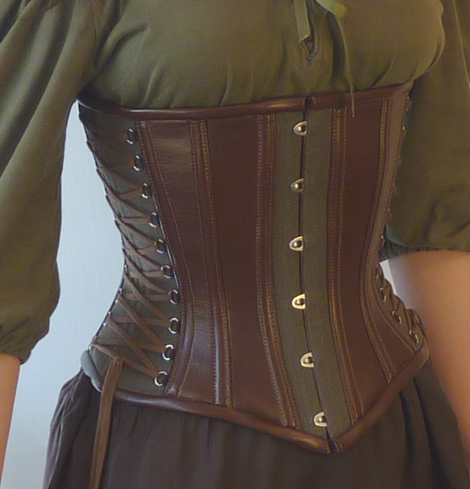

This corset is considerably more challenging then my other corset instructable and will
require a fair amount of hand sewing. It will also require several iterations of mock-up,
fitting and adjusting to get the correct fit. If this is your first time making a corset I
recommend starting with my other instructable How to make a Steampunk Corset as it
is far more basic and it is much easier to fit properly.
