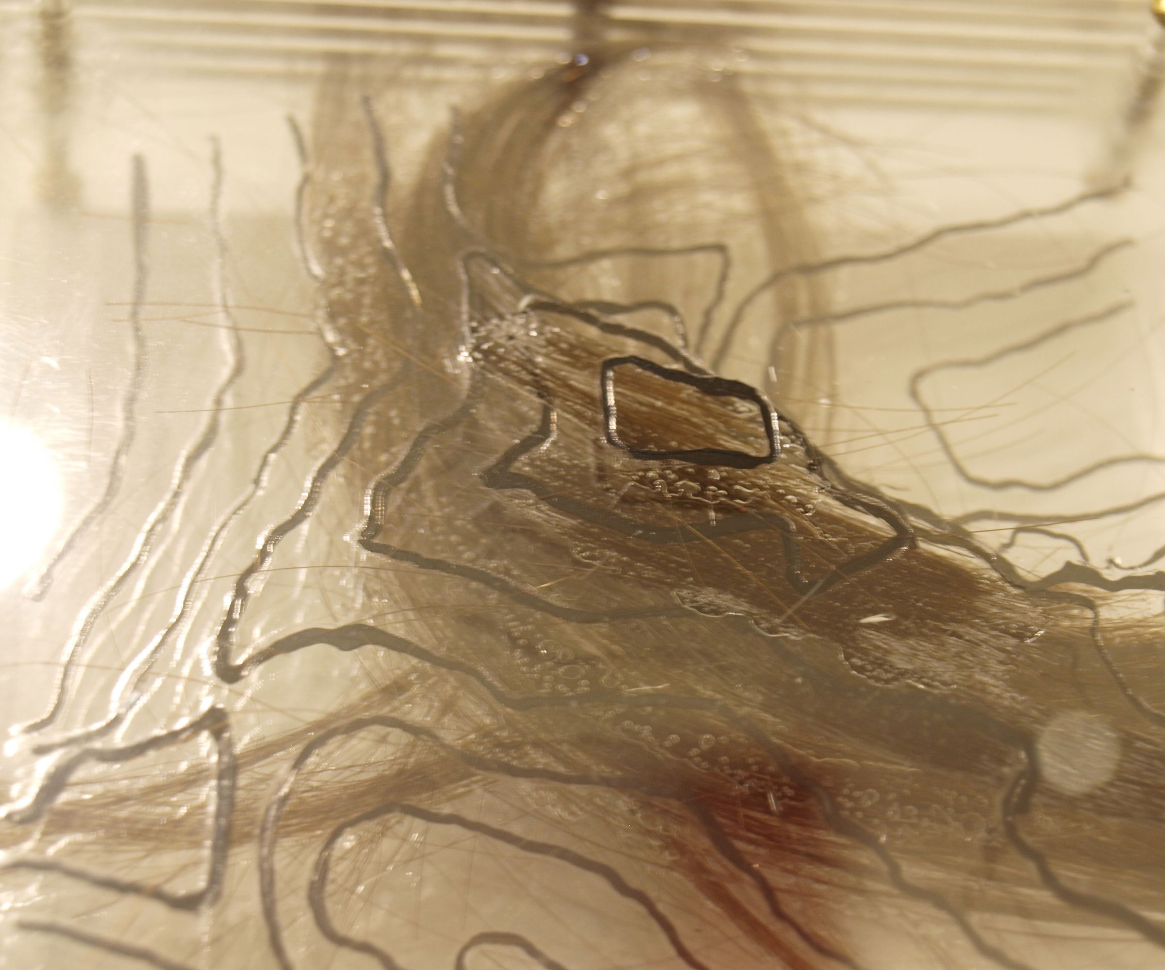

Image 1 - Using a CNC machine with a drawing tool and a pen instead of a bit, I drew the contours taken from MRIs of my heart
Image 2 - A laser cutter using the topo lines as cutting lines, of my spine
Image 3 - Wood laser-etched with an MRI of my spine
