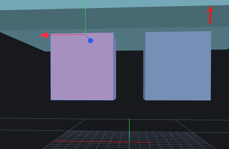

To start off, I deleted the main texture so I can see the entire shape, because we are going to be making changes to the body of the golem (slide 1)
I then deleted the nose and lower part of the body (slide 2).
I also scaled the arms to X: 4 Y: 16 Z: 6 (X is red, Y is green, and Z is blue). I also moved the arms up to a Y: 14.9.

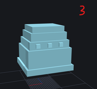

Using the main body, I scaled and positioned it to make a platform, then I duplicated the shape, using Ctrl(o Command)+D and scaled till it looked like a pyramid (slide 3). Exact coordinates for each shape are below:
Shape 1: Position: X: -13 Y: 10.9 Z: -12. Scale: X: 25 Y: 3 Z: 23
Shape 2: Position: X: -12 Y: 13.9 Z: -11. Scale: X: 23 Y: 9 Z: 21
Shape 3: Position: X: -11 Y: -16.9 Z: -10. Scale: X: 21 Y: 10 Z: 19.
Shape 4: Position: X: -10 Y: 18.9 Z: -9. Scale: X: 19 Y: 12 Z: 17.
Shape 5: Position: X: -9 Y: 21.9 Z: -8. Scale: X: 17 Y: 12 Z: 15.
Next I duplicated part of the body and made three small buttons on the body. (slide 4).

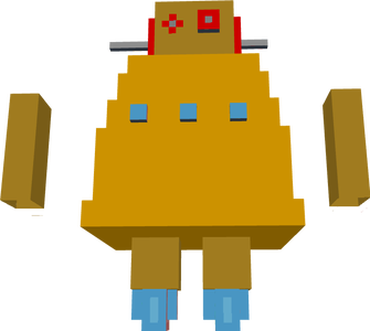

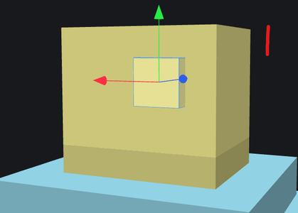

I positioned the head with coordinates of: X: -6 Y: 33.9 Z: -4.5. And then scaled it to: X: 11 Y: 10 Z: 8.
To make the eye I duplicated the head shape, and scaled it down to a small cube. I then placed it on the right side of the head(see screenshot 1).
I then duplicated the head again and scaled it so that it bumped slightly outside of the head (screenshot 2).
Next I duplicated the head shape one last time and then scaled it down to: X: 23 Y: 1 Z: 1. And then placed it in the center of the head so that it pokes out on either side of the head.

To paint the eyes I colored I used a red color and then painted a grayish dot in the center of the eye, I did this on both sides, making the other eye smaller, I also used the same red color to paint the bumps on the side of the head.
I also used a light gray color to paint the the last shape on the head. After I was finished with that, I used a black paint color and painted in the mouth and eyebrows

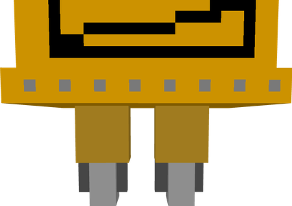

Next I painted a small black box in the center of the body and made a diagonal line going across of it.
Then I painted the three "buttons" on the body with the same gray color used to paint the fingers using the paint bucket tool.
The last thing I did was paint light gray dots around the base of the entire body, three pixels apart, using the paint brush tool on a pixel setting of one.
