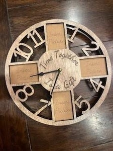

I have been wanting to make a clock since I started working with laser cutting. I happened to be in a Cracker Barrel a couple of months ago and saw a clock that incorporated pictures into its frame. I thought this was a neat idea and with Mother’s Day coming up, I decided this was the perfect time to give it a try.
The following are the steps I took to make my clock. The clock design utilizes 2 layers of ¼” basswood plywood and a purchased clock mechanism. It is setup to be displayed by hanging on a wall and has spots for 4 wallet size pictures.

Glue the front and back panels together with wood glue. I use large binder clips to hold pressure while the glue was curing. I forgot to take a picture with the clips on it. From the back you can see how the 0.125” insets were creating this frame for the picture. I will cover what to use as a back in the last step.

Sand any scorch marks on the surface of the front layer. Apply a generous amount of gel stain to the front layer ensuring to work it into the engraving and then wipe down ASAP.
Once the gel stain is dry, apply 2 coats of clear coat.
Step 13: Assemble the Mechanism
Select which set of clock hands you want to use (I used mediums for this project) and follow the instructions provided with the clock mechanism.
Step 14: Create Picture Frame Back
I left this step for last because I didn’t know how I was going to do it. I tried several things but settled on a very simple solution. I use the laser cutter to make backs out of 1/8 cardboard that are held in place by friction. Cut 4 pieces of cardboard slightly larger in one dimension than the middle size rectangle. (ie 3.55” x 2.50”) This 0.05 was all I needed to keep things secure.
