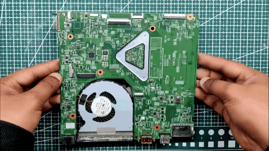

Here's the motherboard that has been salvaged from the donor laptop.
The motherboard is a compact mini ATX-like board with a fan attached to a heat pipe and processor for heat dissipation. It also has a USB 3.0 port, an HDMI port, an Ethernet port, and an SD card slot. FPC connectors are also available for attaching various devices, such as external IO ports and displays.
The board's core processor, an AMD E2, is paired with a 4GB DDR3 RAM stick.
The AMD E2 1800, also referred to as Zacate, was a single-channel DDR3-1333 memory controller and dual-core notebook processor with integrated graphics.
The AMD Bobcat architecture, which is often used in low-end microprocessors like the E2 in this case, is utilized.
Bobcat cores and GPU cores are utilized in APUs with a TDP of 18 W or less. The CPU uses socket FT1, commonly known as the BGA-413 package, and the technology node is 40 nm.
Overall, this motherboard is not a powerful one that can handle demanding tasks like gaming or intensive computing; nonetheless, we can use it to operate a few Chrome tabs or watch a movie.

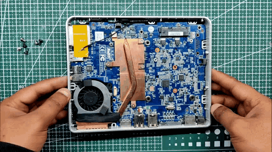

Step 4: Why Not Use SBC Instead?
I purchased this little SBC computer with an Intel Atom processor from a nearby computer retailer.
This device supposedly ran Windows 7 as its primary operating system and was used to run a few software applications in an industrial press.
It has a single-core Intel Atom N450 CPU with a total TDP of 5.5W that operates on a 45 nm technology node. Although it has been discontinued, more recent versions are currently being produced.
With regard to the RAM, it has a 2GB DDR3 RAM stick and a 32GB mSATA SSD, which is just insufficient for operating anything and is another reason why I didn't utilize this board.

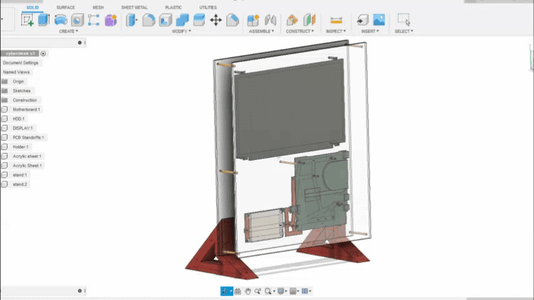

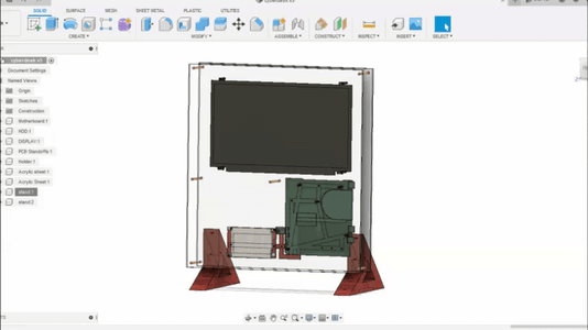

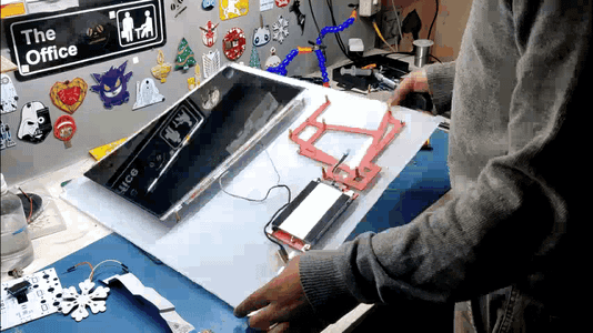

Step 6: 3D Design
Here is how the CyberDesk PC is made; it is made of two acrylic sheets that are bolted together with six M5 bolts. The motherboard, screen, and HDD are all electronics that are placed between two panes of acrylic.
Using an acrylic sheet allows the PC to be completely transparent, which looks amazing.
Additionally, two stands were modeled, holding the entire PC and ensuring its stability when placed on a desk.

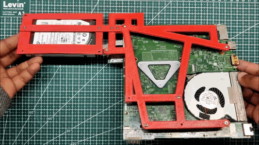

Step 7: 3D Printed Motherboard and Hard Disk Holder
We also designed a motherboard holder that uses PCB standoffs and M3 screws to hold the motherboard in place and attach it to the HDD.
This component will be subsequently attached to the acrylic sheet, simplifying assembly.
Red PLA was used to print the motherboard holder, with a 0.4mm nozzle and 50% infill.

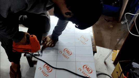

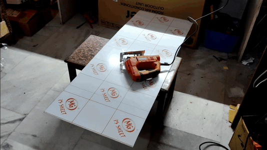

Step 8: Preparing Base From Acyclic Sheet
  • Using a power saw, we first cut the acrylic sheet into two pieces, each measuring 445 mm by 485 mm by 5 mm.
Working with acrylic sheet can be challenging; if you use the wrong saw or put too much pressure on it, it could crack. (Overuse of force during cutting caused the front panel to crack from the top side.)

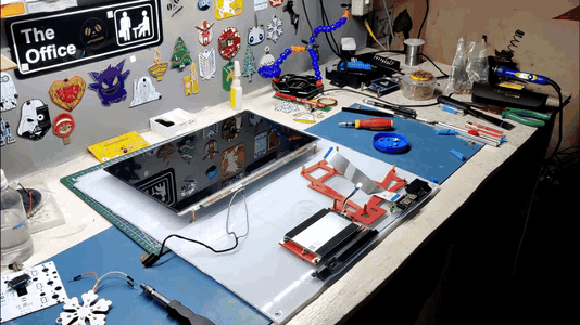

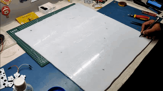

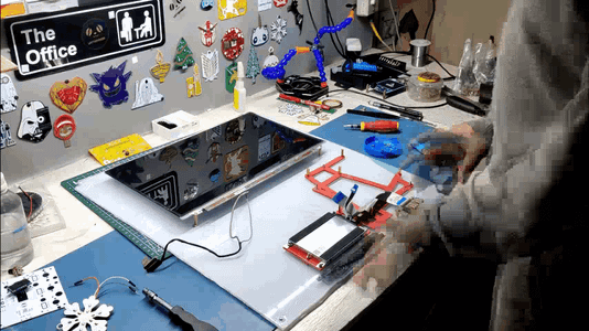

Step 9: Marking the Sheet for Drilling Holes
  • After that, we take one acrylic sheet and arrange all the parts on it before marking holes for PCB standoffs and nut bolts, which will be used to fasten everything to the base sheet.
  • In order to later attach six M5 Nuts and bolts to hold two sheets together, we additionally add six mounting holes to the front sheet.
  • After marking the locations of the holes, we drill them using an M3 bit for PCB standoffs and an M5 bit for larger nuts and bolts used to join two sheets.
Step 10: Adding the Motherboard Holder to Acrylic Sheet
  • In order to avoid having to directly attach the motherboard to the acrylic sheet, we first attach the 3D-printed Motherboard Holder to the Base sheet using M3 bolts and nuts. This section also holds the HDD.

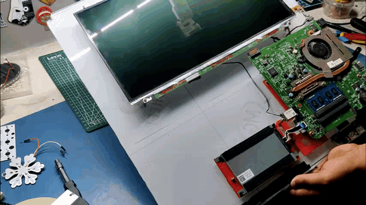

Step 11: Adding Display to Acrylic Sheet
We then use four 20mm-long M3 PCB standoffs to mount the display to the base acrylic sheet.
Step 12: Adding IO Extension Board
Next, we place the IO expansion board by using the same 20mm-long M3 PCB standoffs.
Step 13: Adding Speakers
  • Using double-sided tape, we attach two speakers—one left and one right—to the PC's bottom side. We will later connect the speakers' wires to the motherboard.

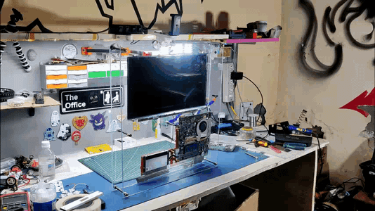

Step 14: Motherboard Placement
  • The motherboard is then set into position by first connecting it to all of the FPC connectors, including the Display Port, Charging Port, ON-OFF switchboard, Hard Disk FPC cable, speaker, IO Extension Board, and WiFi module.
  • Through the PCB Standoffs, we attach the motherboard to the motherboard holder using M3 bolts.

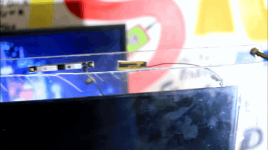

Step 15: Adding Front Acrylic Panel
  • After placing all the electronics, we add the front acrylic sheet by using six M5 Bolts and nuts.

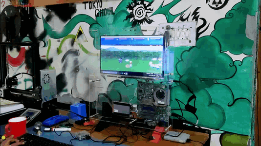

Step 17: Result So Far

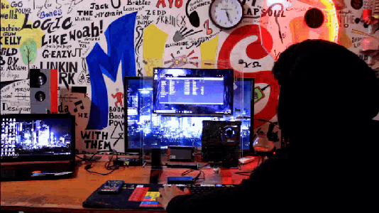

Here is the end result of the Built Process: a transparent PC with a cool, futuristic appearance.
The entire computer is transparent, allowing us to see the hard drive, motherboard, and other parts like the IO expansion board.

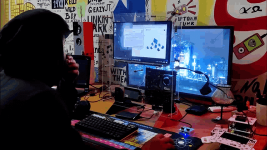

Step 18: Testing the PC

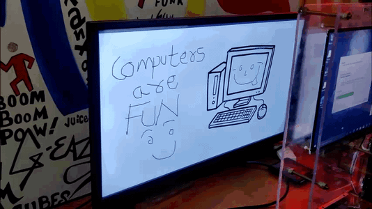

I'm going to be completely honest here: This PC stinks.
This computer is only capable of opening files and running a few Chrome tabs.
This computer's cheap motherboard and its extremely underpowered processor, which is incapable of performing any meaningful work, are both its best and worst features.
For testing this PC, I ran a few 1080p YouTube videos, and they loaded without any issues. The speakers work, and the online browsing experience was mostly average.
Using this computer is similar to using a terribly slow computer from five years ago; it works, but that's about it.
This PC's pros was that I tried to run the PPSSPP emulator to try to emulate old PSP games, and they ran smoothly.

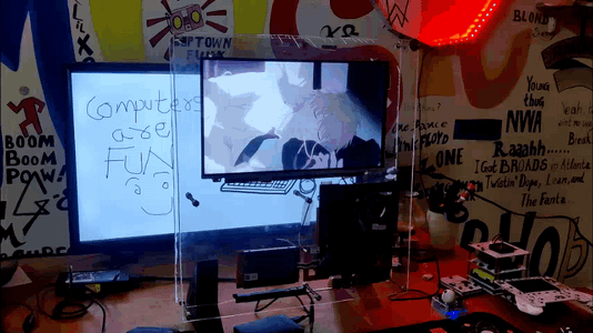

Step 19: Running Games
I installed a 2005 game called LF2 or Little Fighter 2, which I used to play a lot when I was 10 years old.
It's a nice thing that this machine can run this game smoothly. I tried using other software, like the PPSSPP emulator and the PS2 emulator, both of which worked, but they didn't simply run enough to play any games adequately.
