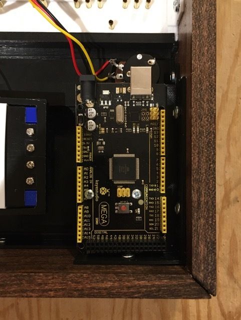

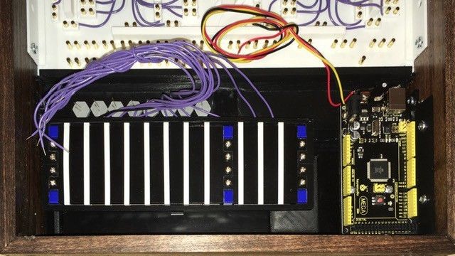

- 1 - Arduino Mega 2560 - Used to implement the clock and switch funtionality.

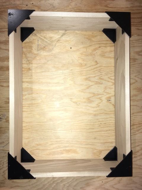

- 6 feet - 1/2" x 3 1/4" board - For the frame.

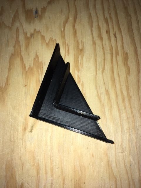

- 8 - Frame Construction Corner Brace (optional) - For aligning fame pieces while gluing.

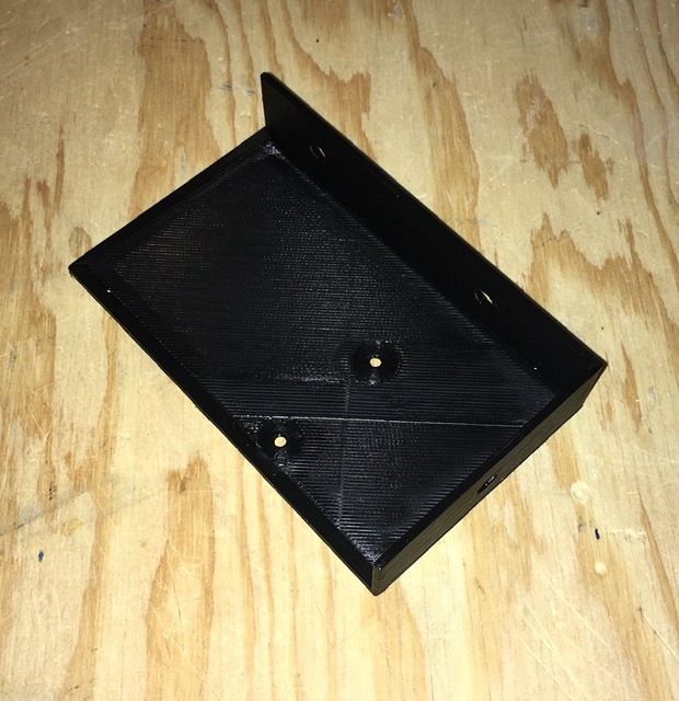

- 1 - Frame Mega 2560 Holder - Mount the Arduino Mega to the frame.

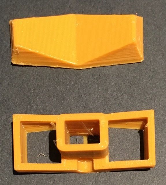

My starting point was an STL version of the PDP 8/I rocker switch that I found at Vince Slyngstad's PDP-8 Stuff page. I modified it slightly to have a hole at the pivot point instead of a shaft.

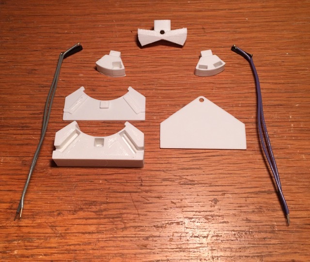

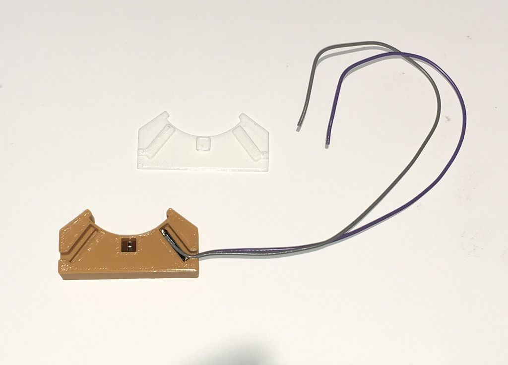

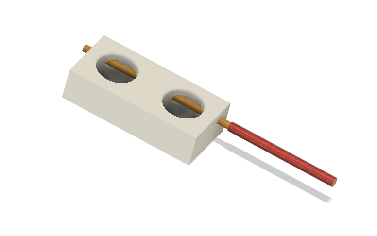

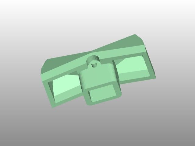

Then I modeled a "counter weight" to hold the switch magnets and a corresponding base for the "reciprocating" magnets and the reed switches. You will notice that there are two kinds of counter weights. That's because there are two kinds of rocker switches required, a momentary "spring" return for the three H-500 pulse switches, and an ON-ON variant for the eight input switches.

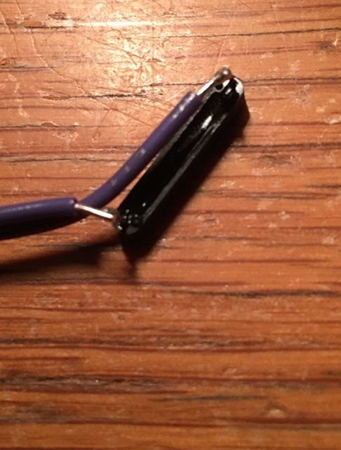

The base has slots and wire guides for each of two magnetic reed switches. The wires are soldered to the tips of the through hole pins.
Assembly of each switch is pretty straight forward. Insert the reed switches and magnets (making sure that the magnets in the rocker and the base are oriented to attract) then snap on the base end plate.
Note that the momentary contact and the ON-ON switches for this project only need one magnetic reed switch.

I took care and made sure that the magnets were all oriented the same way and used my 3D pen to secure them in place.

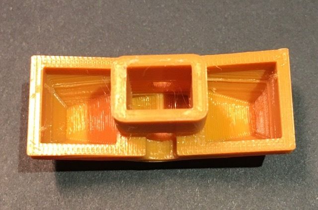

Next I made the eleven rocker switch bases. They are all the same as the one below. You will notice that there is only a single reed switch. I had already decided that I would use an Arduino to manage the clock and pulse signals (reading the clock rate, generating the clock signals, debouncing the pulse switches, etc., more on this later in the project) so I thought I would take advantage and generate the input switch signals based on a single reed per switch knocking about $20 off the BOM.

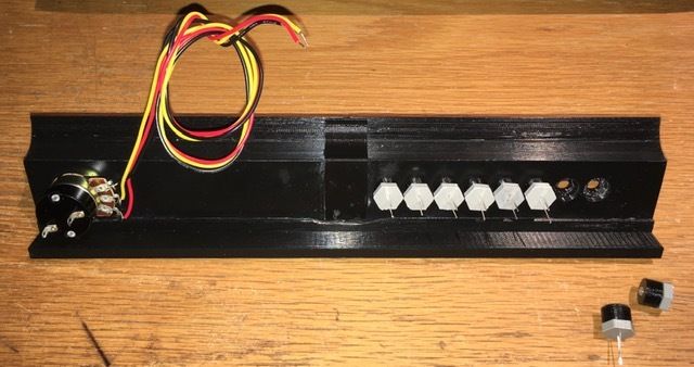

This piece separates the Switch Panel from the Patch Panel, holds the eight output lamps and the fine tuning knob for the clock speed, and also transitions from the higher Switch level to the lower Patch level within the wooden frame.

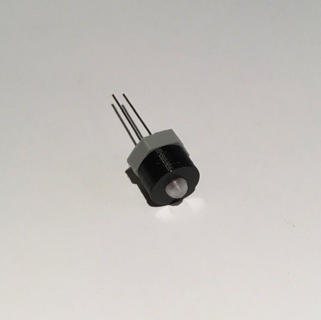

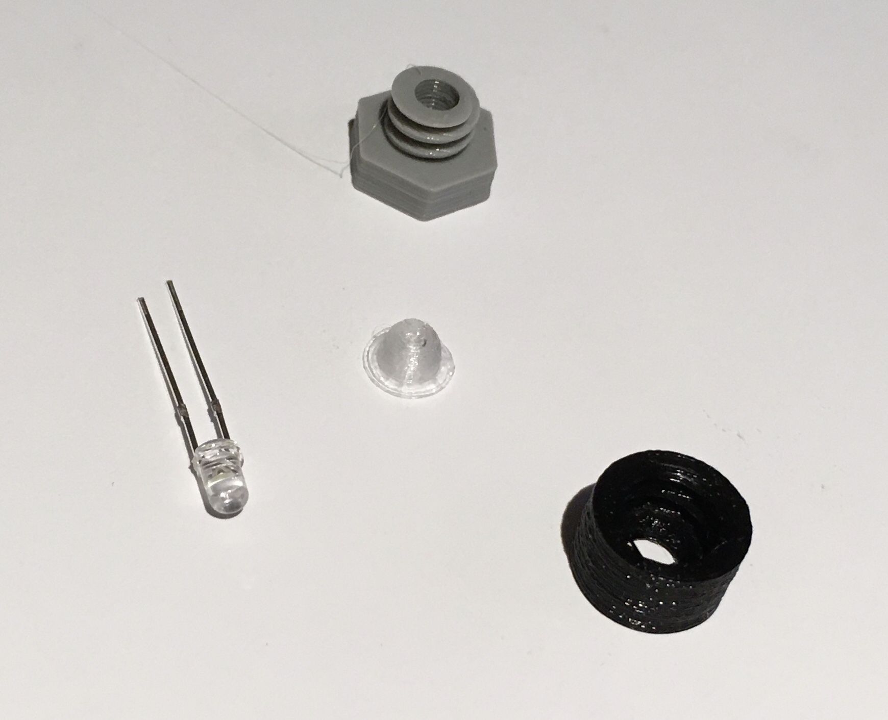

Making a Lamp

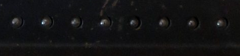

It's impossible to know from just pictures what kind of bulbs they used in the original, but if I had to guess based on the estimated size (about 4 mm) I would say grain of wheat bulbs. I could have ordered some but given the current lead times for delivery of non-essential items I decided to go with what I had on hand, LEDs. I modified my Panel Mounted LED Socket by adding a 4 mm printed diffuser printed with transparent filament which ends looking white with a slight blue tinge.
If you are looking for a more authentic incandescent look you could print the diffuser with yellow or light brown filament. As an experiment I tried the brown filament that I used for the rocker switches and it looked really good. You might have to reduce the suggested limiting resistor to get the luminescence right. If I hadn't already installed and wired the Light Panel I would have switched to the brown diffuser.
When put together it looks like this.
Assemble the Light Panel

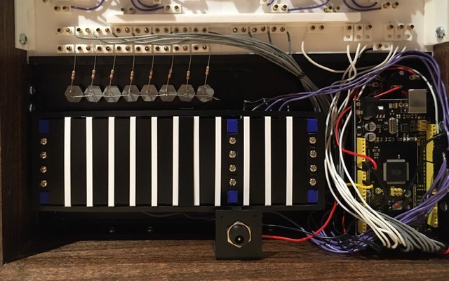

Make eight lamps. These bulb assemblies were slotted into holes on the back of the Light Panel. The panel itself was printed in two pieces and glued together with the aid of a reinforcing strip. There is also a front piece that is glued on once the two pieces have cured. You can see the clock fine adjustment potentiometer mounted on the back as well.

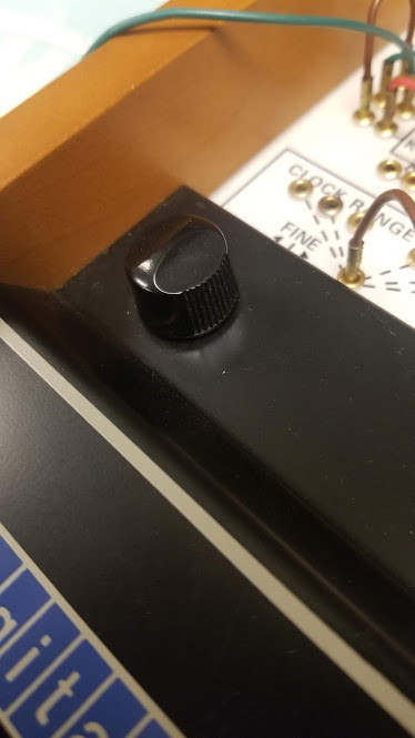

From the front here is the fine tuning knob that I modeled...
... based on the original.
The "bulbs" ended up looking pretty good. I found that I will had to add a 4K limiting resister to each LED to get the brightness down to incandescent levels.
The Light Panel is ready to go.

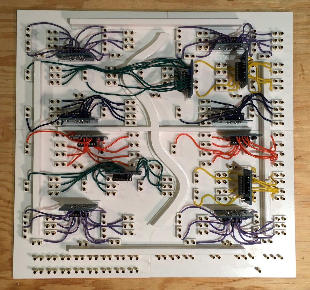

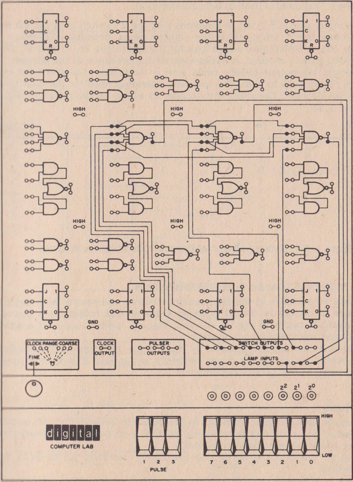

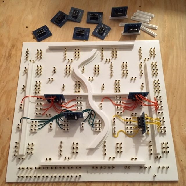

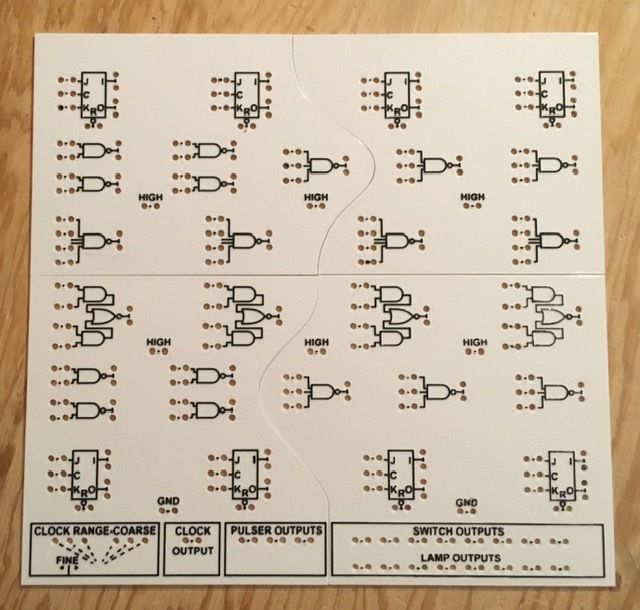

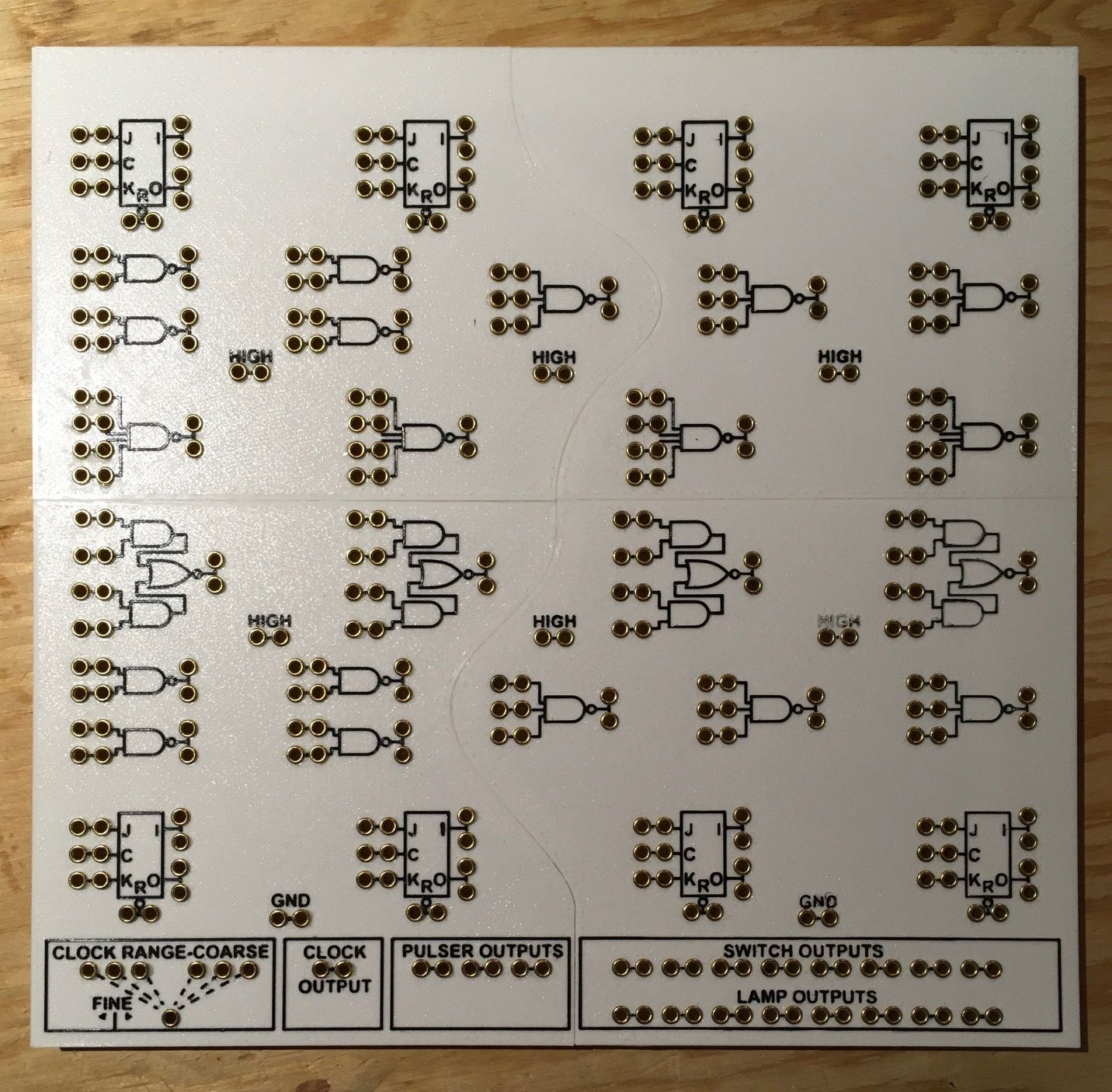

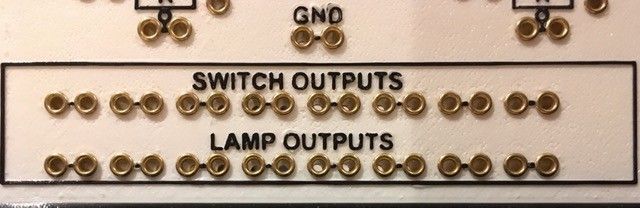

The Patch Panel is where the user creates logic circuits by connecting the "components" displayed on the surface with wire patch cables of various lengths. Patch cables are terminated with 2 mm banana plugs that connect to the Patch Panel's components via brass rivets.

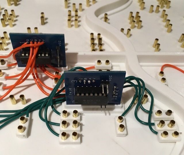

Assemble the Patch Panel

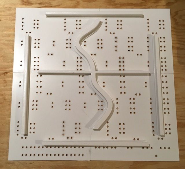

The Patch Panel was printed in multiple parts to accommodate my print bed, and the text is slightly larger than original to work at 3D printer resolutions, but a pretty good result I think.

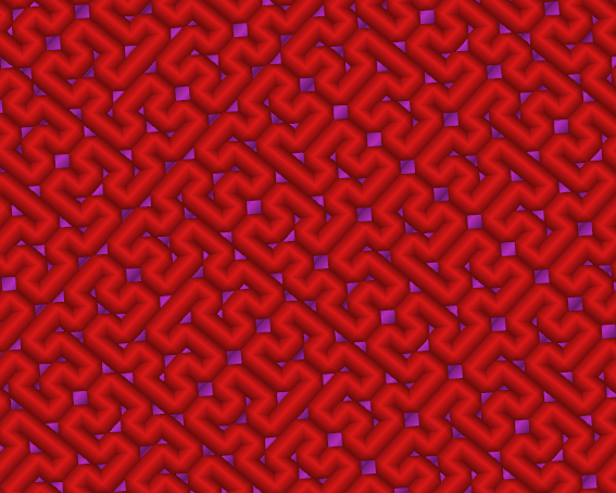

My big "discovery" for these panels was the "Hilbert Curve" option for the top layer.
I was unaware of this PrusaSlicer feature until now, and would certainly have used it in some of my other projects had I known about it (Minivac 601 and Digi-Comp II for sure). It produces a beautiful even matte finish unlike the somewhat "streaky" result I see with the default Rectilinear option. The downside is that Hilbert is quite a bit slower. It added an extra forty minutes or so to each of the four panels I printed. Totally worth it in my books.
I glued the four panel pieces together. Since the Patch Panel itself needs to be pretty rigid to support the insertion and removal of the patch cables, I designed and printed some support beams and glued them to the underside.

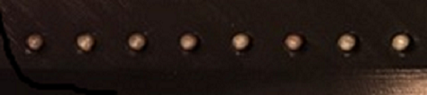

Then it's just a simple matter of installing the rivets onto this panel. By my count, there are 335 "terminals" that patch cords can be plugged into. These rivets are Rolled Flange Head Eyelets sourced from a local supplier.
I had done a number of test to try to get the perfect hole size so that the rivets could be just pushed in with a nice friction fit. Unfortunately halfway through printing the panels I made a small adjustment to my first layer height. So in the end the two right panels worked as expected, but the ones on the left were a little loose fitting. Not to worry this will be fixed in the next step.
Step 5: Wire the Patch Panel Logic Elements
Overview

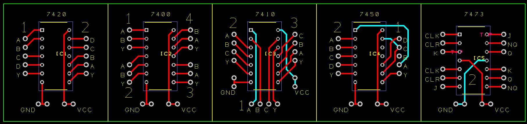

Circuits represented by logic symbols on the top of the Patch Panel are implemented with a dozen 7400 series ICs underneath. By looking at the logic symbols and using pictures of the wiring from the original H-500 I was able to determine the chips used:
- SN7400 - 2 Quadruple 2-Input Positive-NAND Gates
- SN7410 - 2 Triple 3-Input Positive-NAND Gates
- SN7420 - 2 Dual 4-Input Positive-NAND Gates
- SN7450 - 2 Dual AND-OR-Invert Gates
- SN7473 - 4 Dual J-K Flip-Flops with Clear
As can be seen above, for the original H-500 wiring was accomplished with a large PCB. The ICs were "surface mounted" directly to the PCB (pretty cool actually) and the rivets soldered directly to the board as well. Such a large PCB would be prohibitively expensive so I went in a different direction.
My Implementation
Part way through the wiring this is what my Patch Panel looked like:
There's a few things to note here. First of all I decided to make my life a little easier by creating some breakout boards for the 74XX chips. My initial though was to just "dead-bug" the chips and solder the leads directly to the pins. It would have worked but the appeal of re-arranging the pin-outs to be more consistent with the layout of the panel, plus having a label on each pin won out. Here's the PCB (you will need 4 of these):
printed as one piece to save money and cut into individual pieces with a Dremel. I created a small base for the PCBs so that I could stand them upright since there was no room to lay them out.
My plan was to solder the wires coming from the break-out boards directly to the brass rivets. It turned out that this was a lot harder than I thought it would be. I really should have tested this much earlier in the process. I don't know if the brass was coated with something but the soldering iron had to be applied to the rivets way too long to get a good join. As a result the panel holes melted and got too large to hold the rivet securely in place. I needed a plan B.
They say the necessity is the mother of invention, and I think the solution I came up with is actually better than if the soldering had worked. I made some mechanical "fittings" to securely attach the wires to the rivets:
Just insert the wire into the horizontal hole and slide the fitting over a pair of rivets representing a circuit lead. These work great, are quick and easy to install, and actually reinforce the rivet's attachment to the panel. An additional benefit is that a whole PCB "circuit" can be removed from the panel should the need arise to troubleshoot. Here's a closer look.
So with the bugs ironed out, I finished the Patch Panel wiring.
And here you go. All the logic elements are now wired except for power which I'll run when I put all of the pieces together. Next I'll knock together a frame to mount everything in.
Step 6: Build the Frame
If I had access to my local maker-space (kwartzlab) I probably would have ripped something down to the required 1/2" x 3 1/4" board size that I needed, but I was "lucky" enough to find some "craft board" at Lowes in the required size.
The other maker-space thing that I missed was access to their fine selection of corner clamps to put the frame together, so I had to improvise. I ended up printing some corner guides that worked quite well.

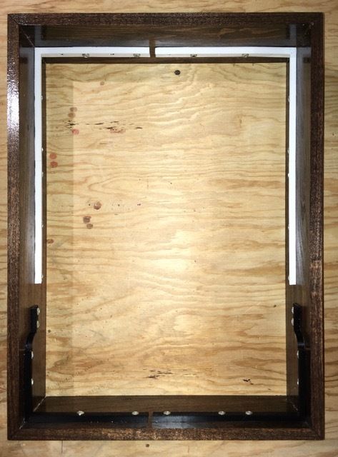

I mitered the corners of the frame and used the guides to align the boards while I glued and popped in a few brads. The inside dimensions of the frame are 292 mm (width) x 419 mm (height).
Once the glue was set I stained the boards then applied a few applications of clear coat. I was a little disappointed in the stain as I was expecting it to be a little lighter and redder like the original's "simulated teak". But given how long it took to get the stain I went ahead and used it.
I printed some supports to hold the Patch, Light, and Switch Panels in place at their appropriate depths (1/2" for the Switch Panel and 1 3/4" for the Patch Panel) within the frame and attached them to the inside faces with 1/2" wood screws.
I attached the panels onto the frame supports with some E6000 Adhesive.
Finally I printed a mount for the Arduino Mega...
...and installed it in the corner of the frame underneath the potentiometer.

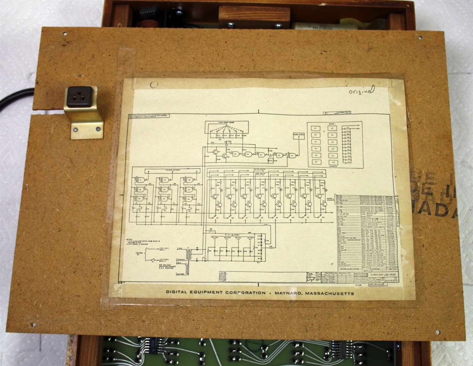

So how were these functions implemented back in the late 60's. Like this:
With discrete components as depicted in this schematic! Suffice it to say that the complexity of implementing this circuit goes counter to two of my primary design goals with this project: make it easy to reproduce and not too expensive.
Fortunately I do know what the circuit is supposed to do. So what would be an easy and cheap replacement, understood by today's community of makers, well an Arduino of course. This is what I came up with:
- Rocker and Pulser Switches - The magnetic reeds of the rocker and pulse switches are monitored by eleven inputs that are set with their pull-ups enabled. When the normally open reed switch is "activated" by a magnet its input line will be pulled down. The Arduino sketch monitors changes to the reed switches and will only change the state of it's corresponding output line once the switch has been suitably debounced (three consecutive reads 20 milliseconds apart with the same state). In this implementation all switches are debounced, not just the pulsers. We are already at 22 I/O lines so it's a good thing that the Arduino I had lying around was a MEGA 2560.

Do the Wiring
The first thing that I noticed when I started the wiring was that the switch assembly wires (purple) and the light panel LEDs (grey hexes) were overlapping, making my life harder than it had to be.
So I removed the switch assembly and rebuilt it, moving the eight brown rocker switch wires to the bottom of the assembly (the pulse switches were OK). There is a nice channel on that side to run the wires between the frame and the assembly itself. Following wiring diagram above it was pretty clear sailing and here is the result:
For reference the wire colors are:
- purple - switch inputs to Arduinogrey - switch outputs from Arduino
- white - clock out and clock delay control from and to Arduino
- yellow - potentiometer input to Arduino
- red - power +, 9V to Arduino, 5V from Arduino
- black - ground
The LEDs are wired directly to the lamp inputs with a 4K limiting resistor (large enough to keep the brightness down to incandescent levels). While wiring the LEDs I noticed a pretty big goof on my part. The label for the lamp terminals should have read LAMP INPUTS. Doh!
Oh well nothing to do about it now. I have updated the Patch Panel STL file but will live with my error on this build.
Step 8: Wire the Upper Half
Running power to the breakout boards was relatively straight forward. Each PCB has a 2-pin header for both VCC and GND.
Starting from the 5V and ground outputs on the Arduino, I made cables "to length" with single female header ends, and used these to "daisy chain" the power and ground from one PCB to the next until all twelve were connected. Occasionally a power or ground cable was tapped off of these to power the HIGH and GND terminals.
Wiring Complete!

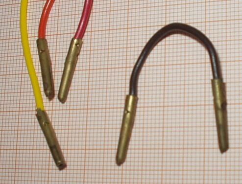

Step 9: Make Some Patch Cables
I found some relatively inexpensive 2 mm banana plugs at about 56 cents CDN each. The wire insulation is silicon based and very flexible. The cables are colored coded by length and are based on the original H-500's except black was substituted for brown and there are no orange cables. Here is what the original cables looked like (from http://www.so-much-stuff.com/pdp8/computerlab/computerlab.php):
And here are the plugs that were used.
As I stated before the 2 mm banana plugs I'm using work great with the rivets so I'm fine with them for now.
Starting with 50 cables.
