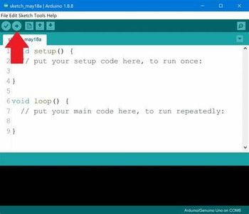

Now, just open up Arduino IDE, open up a new sketch with CTRL+N hotkey, or the new file button at the top left corner of the window.
Paste the code into the window, and select your board and port. In this case, we use the Arduino Nano, but this will work with just about any Arduino available.
Use CTRL+U or the upload button to compile and upload the code to your board. If there are no errors, and you see "Upload Successful" then you are done here! If not, check out the troubleshooting steps found below.
