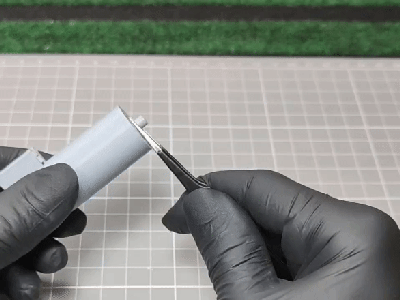

Step 4: Soldering the Wire on the Switch
Solder two wires to the limit switch, attaching them to the common and normally closed positions.
Step 5: Attaching Switch in Outer Shaft
Glide the limit switch into the housing of the outer printed shaft to secure it, ensuring it presses when the internal shaft passes through it from the top.
Sorry for not demonstrating the wires, assume it is for some steps!
