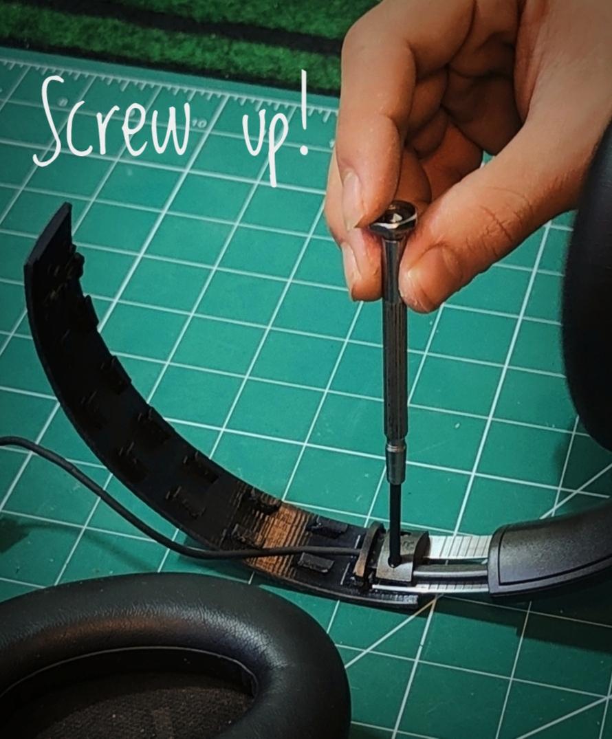

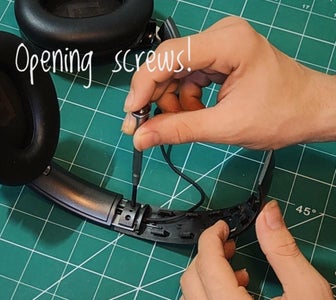

Step 2: Opening the Headphones
Carefully open the headphones to access the broken part. Take note of how the part is designed and how it fits within the headphone structure
.The process of opening the headphones differs with each brand make sure you check the manufacturer's guide for opening.

Step 14: Assembly
Once satisfied with the printed part, assemble it into your headphones as a replacement for the old, broken part.
Steps for assembly :
  • Fit the printed headband with the ear cup by aligning them correctly.
  • Secure the connection with screws to ensure stability.
  • Repeat the process for the other side.
  • Connect the cushioning below by snapping it into place through the connectors on the headband.
  • Finally, attach the end caps to both ends of the headband to complete the assembly.
Here steps are only for reference, Assemble all the parts as you opened them in step 3.

You can see it's the top shiny part that's 3D printed, looks amazing yeah! and I think that's more durable than what the manufacturer provided. Sorry for the lamp! :)
