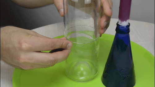

Bottle can be put on the cutter both ways. With the neck facing the slider or other way round.
Score the line and use your preferred technique to split the bottle in half.
I used candle and ice method.
Heat the line on a candle and cool it with ice.
Repeat the procedure until bottle splits in 2 pieces.
