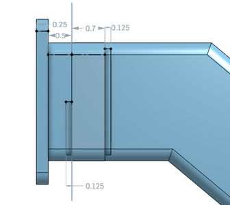

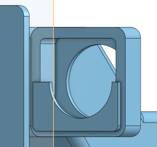

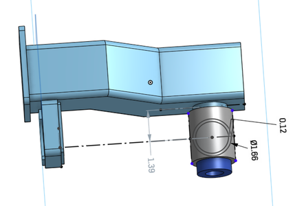

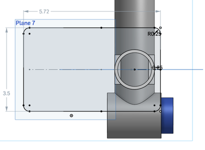

Step 1: Make the Main Body

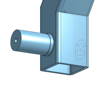

The main body is the heart of the unit. None of it moves in relation to anything else - just a very rigid, static foundation from which the moving parts operate. Please note: if it's a cylindrical object, it's shown in the drawing as a 2d representation - just a ultra thin cross section shown, and revolved around an axis to form the cylindrical object - I show the picture of it after it's revolution for clarification.
It consists of 7 or so parts -

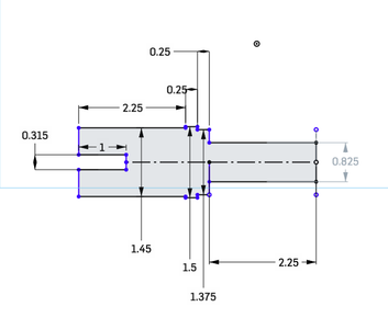

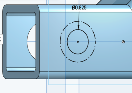

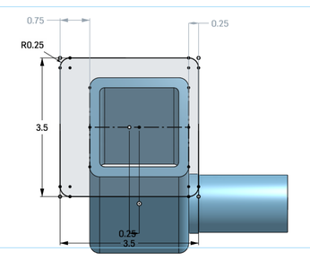

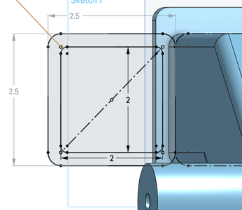

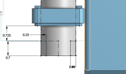

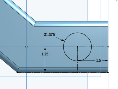

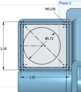

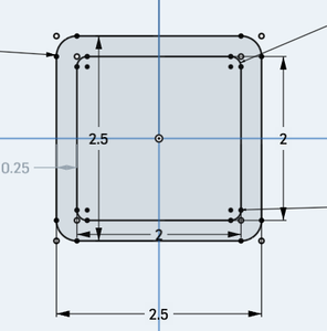

1) The main structure, which was 2.5" square tubing with a 1/4" wall thickness. I used about 12" of the material. You'll need to cut three pieces to make this. Please refer to the CAD design images and the video. It gets a hole drilled through it to accept part #3 of the main body.

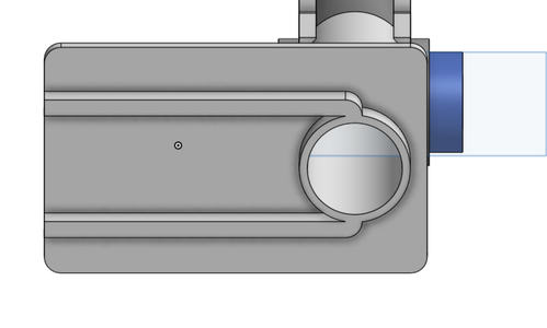

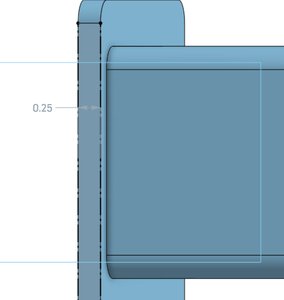

2) the face plate. This is what the tree will be pressed into. I used 1/4" flat stock to make it. It's a 3.5" square piece of metal that's welded to the face of part 1 of the main body. Also, I used .25" x .25" steel for traction teeth to grab onto the tree - this is welded directly to the face plate.

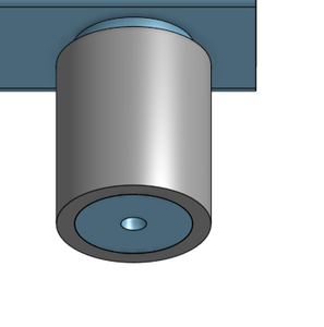

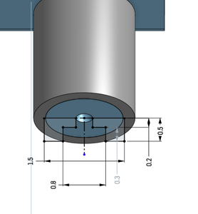

3) The handle axle. I made this out of 1.5" cold rolled solid steel round stock. You could use pipe as well. It just has to be very sturdy. This
4) The base that touches the ground. This part is super simple - I welded just some old pipe to the base, and this serves as a good "snowshoe" to keep the puller from just sinking into the dirt as you use it. I didn't include it in the drawing, it's that simple. Use anything that's wide, has some amount of surface area, and is rigid. It doesn't have to be very fancy.
5) The foot - This is to keep the head of the unit from digging into the dirt as you open and close the jaws. Again, nothing fancy. I just used some pipe and a small piece of 1" square tubing. Again this isn't in the drawing, as it's really simple and you can use anything you have laying around.
6) The compressor assembly guide. This is probably the most complex part of it, but you can use your imagination to make anything that accomplishes the same task. Mine was a .5" wide piece of 2.5" square tubing with two pieces 1/8" flat stock welded to it. I drilled holes into it for the compressor pipe to fit into.
7) Handle Stop. This is just a 5/8" round stock cut 1" long that's welded onto the main body (part #1). This limits the handle from traveling too far in it's rotation.

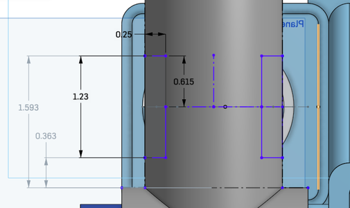

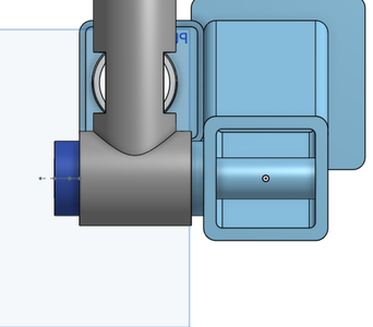

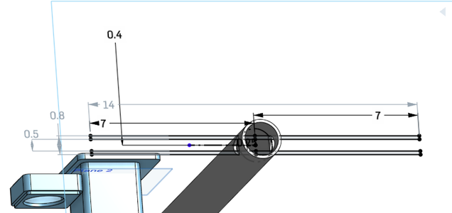

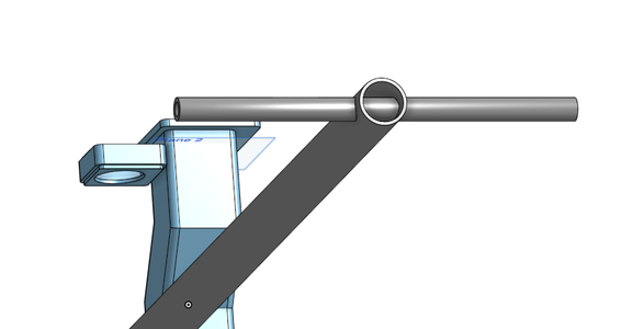

Step 2: Make the Handle
The handle consists of a few parts:

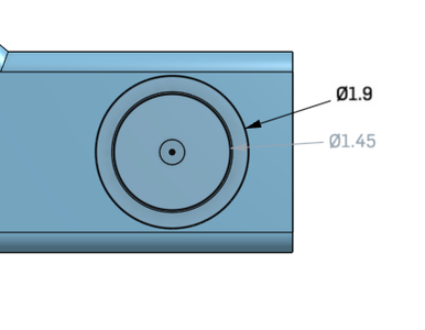

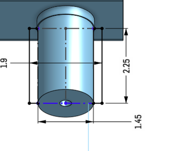

1) female bit of pipe that slides over the handle axle from the main body. I made the inside 1.45" in diameter, and 1.9" for an outside diameter. It's 2.5" long.

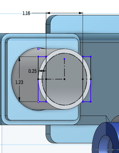

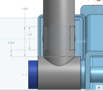

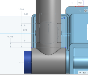

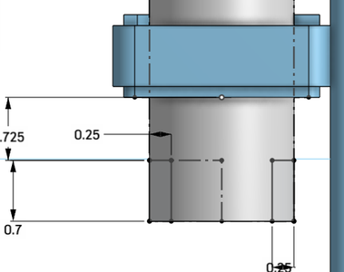

2) The long handle - it's 36" long, give or take, with a notch to accept part #1of the handle. Parts 1 and 2 of the handle are welded together. There's also a hole drilled 1" from the top for part #3. There are two notches cut near the base to accept the #4 parts of this step. I made them 1/4" deep, and 1.23" wide. This is so I could weld (securely) flat stock to something round. I used a mill to accomplish this step, but you could potentially use a cut off wheel, hacksaw, a file, etc to make these.
3) The handle's handle. This is just a bit of .5" plumbing pipe with an OD of .8" that goes through the top of the handle. It's about a foot long. This gets welded to part #2.

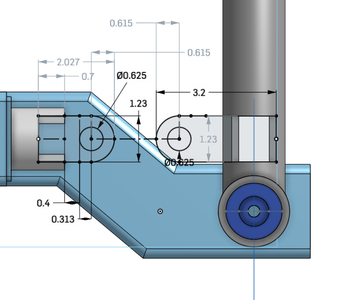

4) Linkage part plates. I made these out 1/4" flat stock with a whole drilled in each. I used 16mm (5/8") bolts to go between the handle and linkage part. As such, the holes to be drilled were 5/8" (.625), but in my case, .627" since i used 16mm bolts (it's what I had on hand). The drawing for these parts are in the next step.

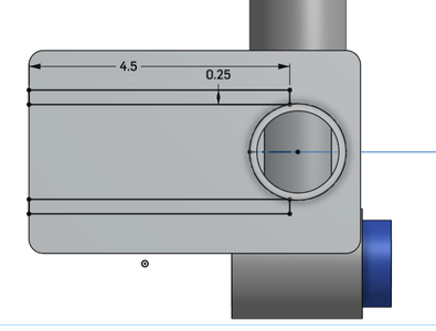

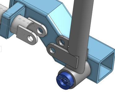

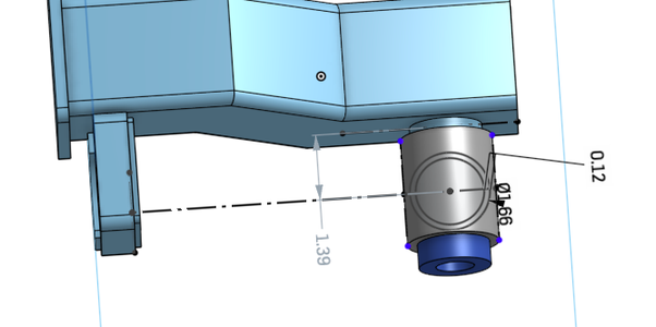

Step 3: Make the Compression Plate/tube/linkage Plates
There are three parts to this assembly.

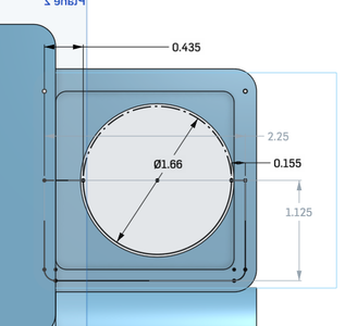

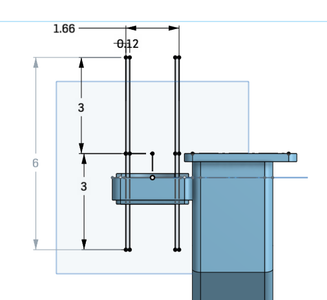

1) A piece of approximately 3.5" by 6" piece of 1/4" Flat stock. This gets a hole drilled into it to accept part #2 of this assembly. I used 1.66" pipe, so I put a 1.66" hole in it. Welded to it are some stiffening supports. This could be anyting, but I used some 1/4" weird shape laser cut trapezoidal things for this. I welded these supports both to the plate here and the pipe in part #2 of this assembly.
2) Pipe. I used a 6" long piece of pipe with an OD of 1.66" and a wall thickness of .12". This is an adequate size and shouldn't break. I would advise this be made out of anything that won't bend under the forces you're able to apply to it. It was really important for me to make this part indestructible since a lot of torque will be applied to it. There will be two notches, similar to the handle ground / machined out of it to accept some linkage plates (part 3 of this assembly).
3) Linkage plates. I made these out of 1/4" laser cut flat stock that I picked up from my supplier. They already had the half semicircle on the ends to avoid me having to do it. I drilled 5/8" holes in them, same as the step in part 2.

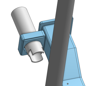

Remember!!!! This part will go through the Step 1's guide assembly. Once welded together, this will not come out - they're entrapped. It's meant to slide, but also won't come out. It's advisable to weld the linkage bar plates OR the compressor plate ONLY AFTER sliding it through the guide hole part of the main body. If you weld it as one unit, you won't be able to slide this entire assembly into the main body's guide.

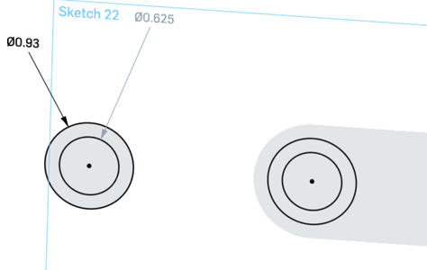

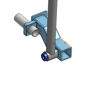

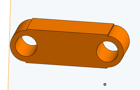

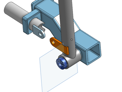

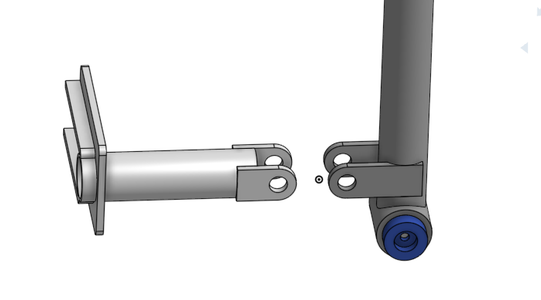

Step 4: Make Linkage Interface Between Handle and Compressor
This is comprised of three pieces total.

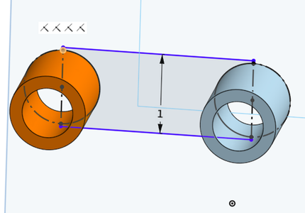

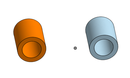

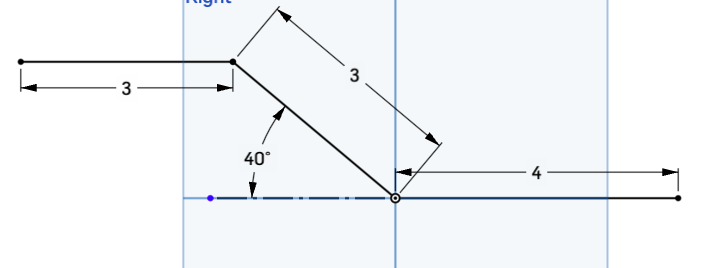

1) two pieces are identical, made out of some round stock I had. They're basically two sleeves for 16mm or 5/8" bolts to go through. I made mine approximately .93" O.D. with an I.D. of 16mm, and a width of 1.16". Yours will vary depending on what bolts you use. I wanted at least a .125" wall thickness of these little sleeves for easier welding and strength.
2) Piece of metal to attach the two sleeves of part 1 of this assembly. I used a 2-3" long piece of 1" square tubing with a .125" wall thickness. I notched both ends, and welded these to the sleeves. I intentionally left the length of this piece out of the drawings to enforce you to measure your own. In the video, I describe how to measure this length.
Be sure to make this piece really strong since it will bear all the force you apply to the handle. If you weight 200lbs, have a handle that's 36" long, you can apply a torque of 600 lb/ft acted linearly to this piece. That's a lot. Make sure your welds are top notch, good penetration enough filler, etc to withstand this force. It was this force that broke my first puller. I could have re-welded it, but then you wouldn't have had this instructable, would you?
