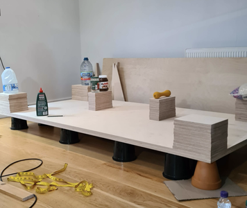

Step 2: Seat
No cutting required, stack 2 plywood sheets together by gluing them.
Step 3: Legs
Cut according to plan. I tried to fit all the leg pieces into one sheet of plywood, hence the varying width.
  • Front legs: 30.5cm
  • Back legs: 20.3cm
  • Middle legs: 10.2cm
Front and back legs align with each 4 corners of the seat. Back legs are placed in the middle with about 69cm(27') between them. Doesn't have to be exact, I didn't actually measure when placing them down.
Glue and screw the top piece of each leg into the seat first, then build the legs top to bottom. I did this to avoid screws being shown on the seating side of the plywood.
Stack and glue the rest of the legs.
Let dry and cure for 24 hours.
