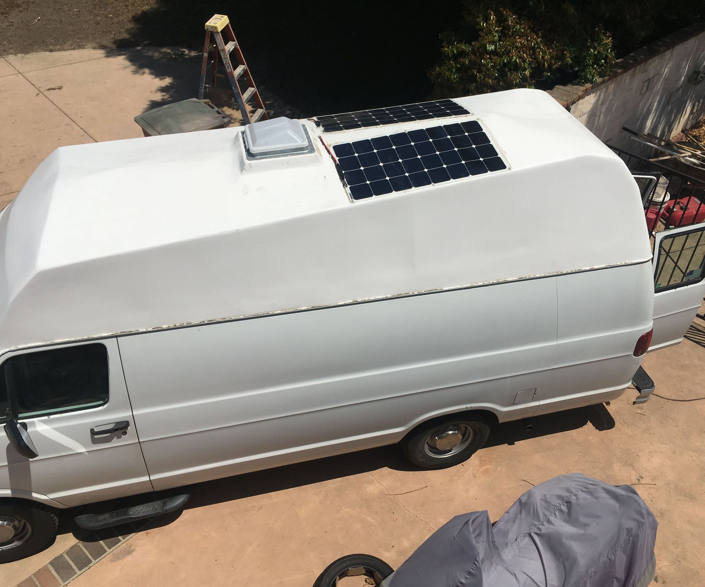

The Idea was to find a low-mileage large van and make it into a standing-height, high-ceiling a work vehicle. I couldn't see parting with 40-50K for a sprinter van, or similar. This could also work for a camper.
The van top that the local company sells is either too high or too low, and relatively heavy and $2500+. Combine that with it's 60 miles away, so I decided to make my own.
The idea was to make a frame, cover it with .22 plywood, anchor it the van with screws, fill the voids (rear corners) with spray foam, (red cans that cost about $3 at a hardware or building supply store,) coat this with laminating resin, fiberglass over the corners and edges of this structure first with 1-1/2oz fiberglass mat, then over the entire structure with 10 oz. fiberglass cloth. Once fiberglassed, a filler was made with laminating resin, mixed with a thickening powder, called Q-Cell, to make a filler and a surfacing agent, to allow it to sand easier. The top was then insulated with 1-1/2 foam sheets, which is sold at building supply stores in 4x8 sheets, then paneled on the inside.

The top weighs about what the top removed weighs. It has 8 sheets of .22 paneling, very light insulation, 4 or 5 20' sections of 1-1/2 .06 aluminum tubing, 5 -8' 2x2's and various fasteners. The weight of the fiberglass and resin could be 20 lbs....so with the interior is probably weights 120 lbs. The rest of the interior weighs more, maybe double.
The van gets 15 mpg + on the freeway, 12mpg around town....It's a 1996 Dodge Maxivan with a 5.2L engine.
This actually was a pleasant surprise.
It would be really excellent to make the doors taller too, but I want to use this more and work out any kinks.
This van is a 1996 Dodge Maxivan with 85,000 from the original owner and tons of maintenance paperwork, and it had a leaky, rusty roof. As a slightly wacko Idea, I would really like to make the top a removable boat, but that's another project, another day. I'm happy with this project and have decided to do a "Sprinter" type van but need to sell this first. 11/14/18 the van is for sale, Sold 11/30/18 to an adventurer who has been all over the world, and just cam back from Africa, I hope Amanda enjoys it, as it was a fun project.
