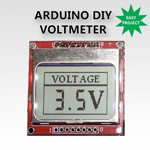

In this Instructable I am going to show you how to build a Voltmeter with a big Nokia 5110 LCD display using Arduino.
Building a Voltmeter is a great learning experience. When you finish building this project you will have a better understanding of how Voltmeters work, you will refresh your knowledge of Ohms law, and you are going to see in action how powerful the Arduino platform can be. With this project as a base and the experience gained, you will be able to easily build more complex projects in the future.
You can use this project to measure DC voltage from varius electronic circuits or monitor the battery state of your Arduino projects easily. Also, with the knowledge gained you can easily build your own voltage sensor to create your custom Voltmeter that fit your needs.

Step 2: The Voltage Sensor Module
Let’s see how this sensor module works. This voltage sensor is very simple and it can measure DC voltage from 0-25V.It consists of only two resistors! You can build your own easily if you wish, or you can buy this module sensor with less than a dollar if you want something already built. This is how it works. This sensor is actually a voltage divider. A voltage divider circuit is a very common circuit that takes a higher voltage and converts it to lower one by using a pair of resistors. The formula for calculating the output voltage is based on Ohms law. Please check the attached image.
In this module, the R1 is 30.000 Ohms, the R2 is 7500 Ohms. If we put 25V on the input, if we make the calculations, we get 5V at the output! I And that’s the maximum voltage an analog pin of Arduino can handle. So, if we exceed 25V at the input, we will burn the Analog pin of Arduino. If we put 0 volts in the input we get 0V at the output. So, if we put any voltage from 0-25V at the input we will get a voltage from 0-5V at the output.
The Arduino Uno has a 10bit ADC so the resolution that we can achieve using this sensor is 25mV. If we use an Arduino Due, we can achieve even better resolution since it has 12bit ADCs. But, of course, we need to build our own voltage sensor, because the Arduino Due board uses 3.3V logic levels, and any voltage beyond that will destroy its analog pin.

Step 4: Building the Voltmeter
Let's now connect all the parts together.
At first we connect the voltage sensor. It only has 3 pins. Of those, we only have to connect 2.
Connecting the Voltage Sensor
- Pin goes to Arduino's GND
+ Pin stays unconnected
S Pin goes to Analog Pin 0
The next step is to connect the Nokia 5110 LCD display.
Connecting the Nokia 5110 LCD Display
RST goes to Digital Pin 12 of the Arduino
CE goes to Digital Pin 11 of the Arduino
DC goes to Digital Pin 10 of the Arduino
DIN goes to Digital Pin 9 of the Arduino
CLK goes to Digital Pin 8 of the Arduino
VCC goes to Arduino 3.3V
LIGHT goes to Arduino GND (backlight on)
GND goes to Arduino GND
Now that we have connected all the parts together, all we have to do is to load the code. A Splash screen is displayed for a couple of seconds and then we can start measuring the voltage.

Step 6: Testing the Project
Now that the code is loaded we can test the Voltmeter with some batteries. I test it with a rechargable AA battery, a 18650 battery and a big 12V alarm battery.
As you can see in the attached photos, the Voltmeter works fine. For comparison I have also used my multimeter. Our "handmade" Voltmeter's reading are very close to the professional Multimeter's. Great isn't it?
