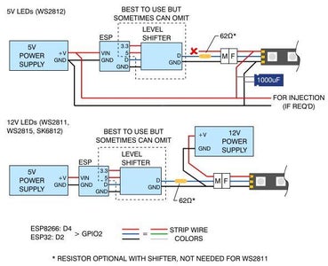

Step 4: Wiring Schematic and Final Connections
Follow the wiring schematic provided in this step and do all the wiring connections accordingly.
I recommend using flux core solder wire as it results in better clean solder joints.
I have used thin enameled copper wire for all the connections. It is my personal preference as it keeps the project wiring clean.

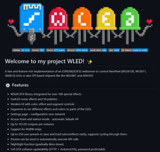

Step 7: WLED: Open Source Wireless LED Controller Software
WLED Github Page
WLED is a fast and feature-rich implementation of an ESP8266/ESP32 webserver to control NeoPixel (WS2812B, WS2811, SK6812) LEDs or also SPI based chipsets like the WS2801 and APA102!
Features:
  • WS2812FX library integrated for over 100 special effects
  • FastLED noise effects and 50 palettes
  • Modern UI with color, effect and segment controls
  • Segments to set different effects and colors to parts of the LEDs
  • Settings page - configuration over network
  • Access Point and station mode - automatic failsafe AP
  • Up to 10 LED outputs per instance
  • Support for RGBW strips
  • Up to 250 user presets to save and load colors/effects easily, supports cycling through them.
  • Presets can be used to automatically execute API calls
  • Nightlight function (gradually dims down)
  • Full OTA software updatability (HTTP + ArduinoOTA), password protectable
  • Configurable analog clock + support for the Cronixie kit by Diamex
  • Configurable Auto Brightness limit for safer operation
  • Filesystem-based config for easier backup of presets and settings

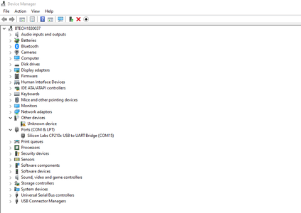

  • Driver Installation:
First, connect your NodeMCU to your computer using your USB A to USB Micro B cable.
Then, go to your device manager(START-> Search "Device Manager") and check for your COM port.
If there is no COM port then you need to install the proper driver for your microcontroller.
"I will not explain here on how to install drivers for your microcontroller. You can search on internet for the procedure."

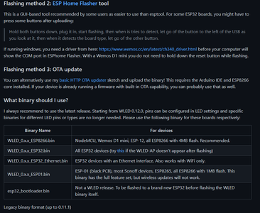

  • Download Binary(.bin) file:
Download the latest binary file from the Github page or link provided here: WLED Binary file.

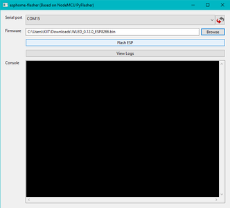

  • Download ESP Home Flasher Tool:
Download the latest executable file from the Github page or link provided here: ESP Home Flasher Tool.
  • Flashing the firmware:
Open your "ESP-HomeFlasher.exe" file and select your COM port. If not available press the refresh button. Then click on the browse button and select the ".bin" file.
Then, click on "Flash ESP" button to flash the firmware and wait for it's completion.
After completion just close the ESP-HomeFlasher tool but do not disconnect the NodeMCU from the computer.
**SEE ATTACHED PICTURES FOR BETTER UNDERSTANDING**
