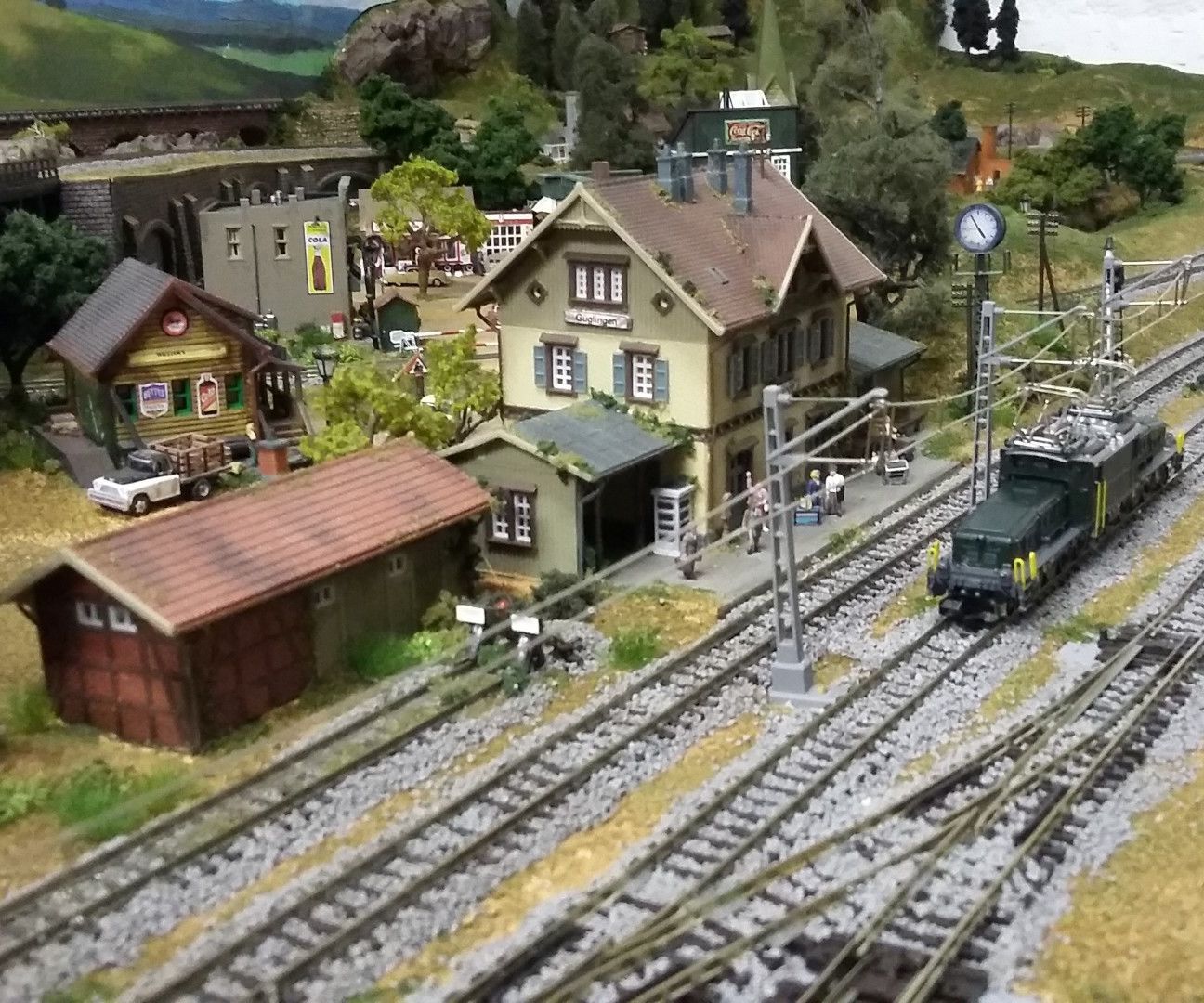

About: I live in South Africa. Married and son is 3 now. Work in the Retail Industry in IT. N Scale Model Trains is my past time hobby and passion. Fix and Service Locomotives and I have my own layout I'm busy buildi…
On my Model Train Layout I have some space that I allocated for a SawMill. I bought a plastic model kit from Walters that was going to live in the space, but I was never 100% convinced it is what I would like to do.
So I was cleaning and going through some old papers and magazines from my child hood and came across a SawMill plan I once built when I was still in school. (built it totally from paper).
My mind was going and then this project was born. Loads of research !!!! Loads of FUN !!!!!!!
