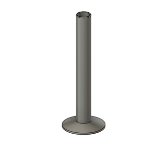

Step 3: Find a Suitable Rod
I found a wooden rod with a diameter of 25mm at home so I used that, but you can also either buy a suitable rod (also available at the hardware store) or 3D-print it. Cut it to roughly 20cm length.

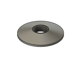

I used Fusion 360 to design a disc which holds the pole but if you don't have acces to a 3D-printer you can also just glue it onto the surface.
Step 4: Assemble
Assemble the lamp by taking the rod and connecting it to the printed disc. After doing that you can start sticking your LEDs onto the pole like shown in the picture. You can secure the Chip using some double sided tape.
