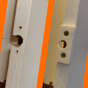

In this Instructable I will guide you through the process of how I repaired a door latch with a simple shape I designed using Fusion 360 and then 3D printed it.

  1. If you have a broken Part that you want to replace you would need to reconstruct it which can be a bit challenging if too much is broken.
  2. If you have another identical part you can recreate that one which is probably the easiest to do.
  3. If you have nothing of the original Part or there was never a part with that specific purpose you would need to find your own solution which, depending on your situation, can be pretty complex but most of the time isn't too complicated.
Step 2: Taking the Required Dimensions and Sketching the Piece
  1. Take clear photos of the broken part: Use a camera or your smartphone to take multiple pictures of the broken part from different angles. Try to capture the entire part in each photo and make sure the images are clear and in focus.
  2. Use a ruler or caliper: Measure the broken part using a ruler or caliper. Measure the length, width, height, and any other dimensions that are necessary to create an accurate 3D model. Take note of the units of measurement (e.g. millimeters or inches).
  3. Sketch the broken part: Use a pen and paper to sketch the broken part, including all the measurements you just took. This will help you visualize the part and ensure you have captured all the necessary details.
