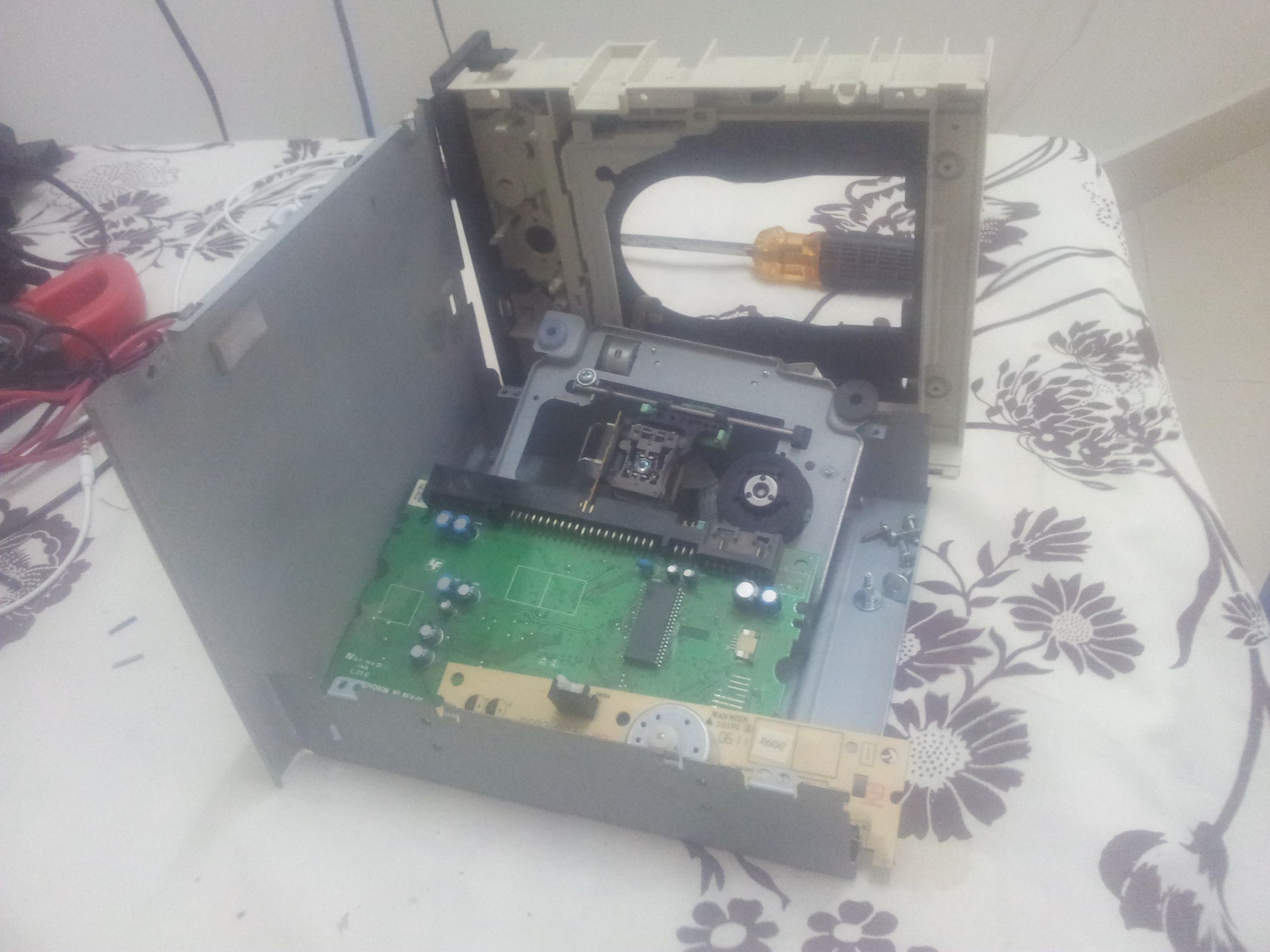

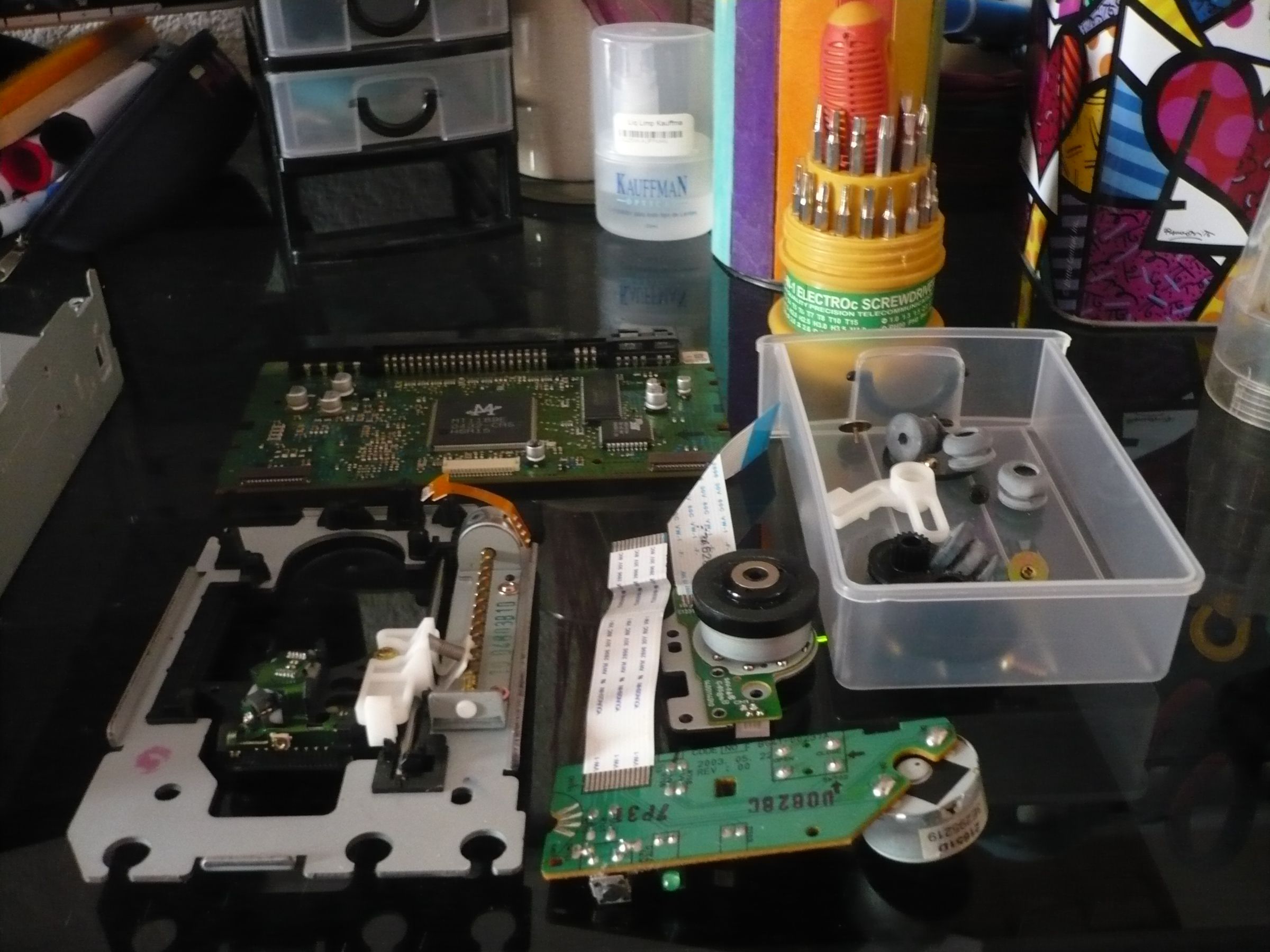

Step 3: Starting the Surgery
The first thing to do is to loose the four screws under the driver, after that you can pull the cover.
Step 4: Retiring the Other Part of the Metal Case.
Now on the sides of the press the marked parts on the images and pull
the front of the driver, after that finish taking off the metal cover.
Step 5: Retiring the Electronic Board
I don't use the electronic board, but it is standing in the way of our progress, see the images to know how to take it.
I recommend that you put these parts that don't have much value for us in a box/bag for discarding correctly later.
Step 6: The Tray Motor Board
In the images, you can see how to take off the tray mechanism, there are some things that can bee used here.
You will need knowledge in desoldering to retrieve the parts from the board.

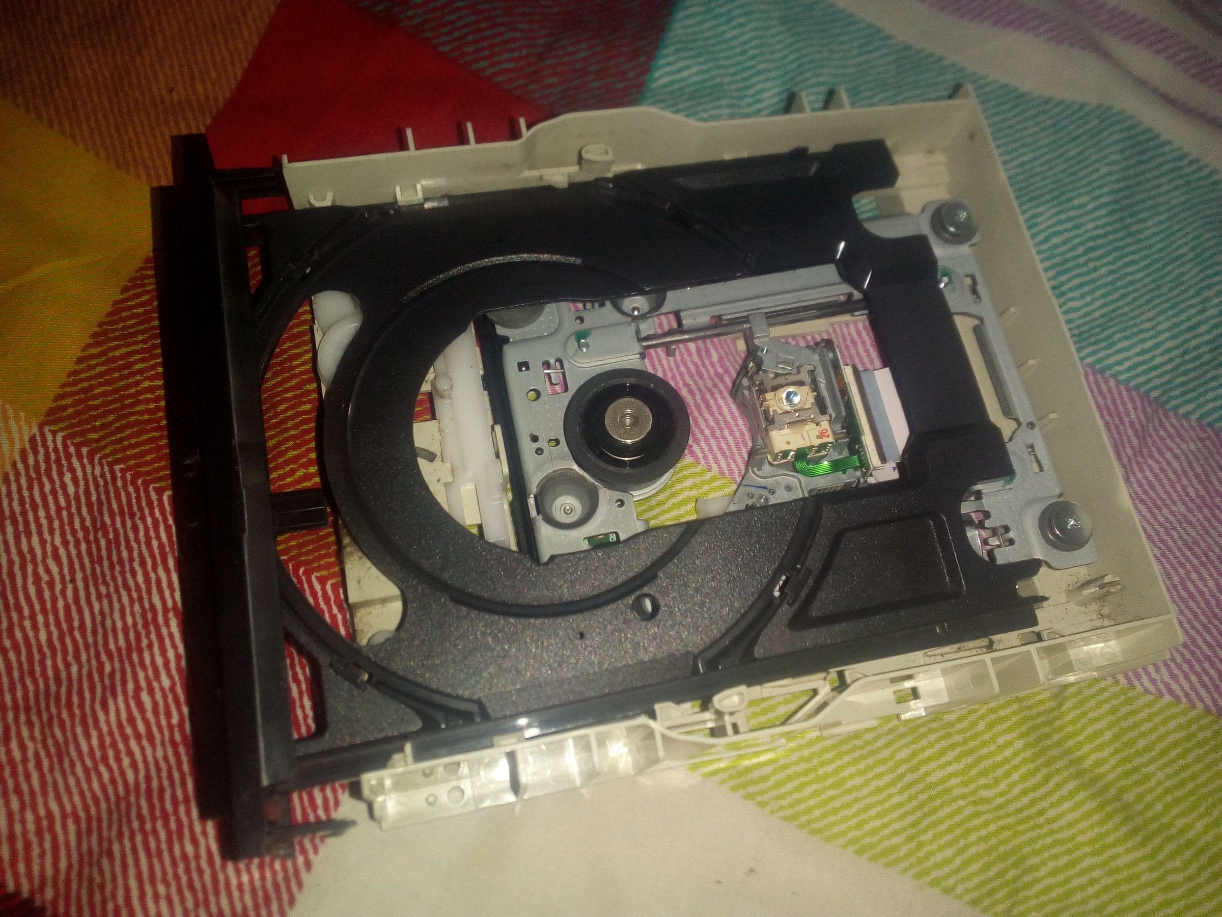

Step 7: The Tray Mechanism
Here, there are some gears that you can use with the motor from the step before.
What you can make with this parts depends of your creativity, you can make a reduction to a robot or something like that, I using some these in one of my projects, You will see it in Instructables in some time.
Step 8: That Thing That I Don't Know the Name.
Yep, I don't know if this thing has a name.
Let's call it 'Laser movementing mechanism', ok?

Step 9: The Brushless Motor.
The motor used to spin the CD or DVD is a brushless motor, that means that you can't simply connect two wires in a battery and it will spin, for that, you will need a Electronic Speed Controller (ESC) and maybe some mods , following are some instructables with motors like this.

Step 10: The Stepper
The motor used to movement the laser is a stepper motor, stepper motors are very good to positioning, the signal sent to the motor makes it move to a determined position.
The stepper motor in these drivers is bipolar, and have to be used with H bridges , I use the L239D chip, a dual H bridge to drive them.

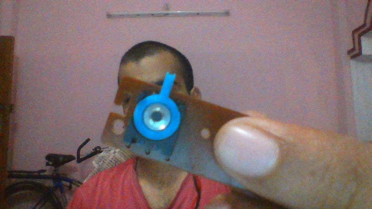

Question 4 years ago
ive opened a dead dvd player and found most of the parts that you found.
however I don't know the name of this one thing that looks like a lever, acts like a springy lever which returns to the center if toggled to any side. but its small and made of plastic. it disengages the tracking mechanism from the loading/transport tray when the drive opens up.
its soldered onto a pcb with three pins as inputs.
what is it?
Answer 1 year ago
i think it's a switch
