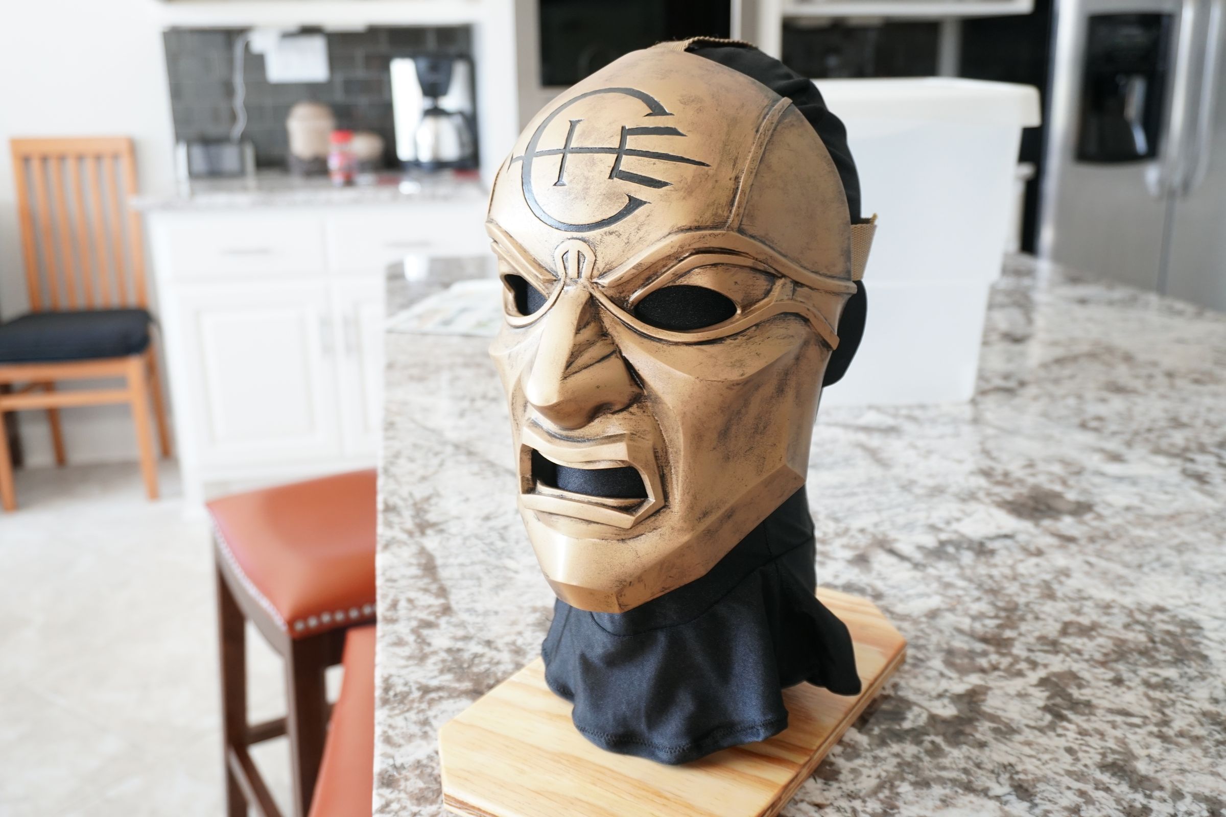

Introduction: Dishonored Overseer Mask, 3D Printed
Hello! I'm going to teach you how to build the Overseer mask from Dishonored. The video above is the main instructions but below I will include materials needed to complete the full Overseer Mask.
Step 1: Materials for Making the Mask (Sanding and Painting)
People often ask me where they can go to print and here's some options for you:
- personal printer (or friends printer)
- school/university
- Maker Space (including the different varieties of those type of shops)
- online (people will do this service for you and ship it to you, fees different from person to person)
- Tip ~ If the size of the project is too big, use a slicer to fit your printer bed
You will need:
- Sand paper (different grits of course, I list some of my favorite types in the video. Start somewhere around 100-200 and finish however high you'd like, I finished it at ~360)
- Denatured Alcohol (to clean before spray painting)
- Primer spray paint (I have two above that I alternated with)
- (Optional) XTC-3D (fill in any small holes)
- Black spray paint (your choice, I used two kinds)
- Gloves (protect your hands)
- Gold spray paint
- Acrylic paint (need black only)
- Satin clear enamel
Step 2: Materials for the Straps
You will need:
- Kevlar (any material works for straps, but some might not hold spray paint)
- Velcro
- 5 Minute Apoxy (additional things for attaching straps):
- Popcicle stick (stir)
- Paper plate (spreads the Apoxy out so it doesn't cure as fast)
- Foil (on plate, keeps it from soaking into the plate)
- Paper towel/ news paper under project
Step 3: Materials for the Spandex Hood
You will need:
- A party suit from Party City or online (get a large or if they have an extra large, get that)
- Scissors
- Access to a sewing machine or needle and thread
Step 4: Materials for the Stand
You will need:
- A Styrofoam head
- A wooden dowel
- A wood board (size to your liking)
- Any type of wood finish
Step 5: Become an Overseer
You're finished! Now you can patrol Lady Boyle's Party!
Thank you! Have fun too!
