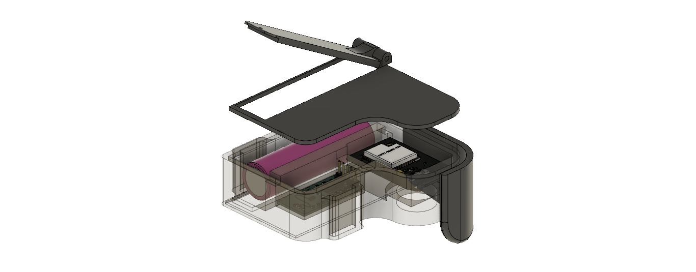

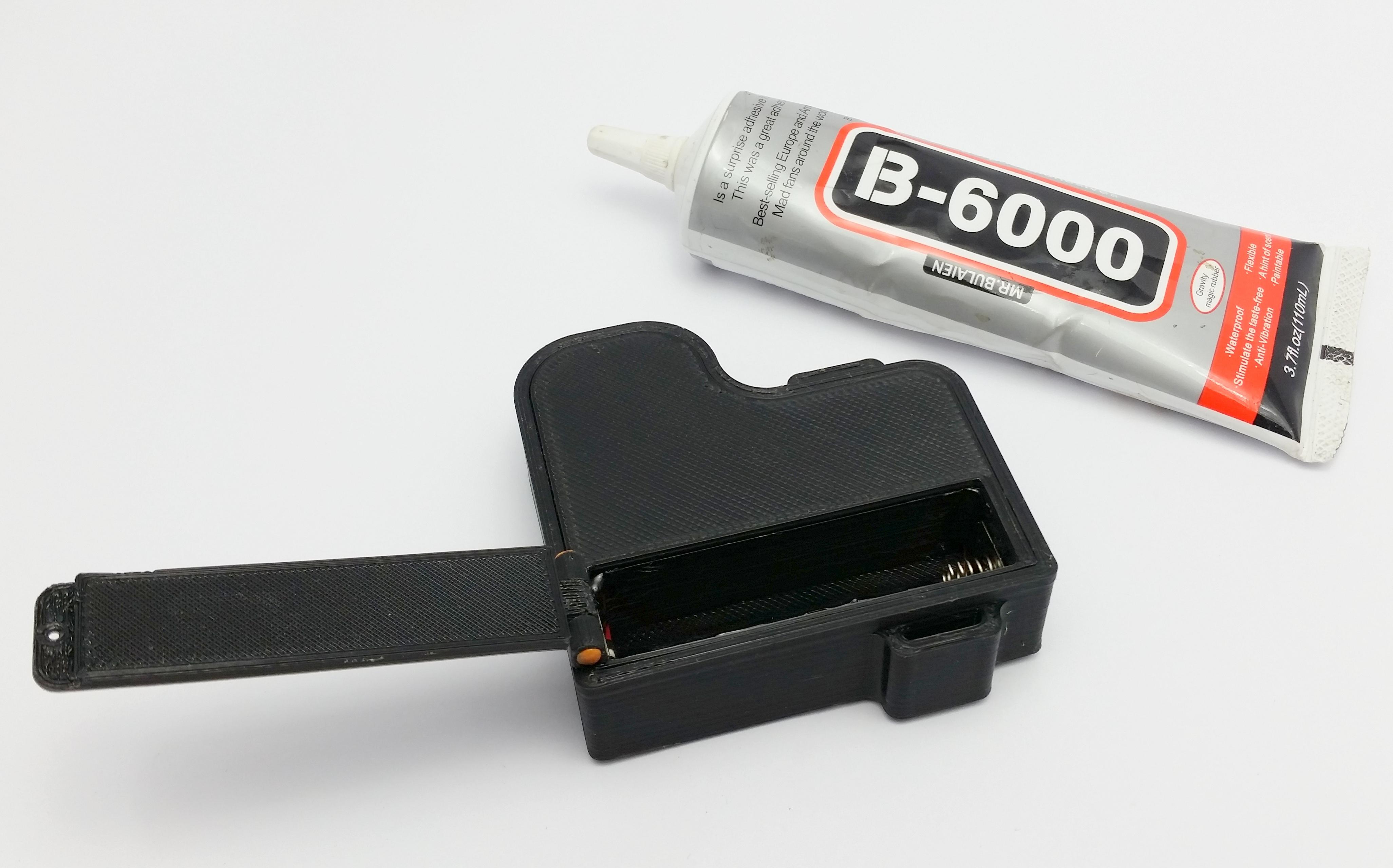

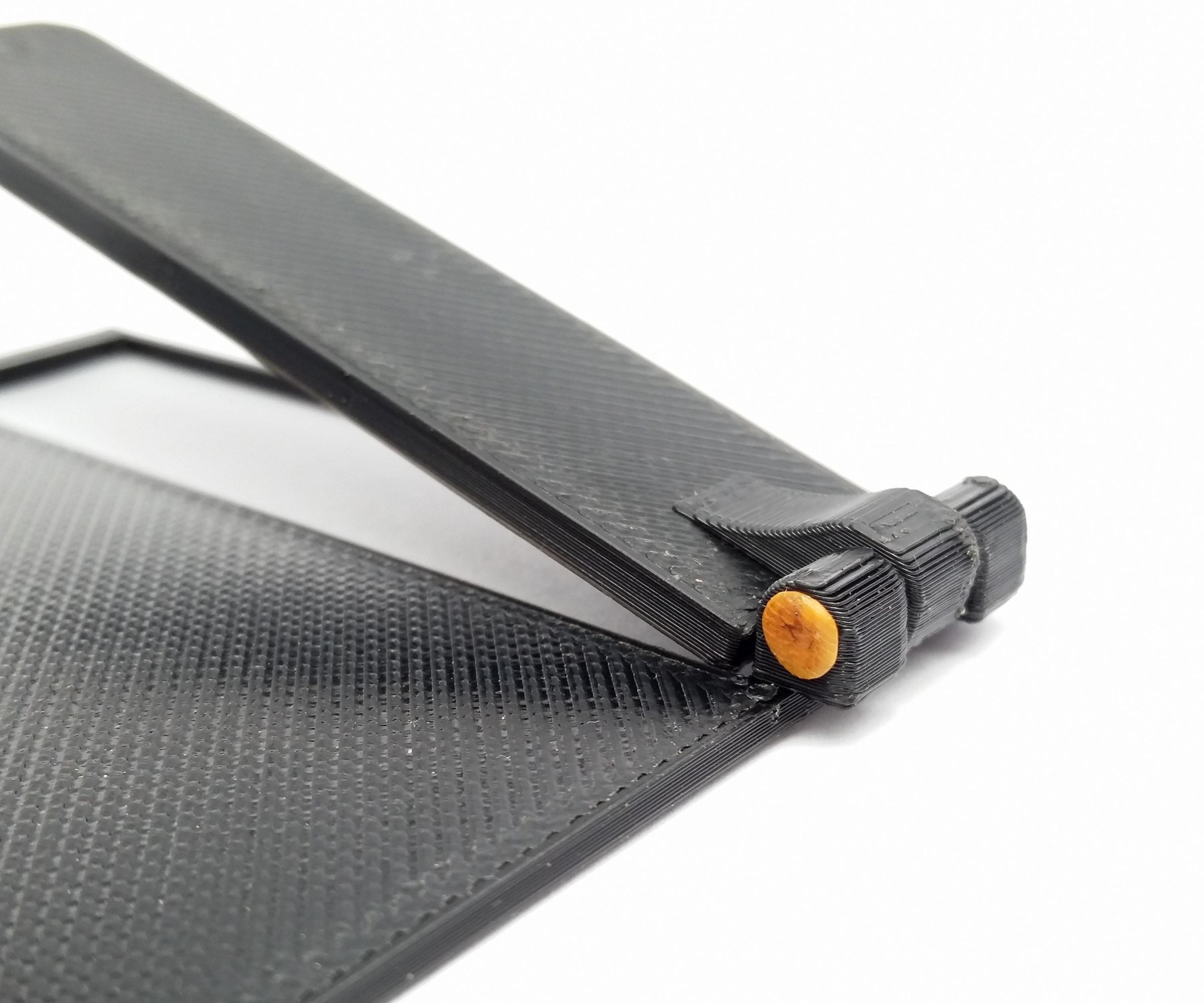

Step 2: Design and Print the Enclosure:
As always I turned to Fusion 360 for the design of the enclosure.
The enclosure is split into four pieces:
  • The main enclosure
  • The back cover
  • The battery lid
  • and The sun shield
Only the back cover and battery lid will need supports as the hinge parts are not touching the bed, I recommend that you print all of the parts with either PETG or ABS(ASA) filament to stand up to the elements outside.
I printed these using SBS witch is a derivative of ABS with a more rubbery property and works wonderful for rugged parts.
Included below is the STL's for all the parts including the STEP file, feel free to customize as required.

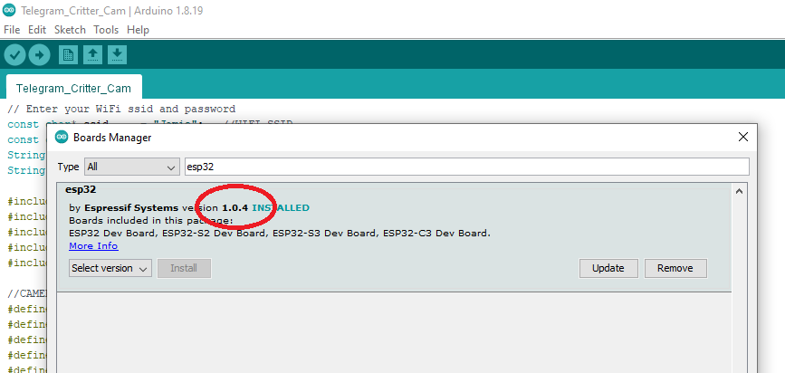

Step 3: Coding the ESP32:
Below is the standard code for the Critter Cam, without modification this code will take a picture every time motion is detected and send the picture to your Telegram account.
IMPORTANT: I found that the newest version of the ESP32 package on "Board manager" in the Arduino IDE gives a problem with Telegram, to ensure the code works install package version 1.0.4

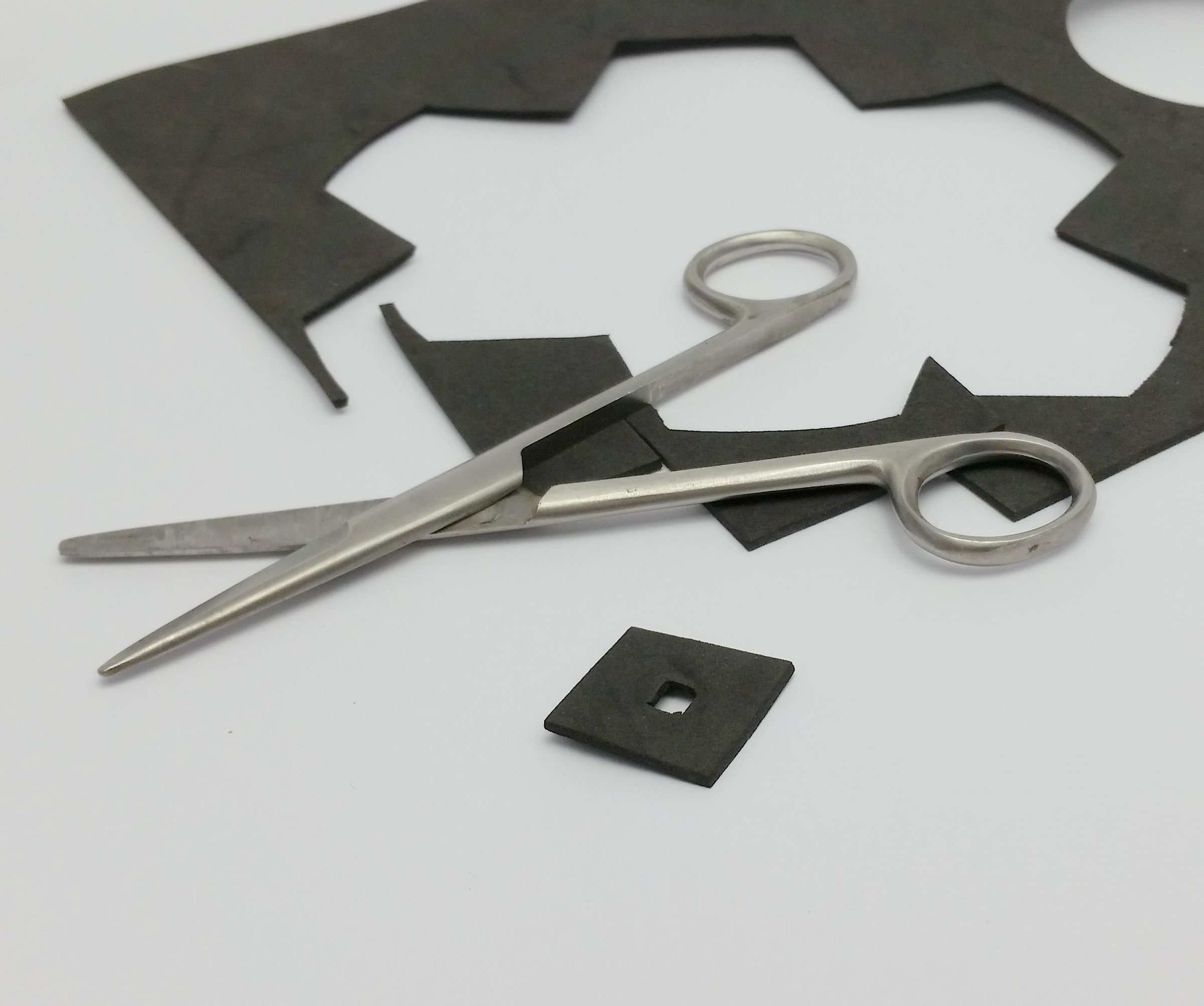

Step 4: Start Assembly:

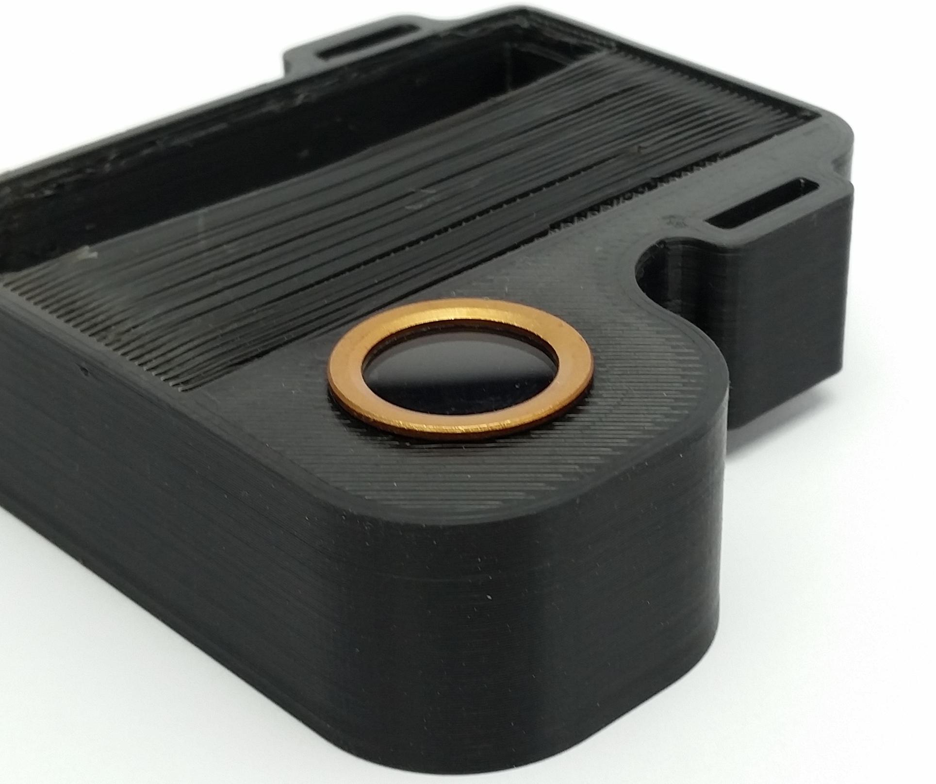

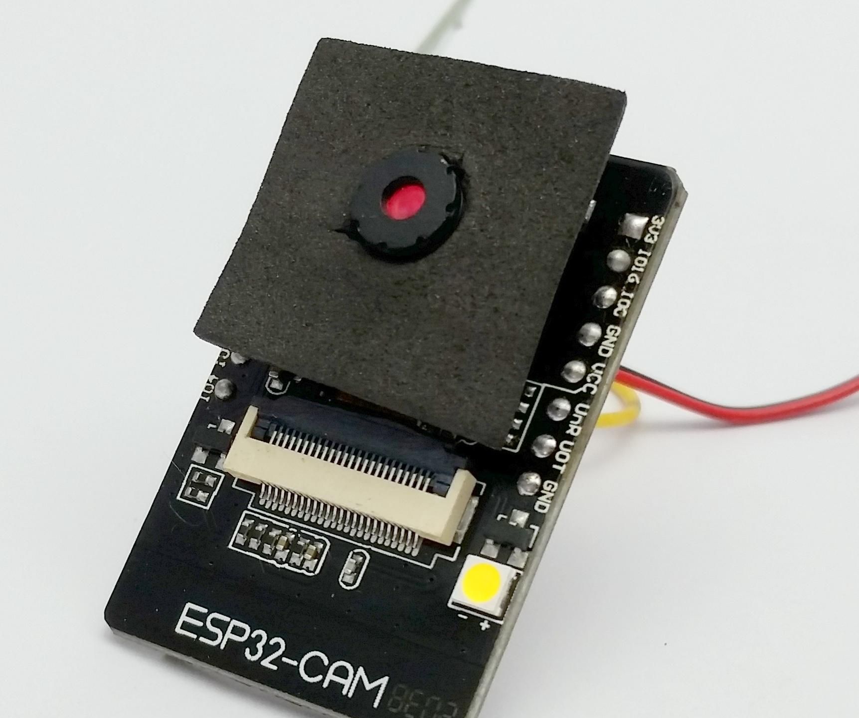

Before we can continue we need to assemble the lens cover.
In this build I used a aluminium bevelled glass lens cover that was salvaged from an old broken CCTV camera, these are plentiful at metal recycling centres and are a great source for 12mm lenses for all your camera related projects as well as tons of IR LED's...more on that later
The lens cover I'm using simply pushes into place with some force within the 19mm hole in the design (I've disassembled a few CCTV cameras and this seems to be standard across the smaller cameras).
We can use some B-6000 glue to seal around the cover on the inside.
Next I cut out a small square of foam from some scraps to surround the camera sensor, this hides the electronics behind the sensor and also eliminates any reflections from the bright metal behind the sensor.

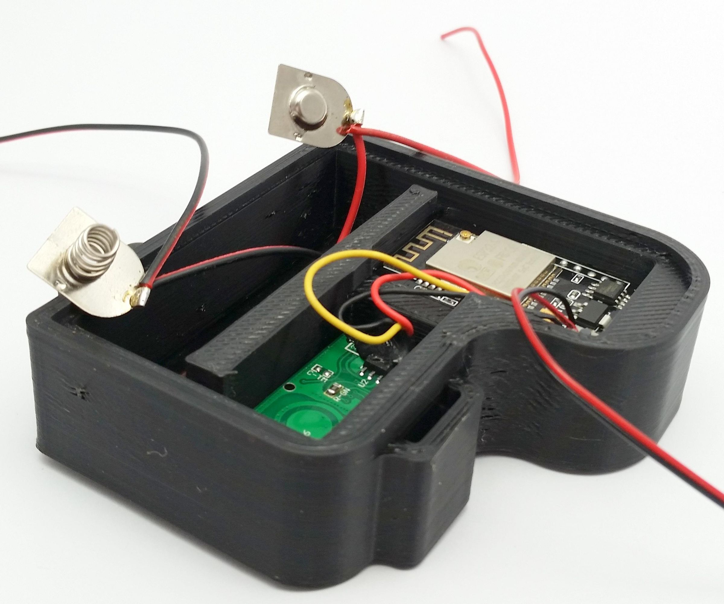

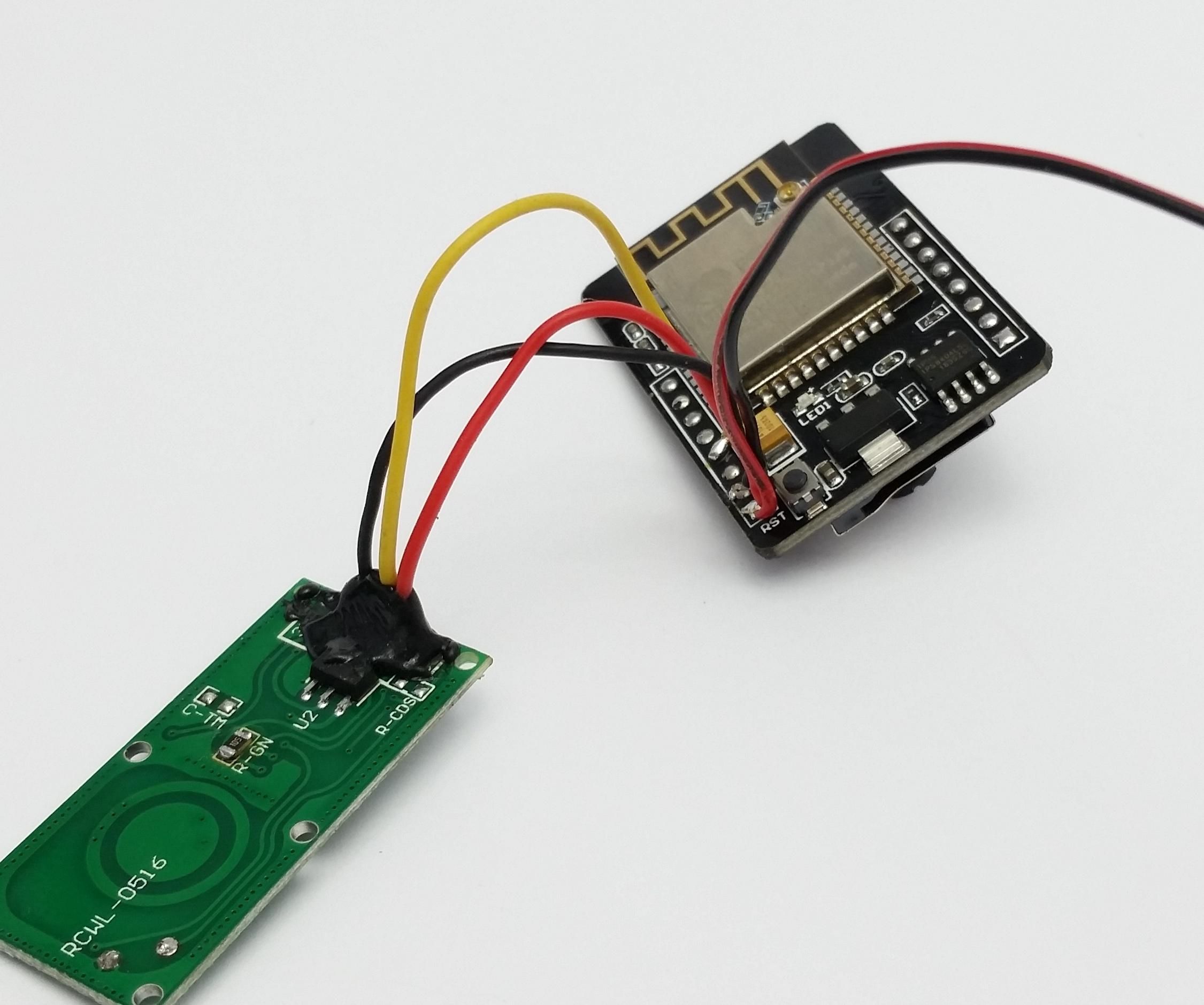

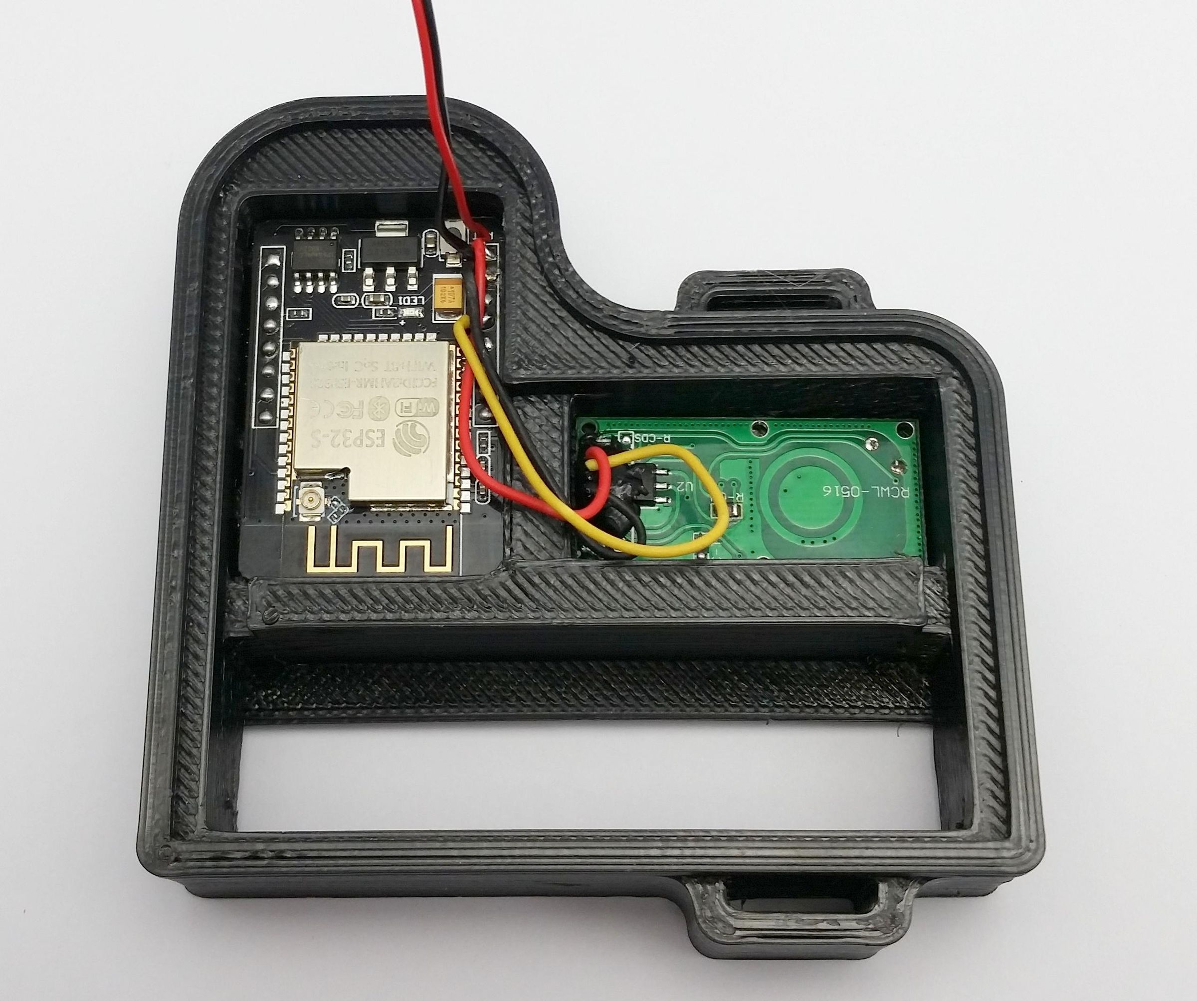

Step 5: Solder the Electronics:
Time to get our modules soldered together.
This is probably one of the least intimidating solder jobs I have done in a long time as there are so few wires to connect and it connects directly from pad to pad no special soldering magic required.
To get everything working for this project we only only need a power connection and a single signal wire...That's it!
Start by soldering on three differently colored wires onto your RCWL-0516 module, I have RED soldered onto the VIN pad, BLACK soldered onto the GND pad and a YELLOW wire soldered onto the OUT pad.
From there we solder the RED wire onto the 5V pad on the ESP32-CAM module, the BLACK wire gets soldered onto the GND pad and the YELLOW wire gets soldered onto the IO13 (changed it to IO13 the diagram still shows IO12).
Note that I also soldered an additional 5V and GND wire onto the ESP32-CAM modules pads as this will go to the battery tabs.

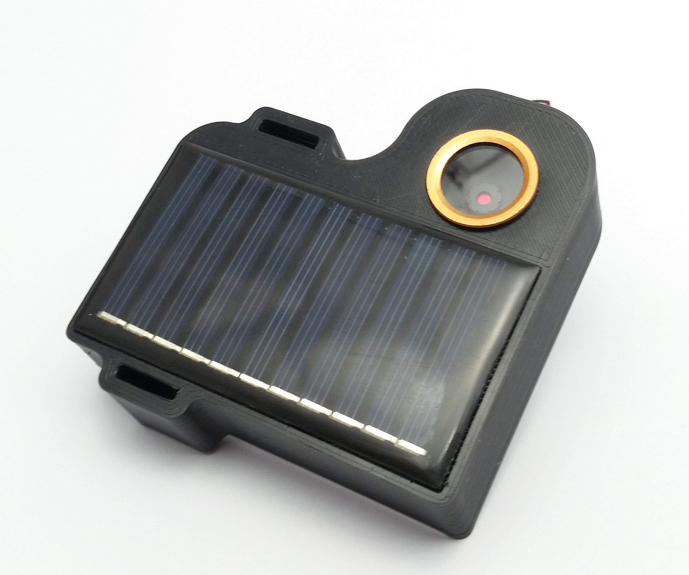

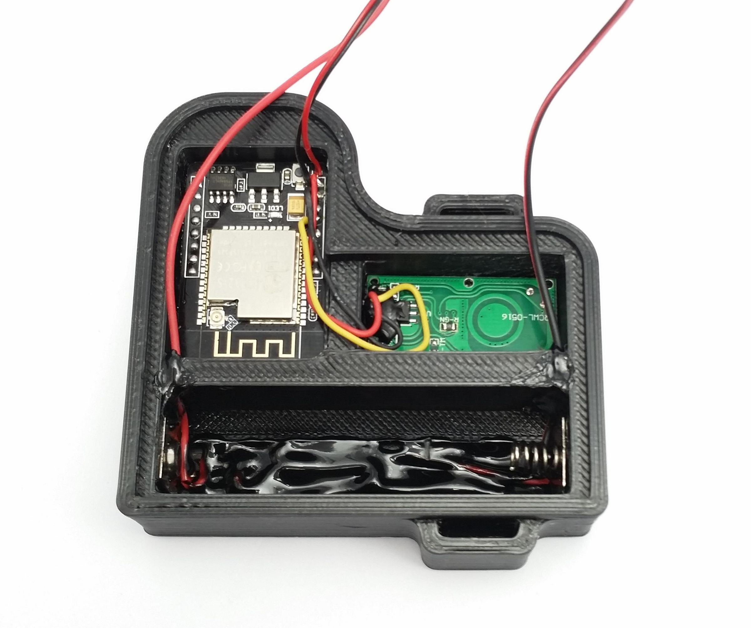

Step 6: The Solar Panel & Battery Tabs:
Now that the two main modules are soldered together we will need to provide them with a power source.
When starting this project I never intended the camera to be left outside unattended for multiple days, so I designed it to be powered from a single removable 18650 and a quality name brand cell easily provides us with 24 hours of working time but just so that we don't deplete the cell every time and as such increase our battery's lifecycles I decided to add a inexpensive small 5V solar cell in parallel with the battery.
If you prefer you can use a battery with a built in protection circuit but as the solar cell is only there to assist and is too weak to ever really charge the battery it shouldn't be necessary.
I used some 2 part CA glue to glue the small 85mm X 45mm solar panel in place after feeding the wires into the enclosure.
We then need to solder the leads from the solar panel to battery tabs that our 18650 battery will connect to, the positive wire from the solar panel goes to the flat battery tab and the negative/GND wire from the solar panel goes to the tab with the spring attached.
Next we need to solder on the power wires from the ESP32 module to the battery tabs, there are two slits on either side for the wires to lay flat in.
I used black hotmelt glue to waterproof the back of the solar panel and also hide any excess wires.

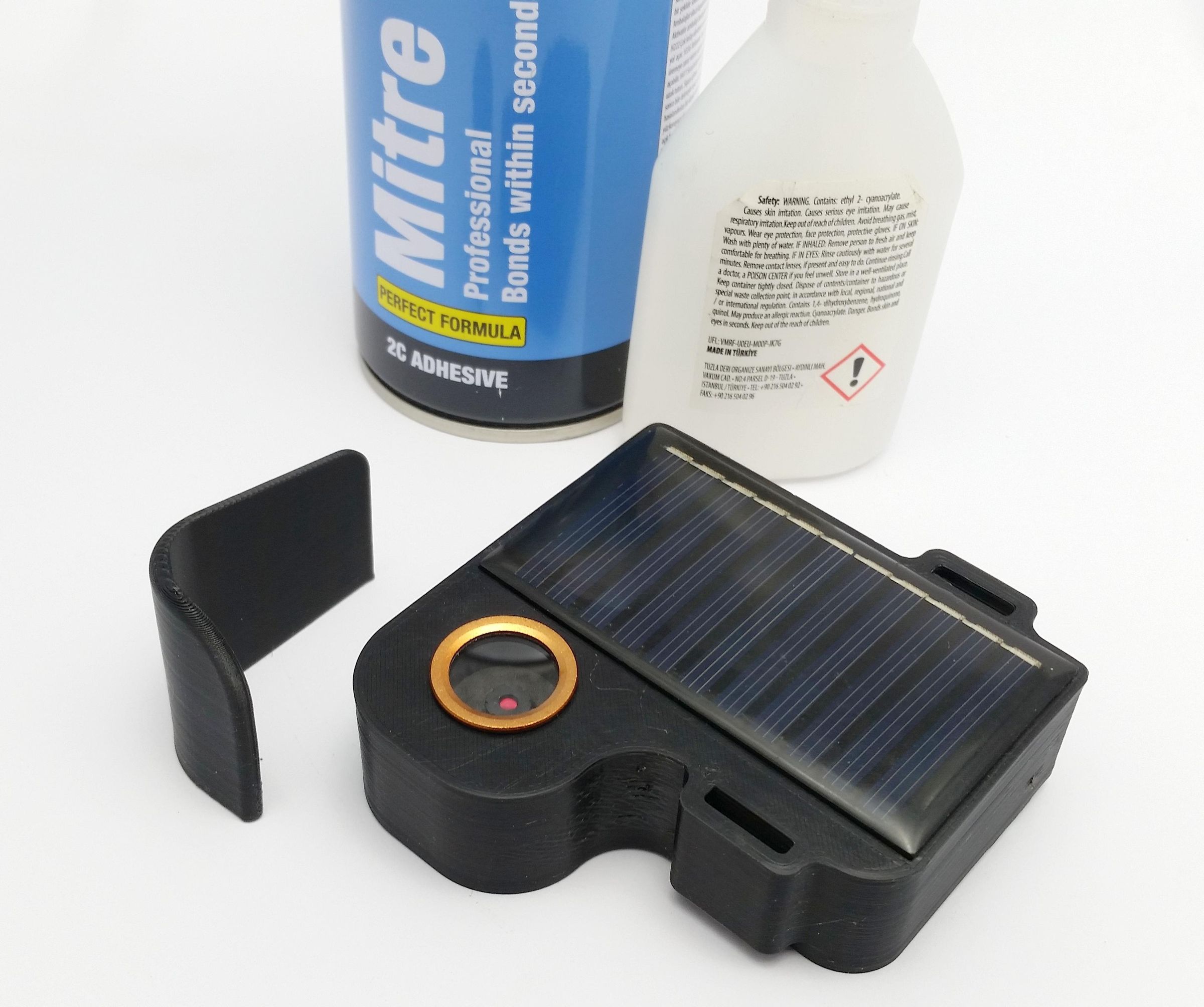

Step 7: Finish the Assembly:
We can now put everything together.
For the hinge pin of the battery lid I simply used a piece of printing filament cut about 6mm longer than the hinge and then simply heated both ends of the filament with a lighter flame and squished it with my finger to prevent it from sliding out.
Next I applied a bead of B-6000 glue all around the seam of the enclosure and pressed the back cover into place, the B-6000 will fill any cavities and give us a weatherproof seal.
And finally we need to adhere the sun shield to the top of our camera housing. I used 2 part CA glue to permanently adhere it to the camera body, the shield will help debris from getting onto the lens and also prevent some sun glare.
You can now add either a strap or elastic through the mounting holes and start using your critter cam!

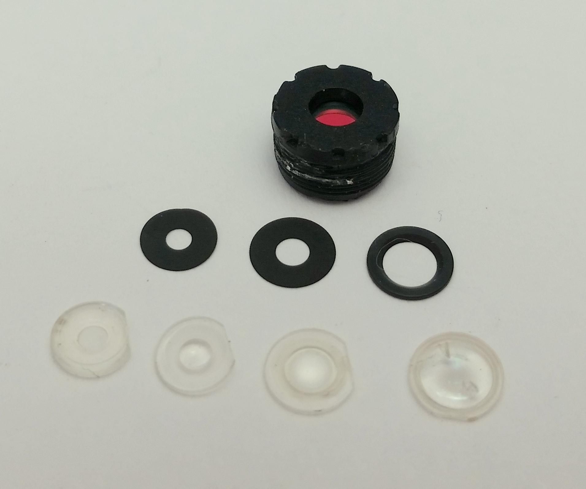

Step 9: The IR Version:
My next iteration of the critter cam will include IR LED's that will allow us to catch some creatures of the night in action.
Unfortunately for us to take pictures in complete darkness we will need to remove the IR blocking lens that is present in the standard ESP32-CAM module's lens stack, I find it easier to modify the original sensor in order to use readily available 12mm lenses than trying to remove the IR blocking element from the original lens.
As you can see the red IR blocking lens is the last of the stack.
If you want more information on fitting a 12mm lens you can have a look in my Instructable "Kodak Brownie Digital Camera" where I modified the original sensor of the ESP32-CAM.
