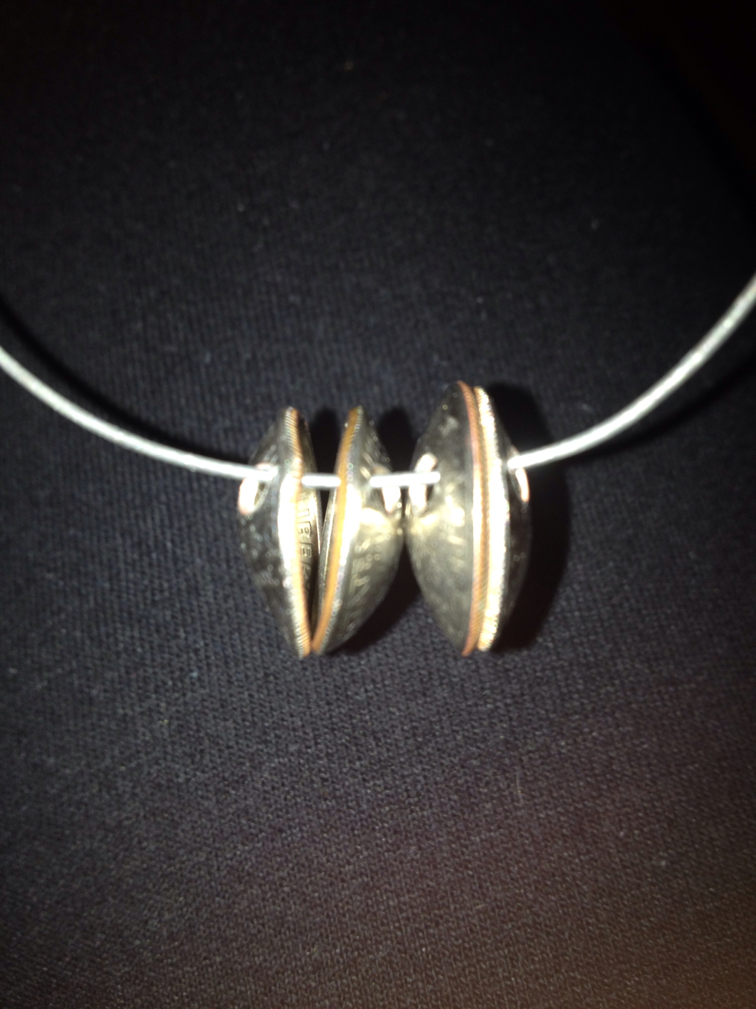

I absolutely recommend getting Mothers mag and aluminum polish. This stuff works great and it is cheap. It can be found at Walmart, autozone, or amazon. It runs $3-$7 depending on where you buy and what size. This stuff works on nearly all metal items and hasn't let me down. To polish put a dab just a small amount on the ring and rub on a towel or cloth. It takes a bit of elbow grease, but it is worth the work. The ring is a silver ring I made a while ago different type of ring, but it's polished with this stuff just to show its result. I gave it a texture I call dragon scale so when the light hits it the light bounces everywhere.

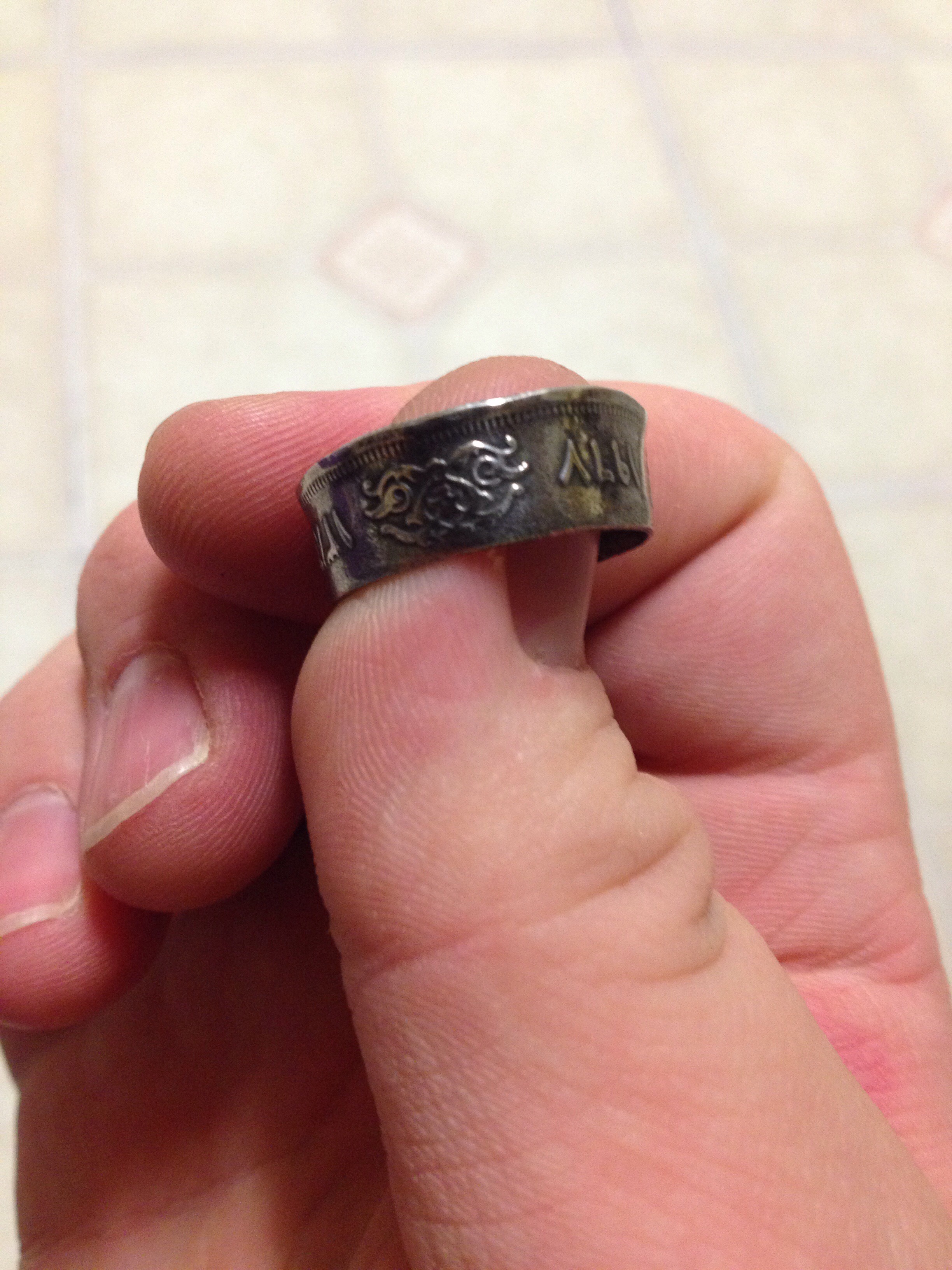

This is a way to make unique art. No two coins are alike, as coins are various in ages and conditions and they always come out looking different. Some of these online cost $50 or less or more. I do this as a hobby and a job. I am 16 and I enjoy watching people marvel at things they don't see everyday. When heating the coins you can quench it to cool it and make it more handle-able and it will still work out, but I don't because I can make them faster and easier without cooling them. Also any coin will work as long as it is big enough to fit on the mandrel. If you have any questions I will respond to them, this is my first guide ever!!! Online some people charge to share knowledge and I am against that. I hope you can learn to make rings as I have. I share this to bring the joy to you as it has to me.
Step 9: My Works
These are my rings I've made. I started because my aunt talked about her fathers ring he made for his wedding ring and my aunt made one and I tried to make one to make the memory come to life again.
