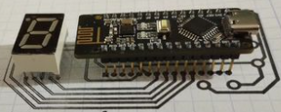

Run the file from the memory card or removable drive. Your printer uses the same code to know where to go as a CNC cutter, and thus it can read the commands. If a printer refuses to run due to certain unknown commands in the file, open the .gcode file in the Text Editor and erase said commands (they usually mean the direction or speed of the spindle, motion commands are identical). If your marker does not draw well enough:
  1. your bed might not be leveled correctly or the clad is not flat with the bed (you will notice only certain areas are not drawn well)
  2. the height of the marker is too high, set it up again like shown in step 4.
  3. the size of your tool in FlatCAM is too small, enlarge it by 0.1mm and try again
Picture shows the circuit plotted on a piece of paper.
