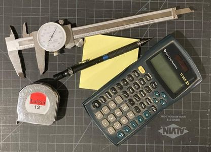

  • Measure them, ideally with great accuracy, and sketch those dimensions into any 2D linework editor. Side view, and front view should suffice.

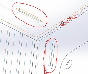

  • Design in an assembly plan. (notice the partial-height tabs and respective slots, which allow for easy assembly and plug-welding.)

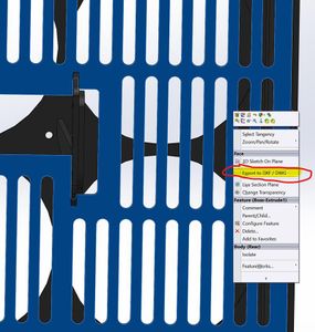

  • Extrapolate 2D cut-profiles from each part once the 3D design is finalized.
