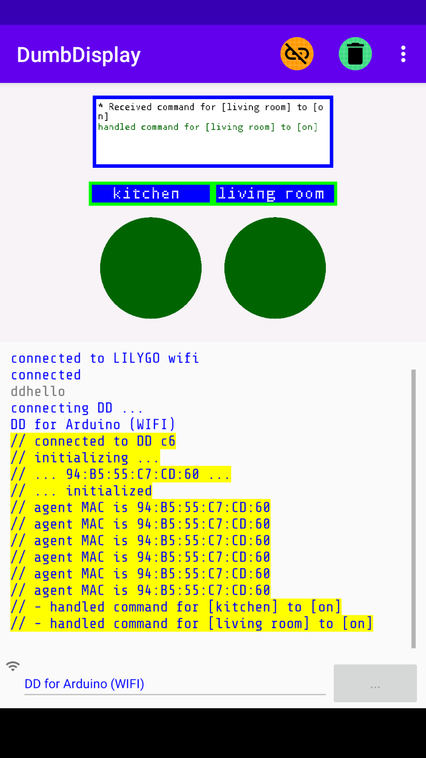

DumbDisplay will be used as UI for both "voice commander" as well as a way to simulate ESP-Now "voice command receiver" agents. Nevertheless, a more "real" ESP-Now agent is set up with an ESP01 relay module, which connects to a motor to take the role of a fan.
The voice commands in the experiment of this post are:
  • Turn on / off the kitchen.
  • Turn on / off the living room.
  • Lock / unlock the bedroom.
  • Lock / unlock the balcony.
  • Turn on / off the fan

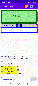

Step 1: ESP32 Voice Commander UI
The UI of the "voice commander" is realized by DumbDisplay, and the UI is pretty simple. Basically, you just click on the Start button to start capturing voice commands. It is a loop. It will keep on listening to voice commands until you click Stop.
Before starting, you may optionally select some preferences
  • You can choose to have the captured voice replayed back before the voice is sent to Wit.ai for voice command recognization.
  • You can also adjust the simple "software-base amplification" factor, which is defaulted to 10.

The JSON values are read by DumbDisplay app, extracted to key-value pairs, and send back to ESP32 as "feedback".
On the ESP32 sketch side, the "feedback" key-value pairs extracted from the Wit.ai result are read like

Another important step is to find out the MAC addresses of your ESP boards for ESP-Now connection.
Assuming you are using WIFI for connectivity; after you updated the sketch, you can open serial monitor with baud rate 115200, and see lines like
* agent MAC is 94:B5:55:C7:CD:60
Here, you will see the MAC address of the agent. And this MAC address is the value you need for defining "voice commander" sketch's XXX_ESP_NOW_MAC macros
// define ESP-NOW clients ... comment out what not used
#define LIGHT_ESP_NOW_MAC   0x94, 0xB5, 0x55, 0xC7, 0xCD, 0x60
#define DOOR_ESP_NOW_MAC    0x48, 0x3F, 0xDA, 0x51, 0x22, 0x15
#define FAN_ESP_NOW_MAC     0x84, 0xF3, 0xEB, 0xD8, 0x41, 0x53
For example:
94:B5:55:C7:CD:60 ==> 0x94, 0xB5, 0x55, 0xC7, 0xCD, 0x60
The sketch will just sit there (occasionally write out the agent's MAC as comments), and wait for voice command from "voice commander". Once received "understandable" voice command, DumbDisplay app's display will be updated to simulate executing the voice command.
