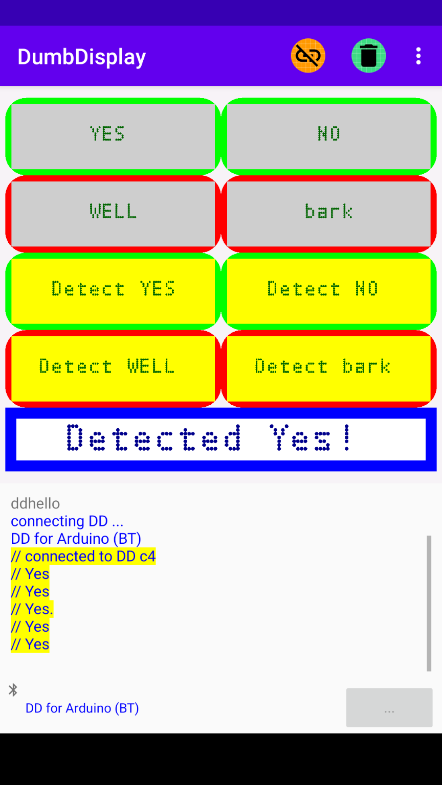

Step 3: DumbDisplay As UI
The UI for the sketch is realized with DumbDisplay.
  • Sample WAV files for recognization comes with DumbDisplay app. For this, you will need to grant "media storage access" to DumbDisplay app. You do so with the settings dialog of DumbDisplay app.
  • DumbDisplay app can be used to play the WAV files. You can try playing the WAV files by clicking the gray buttons. The button click is sent as "feedback" to ESP32, and ESP32 then drives DumbDisplay app to play the WAV file.
  • DumbDisplay app is also responsible for sending API request to Wit.ai, interpreting the JSON response, and sending back the extracted "answer" to ESP32 as "feedback".
  • You trigger recognization by clicking the yellow buttons. If YES yellow button is clicked, YES should be recognized. After successful recognization, YES will be sounded. Similarly, the sketch will consider NO a correct recognization.

Other than using layers for drawing buttons etc, the "meat" is a JsonDDTunne, which is used to trigger DumbDisplay app to send request to Wit.ai API endpoint and get back result, on behalf of ESP32.
// declare "tunnel" etc to send detect request to api.wit.ai ... please get "access token" from api.wit.ai
JsonDDTunnel* witTunnel;
const char* witAccessToken = WIT_ACCESS_TOKEN;
DDTunnelEndpoint witEndpoint("https://api.wit.ai/speech");
The Wit.ai API HTTP request is a bit more involving.
  // create / setup "tunnel" etc to send detect request
  witTunnel = dumbdisplay.createJsonTunnel("", false);
  witEndpoint.addHeader("Authorization", String("Bearer ") + witAccessToken);
  witEndpoint.addHeader("Content-Type", "audio/wav");
  witEndpoint.addParam("text");

Wit.ai api call result is a series of JSONs, and the JSON values are extracted to key-value pairs, for sending back to ESP32 as "feedback".
For example,
"speech": {
    "confidence": 0.7399,
"confidence" value will be extracted as the key-value pair -- "speech.confidence" / "0.7399".
And
"text": "Yes",
"text" value will be extracted as the key-value pair -- "text" / "Yes".
The parameter "text" set to witEndpoint as mentioned previously, will filter for those key-value (field id-value) pairs with matching key "text".
Hence, the Wit.ai api call result is read like
    String detected = "";
    while (!witTunnel->eof()) {
      String fieldId;
      String fieldValue;
      if (witTunnel->read(fieldId, fieldValue)) {
        if (fieldValue != "") {
          dumbdisplay.writeComment(fieldValue);
          detected = fieldValue;
          statusLayer->writeCenteredLine(String("... ") + " [" + detected + "] ...");
Note that due to the "text" filtering parameter, only "text" key-value pair will ever be returned. Therefore all values read here will match key "text", i.e. the detected text.
