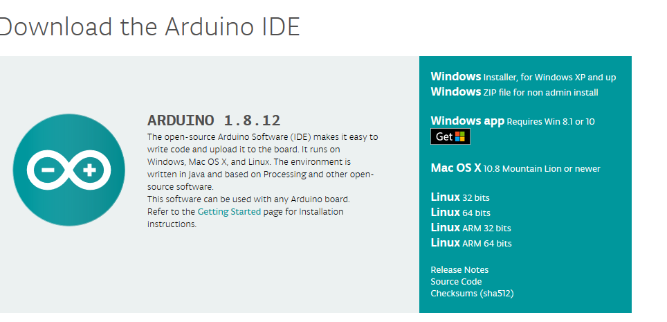

Get the Arduino IDE:
- In a browser go to https://www.arduino.cc/
- Click on Software then Downloads to get ARDUINO 1.8.12

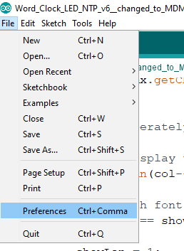

- Start the Arduino IDE
- Click on the File Menu then Preferences.
Once in "Preferences" add the manufacturer support by adding the following line to the "Additional Board Manager"

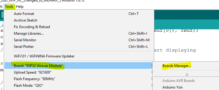

Go to the Tools Menu and then Boards and go to the board manager

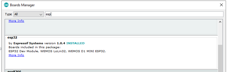

Next search for "ESP" and add the package by Expressif.
Lastly we want to go back to the "Tools" Menu, then "Board" again and scroll down to find your ESP32 device.
Mine is a "ESP32 Wrover Module"

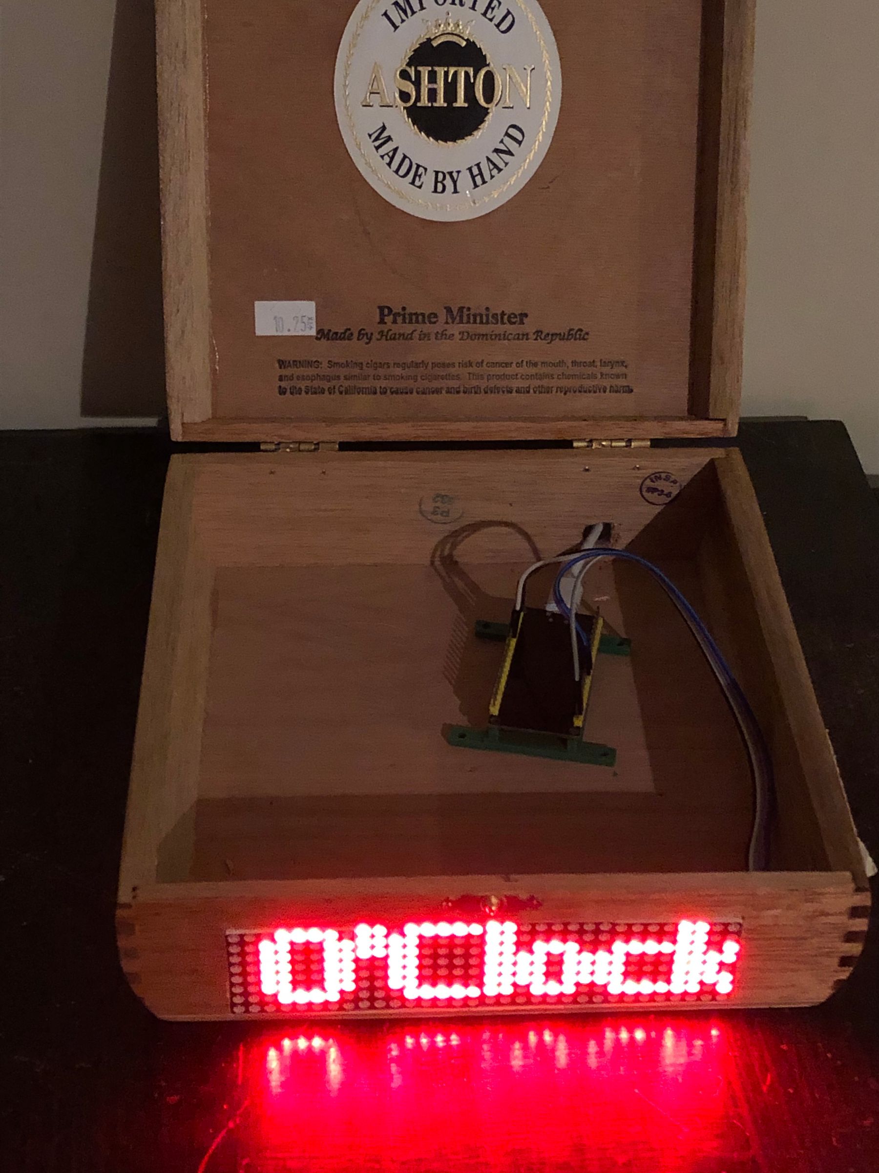

Next I cut the cigar box to give me a place to put the LED display. The box is soft and I was able to use a razor knife. Then I sanded to smooth it out.
I also cut a whole in the back for the power cord. I just used USB power. I could have even added a USB phone charger battery inside the cigar box if I had wanted it to be wireless.
