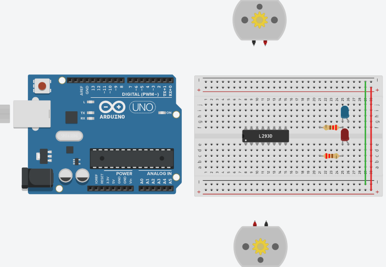

Step 2: Building the Circuit
Here is my Tinkercad CodeBlocks example.
Build the circuit:
- Drag out a breadboard. Small is fine.
- Drag out an Arduino Uno
- Put two LEDs on the board.
- I use one for power. Its color is green and its on the whole time.
- A Blue one we turn on each time the motors are turned on.
- Drag out two resistors
- set value to 220 ohm
- Rotate them 90 degrees
- Set these so one end it on the cathode side of the LED. You can mouse over the LED terminals to see it.
- Next Search on DC Motor and pull out two one on top and one on bottom.
- Name them Right and left.
- Search on L293D and put it in the exact middle of the breadboard so it straddles the grove in the board.
- At this point I also connect the rails on each side of the breadboard, so we can use both rails equally.
- + to + with red wire
- - to - with green wire

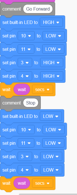

Step 5: Program the Arduino
Finally we are ready to program the Arduino and make our tank move.
Click the "</code" button and pick both Blocks and Text. The text is read only but its good to see the program being created.
Clear the sample block by draggin it to the trash.
First I click on the "Notation" section and pull out a title block.
- I add comments here. (hint use /n to move to the next line "newline" to the comment if needed)
- I add my name and date and comments I might need.
I also add a comment to remind me how the motor driver works:
RIGHT WHEEL pin4 Pin10 Spinning Direction Low(0) Low(0) Motor OFF High(1) Low(0) Forward Low(0) High(1) Backward High(1) High(1) Motor OFF LEFT WHEEL pin3 Pin 11 Spinning Direction Low(0) Low(0) Motor OFF High(1) Low(0) Forward Low(0) High(1) Backward High(1) High(1) Motor OFF
So in pin 4 and 11 are the same the motor stops and different the motor moves.
Next I created a variable called "wait" by clicking on variabled and putting in wait in the name. This will be the delay we use between each action. CodeBlocks will automatically initialize it to 0;
Set the wait value to 5 and drag it under the comments. This is our first line of code.
I then add the Comment "Move Forward"
Now we set the outputs to move the Tank forward.
- Click on the Output Block.
- Add "set 10 to Low"
- Add "set 11 to Low"
- Add "Set 3 to High"
- add "Set 4 to High"
- The go to control block and pick "Wait 1 secs"
- Click on the Variables Block
- Pick the round wait variable and drop it on the 1 in the Wait 1 secs.
- We can now control the wait.
Next we need to stop it. The easiest way is to copy the above block except the "Set wait to 5"
We copy by right clicking on the Comment "Go Forward" and then click on "Duplicate" Paste the code at the end of the program.
- Change comment "Go Forward" to Stop.
- Change set Built-in LED to LOW ( blue led off when stopped).
- Set Pin 3 LOW
- Set Pin 4 LOW.
If Pin 3,4,10 and 11 are the same the tank will stop.
wait 5 seconds then restart.
