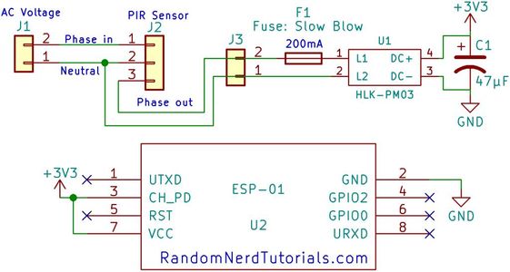

The schematic diagram below illustrates the circuit for this project.
Start by removing the lid of your PIR motion sensor. Inside, you should find three wires: phase in, neutral, and phase out. Follow these steps:
  • Connect phase in (brown) and neutral (blue) wires to the motion sensor.
  • Connect neutral (blue) and phase out (red) wires to the input of the HLK-PM03.
It’s advisable to incorporate a slow-blow fuse just before the HKL-PM03 converter and a capacitor at the output.
Note: If you’re utilizing an ESP8266 that remains powered on with the HLK-PM03, we recommend employing this protection circuit.
The HLK-PM03 supplies 3.3V and GND, which are linked to the ESP8266’s VCC and GND pins to provide power.
We’ve assembled the HLK-PM03 and ESP8266 circuit on a compact protoboard to conserve space. Additionally, we’ve included header pins for the ESP8266-01 module, allowing for easy attachment and detachment of the board whenever new code needs to be uploaded.
