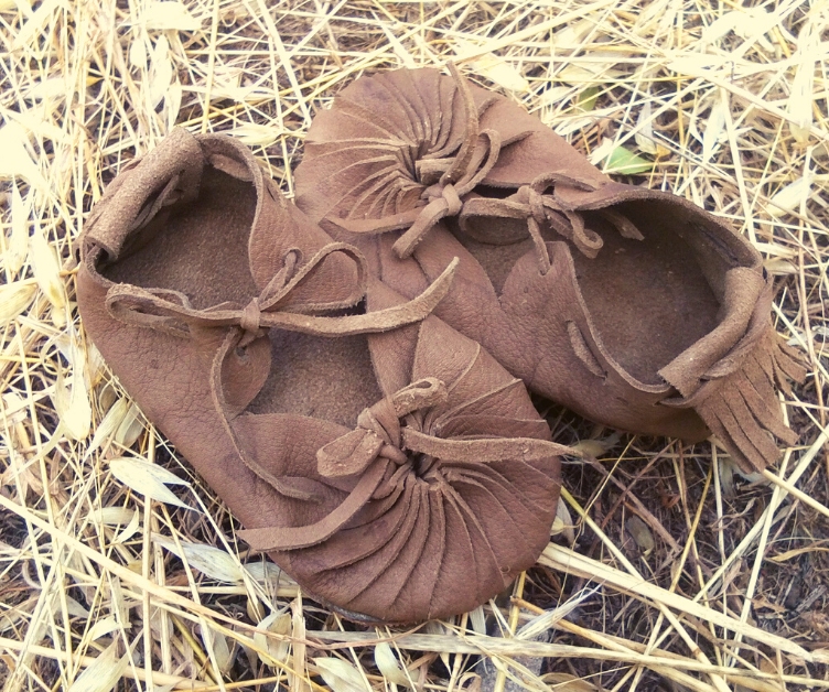

Introduction: Easy Leather Sandals - Sun Sandals
About: Lougaya began making moccasins in 2016. She started to sale custom-fitted moccasins on local craft and farmer’s markets until she gained enough confidence to start teaching the craft on person and online. In t…
Hello ! Here is an easy Soft-Soled Leather Sandals project that you can make at home with a very few tools.
It is a fairly common design that usually would be with overlapping petals at the front but here I use soft leather which enables to simply fold-up around the toes for a puckered-toe style. I have find that less sand and stones get in the shoes like this...
I really like to wear these outside in the summer time and in the winter, I wear them indoors with socks as the laces can easily adjust to wearing thicker layers.

Step 5: Lacing Your Sandal
Place the outside side in front of you and start lacing going inside the first hole and outside the next hole. Continue in and out... Once you have finished lacing the front, pull tight and center your lace.
This will bring the front part of the shoe together. Make a double knot to secure the front part tightly.
Then lace the top 3 petals in a cross pattern.
Step 6: Lace the Heel
Like in the picture, lace the heel for the tongue to join the sides.
Start from the base of the heel. According to the pattern, Hole 1 will join on top of 1’, 2 matches with 2’ and so on... You can lace it in a cross pattern, going from one side to the other. Finish up like you feel... There is no special technique here...
Step 7: You've Made It ! Make Leather Soles on Them...
So you've made it! Here you can see how to make soles on them for durability.
It is best to walk with your new shoes for at least a week or 2 before your make soles to clearly see the footprint under the shoes.
Soles can be made and replaced as many times as needed of the years.
