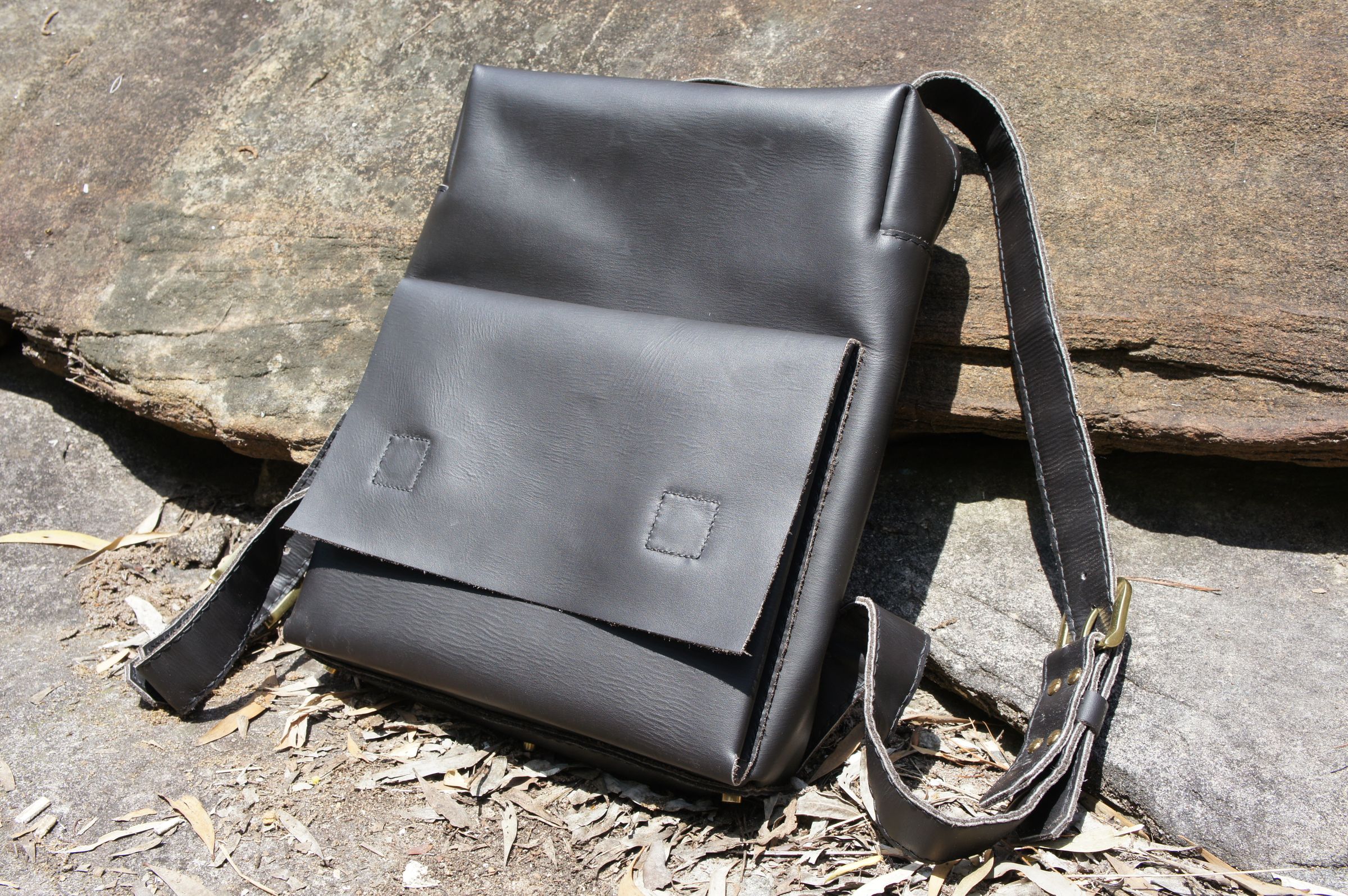

- Magnetic snap clasps - 1 set (can be substituted for press studs or similar securing paraphernalia)
Thread (preferably waxed) - I used flat, 1.0mm waxed Tiger thread by Julius Koch
*Phew, what a list! Hope I didn't forget anything. ;)
**To top it off, all of these were leftovers from my previous project so I didn't spend a single cent. Ahh, the perks of over-buying.
