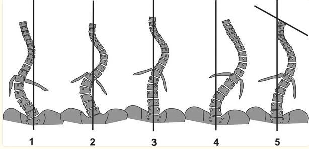

·      Medical Diagnosis: Congenital Type 1 scoliosis An S-shaped curve crossing the midline of the thoracic and lumbar curves. The lumbar curve is larger and more rigid than the thoracic curve (the types of scoliosis are shown in the picture). In the fisrt curve, she has moderate scoliosis in the thoracic area according to x-rays 27°, but because of the progression of the scoliosis, the current scoliosis is estimated to be moderate to severe. The user has not previously received treatment for scoliosis. Second curve is located in the lumbar region, according to x-rays taken at 10 years of age, the angle of severity is 38°, however, as scoliosis is a progressive condition, we currently find an angle of severity close to 55° that is >40°, which would place the user in a severe scoliosis (Image 1).

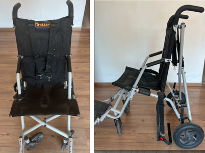

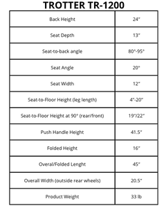

·      Mobility Level: The user is dependent on a wheelchair for mobility, which implies specific considerations in terms of accessibility and safety. This project will work with the TROTTER model TR-1200 wheelchair (Image 2).

·     Information about the wheelchair and the model can be found on the Trotter website, it is important for develop a suitable lateral support.

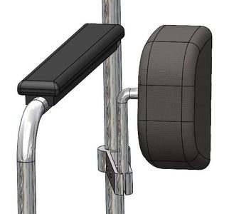

Step 3: Design

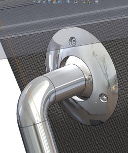

The design consists of 4 pieces, a clamp, the head, the insert and cushion, basically the clamp is a link with 3 holes of 5 mm in diameter, which is screwed into the frame of the wheelchair, being a clamp allows you to have different heights, On the other hand, the head and the insert have a joint as is the femur to the hip, this allows it to rotate on its own axis, giving the possibility of an ergonomic fit of the cushion to the user's desire, the head is screwed and tightened from the clamp.

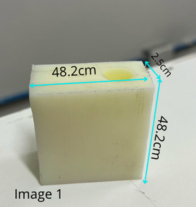

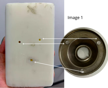

Step 5: Nylamid: Connection Block Cutting
From the measurements of the wheelchair tube, two pieces were obtained that will function as a base for the cushion and will generate the connection between the chair and the support.
Both pieces were cut using a bench drill
Step 6: Nylamid: Pad Block Cutting
Two Nylamid blocks were cut to be used as a support inside the pad

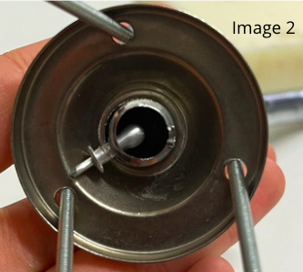

Step 7: Join Flange, Tube and Nylamid Block for the Pad
We taked the nylamid and drill three corresponding holes to be able to join it with the flange, as shown in image 1.
Subsequently, we join the flange to the pipe using a rivet, as shown in picture 2.
Finally, using screws, we joined the flange to the nylamid as shown in picture 3.

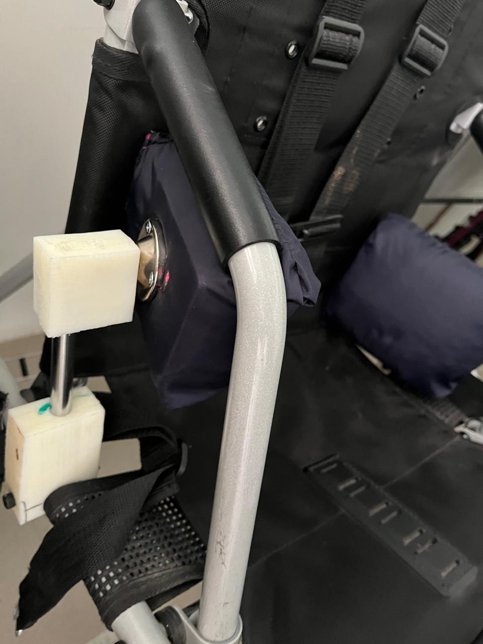

Step 9: Assembly Heights
To establish the heights of the supports, taking into account the measurements of our user, we made two elbows to connect the tubes and generate the corresponding angle to reach the desired height. One of the elbows is shown in Image 1.
One elbow was placed at 17 cm (Image 2) and the second at 10 cm (Image 3).
Step 10: First Assembly
Assemble the parts resulting from the above steps and obtain the final assembly, do not forget to tighten the screws.
Step 11: Final Assembly
Finally, place the pads on the flanges and secure them with the screws, the result can be seen in the attached images.
