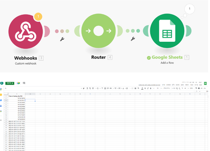

That's it! Make is a very powerful platform that allows you to automate a wide range of tasks and workflows, saving you time and effort in the process. We used it to automate the reporting of the medication using Blynk connection.

1st feature: Medication Reminders and Google Sheet Tracking for Caregivers
Designed to support the care of elderly individuals, this feature is suitable for social workers or family members. To ensure the elderly have taken their daily medication, a reminder sound can be activated with a button press. The elderly can then confirm by saying "PILL TAKEN," and this information will be recorded in the medication tracking table on Google Sheet. This allows the senior's physician to monitor and verify that the medication schedule is being followed.

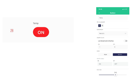

Temperature Check through the Controller
A button has been added to the BLINK interface to initiate temperature measurement. The user simply needs to blow on the device, and the heat absorbed will be converted into Celsius and displayed on the user's screen in BLINK. This allows healthcare professionals such as doctors or therapists to easily monitor the user's health status. The button is assigned to PIN V1 and the display is assigned to PIN V0

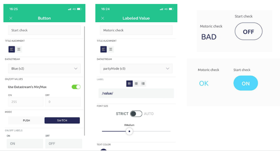

The Cognitive and Motoric Test, (from the controller), assesses an older person's physical and cognitive abilities. The therapist activates the test button on the Blynk device and instructs the older person to shake the controller with their right hand for 10 seconds. If the shaking is strong enough as determined by the pre-set parameters, the accelerometer will light up the LED D13 in red and the interface will display "OK". If not, the interface will show "BAD". To test the left hand, the therapist must press the button again to repeat the process.

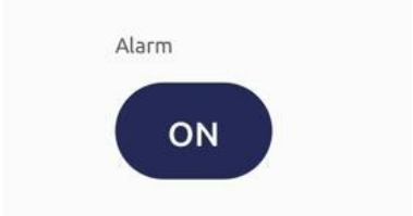

Alarm clock (to controller)
Option A:
A remote alarm clock that can be activated by the elderly person's caregiver or relative. The feature is designed for elderly individuals who struggle to operate a cell phone or forget things, as it provides reminders through sounds and lights with a simple push of a button.
Option B:
An automated alarm clock that syncs with a GMT web API. To help elderly individuals maintain a consistent daily routine, this alarm clock plays pleasant sounds and activates soft lights to wake them up every day at 6:00 AM. The controller activates the alarm clock at the designated time, and it can be turned off by sliding the switch.
