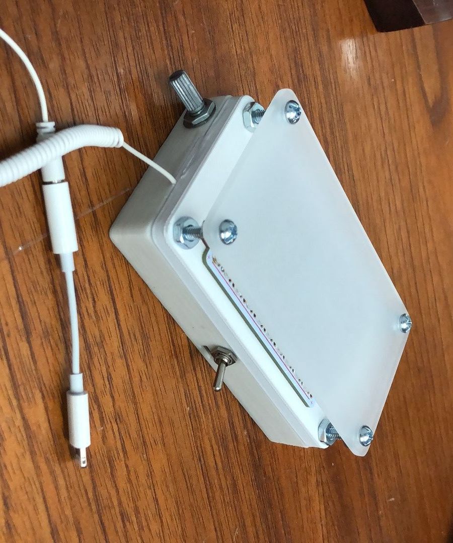

As you can see in the picture above the case its made by 3 different pieces, the cover with a simple circular design, behind a 3mm acrilic sheet and at the end the box that contains everithing in it.
Oh, almost forgot it, I will put this device INSIDE a door, not on either side, so... it will sit flush with the door face.

Step 8: Put All Together
In this step you should have everything to make the dream come true, if you are not able to get some of this materials you can always change it for some similar piece.
The USB guard is in place with a screw and a nut, both where contemplated in the 3D model so they fit perfect in place.
For now the front part is just in place by the act of a prayer but in the real product this will be held by screws on the inside.
I'm still thinking of how and where to place the touch sensor to lock the door.
As I told you earlyer I still have some trouble with the capacity of the UPS system, I'm looking foward to improve it and update this instructable.
I place the RFID module over the servo and I don't have any issue, the small PCB is for the Relay and for some capacytors to reduce noice in the Vcc.
And is pretty much done!
