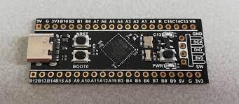

The Material required For this project is:

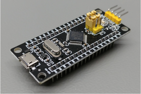

  • STM32F401CE

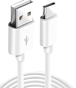

  • C-type Cable

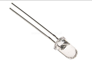

  • LED 3v

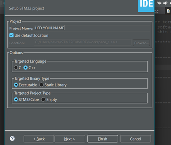

Open STM32cubeIDE>> file>> New>> STM32 project
Step 2: Select Board and Name of Project
After opening new project select the board STM32F401CE
and After Selecting board name your project.

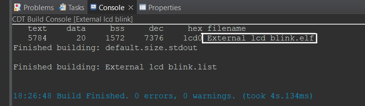

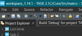

Step 7: Debuging
After writing code, Debug using Hammer option as shown in figure and your coding file is saved as name given in console.

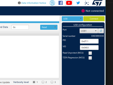

Step 8: Connecting STM32F401CE
Open STM32cubeProgrammer change ST-LINK to USB and click Connect, while our stm32 board is connected with Your PC by USB
Step 9: Uploding Code
Goto Erasing and Programming option>>browse your file path.
choose option as shown in the picture. Click Start automatic mode.

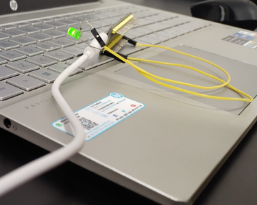

Step 10: Finish
Your Led will Start blinking .
