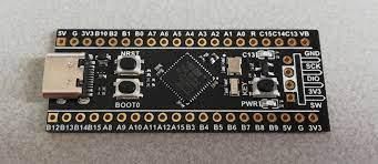

  1. STM32F401CE

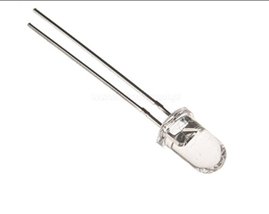

  3. LED

After opening file, Choose your Board ,we are using STM32F401CE Board.

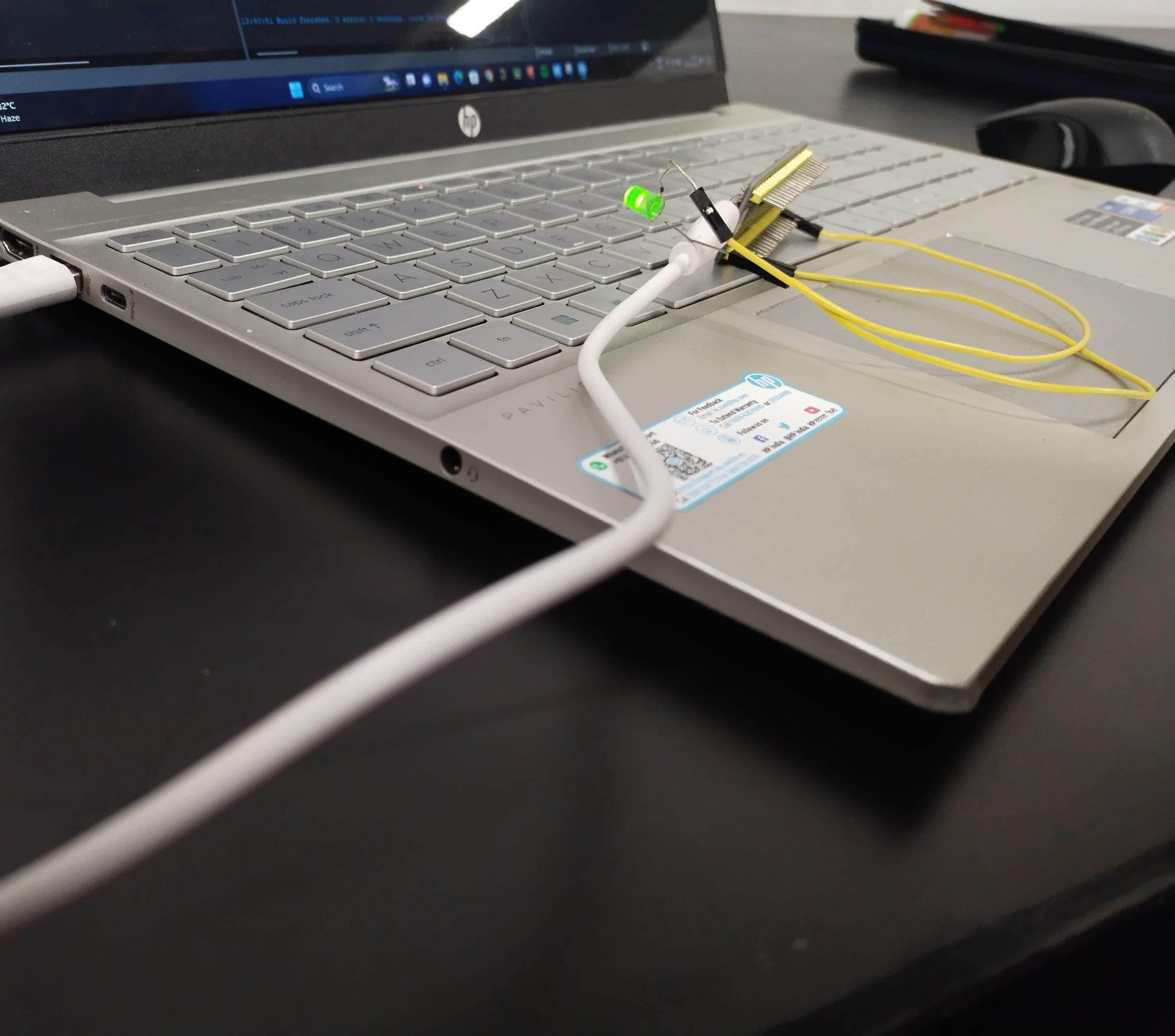

Open STM32cubeProgrammer and connect your STM board (For detail refer to previous Blogs) ,
Open erasing and Programming option and enter your saved file path or browse it.
select option as shown in picture, Now click start automatic mode.
YOUR LED BLINKING PATTERN IS CREATED. :)
