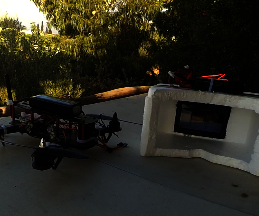

Step 2: Building the Frame With the Mechanical Parts
the bottom plate of the f450 frame include power distribution board, this board distirbute the power from the battery to the 4 ESC.
there is 5 parts you need to solder before you start to build the frame:
1. battery plug
2. 4 ESC
solder the esc red an black wires to the PDB outputs. the red wires to the + base, and the black to the - base. solder also the battery plug to the PDB input.
after you finish the soldering process, you can build the frame, it supposed to take 5 minutes. then you can place the motors in their places. when you place the motors, point the wires to the center of the chassis.
install the propellers like you see in the picture, the white arms (in the picture) are the front of the quadcoper. there is 2 CW props and 2 CCW props so be carefull not to make it wrong.
