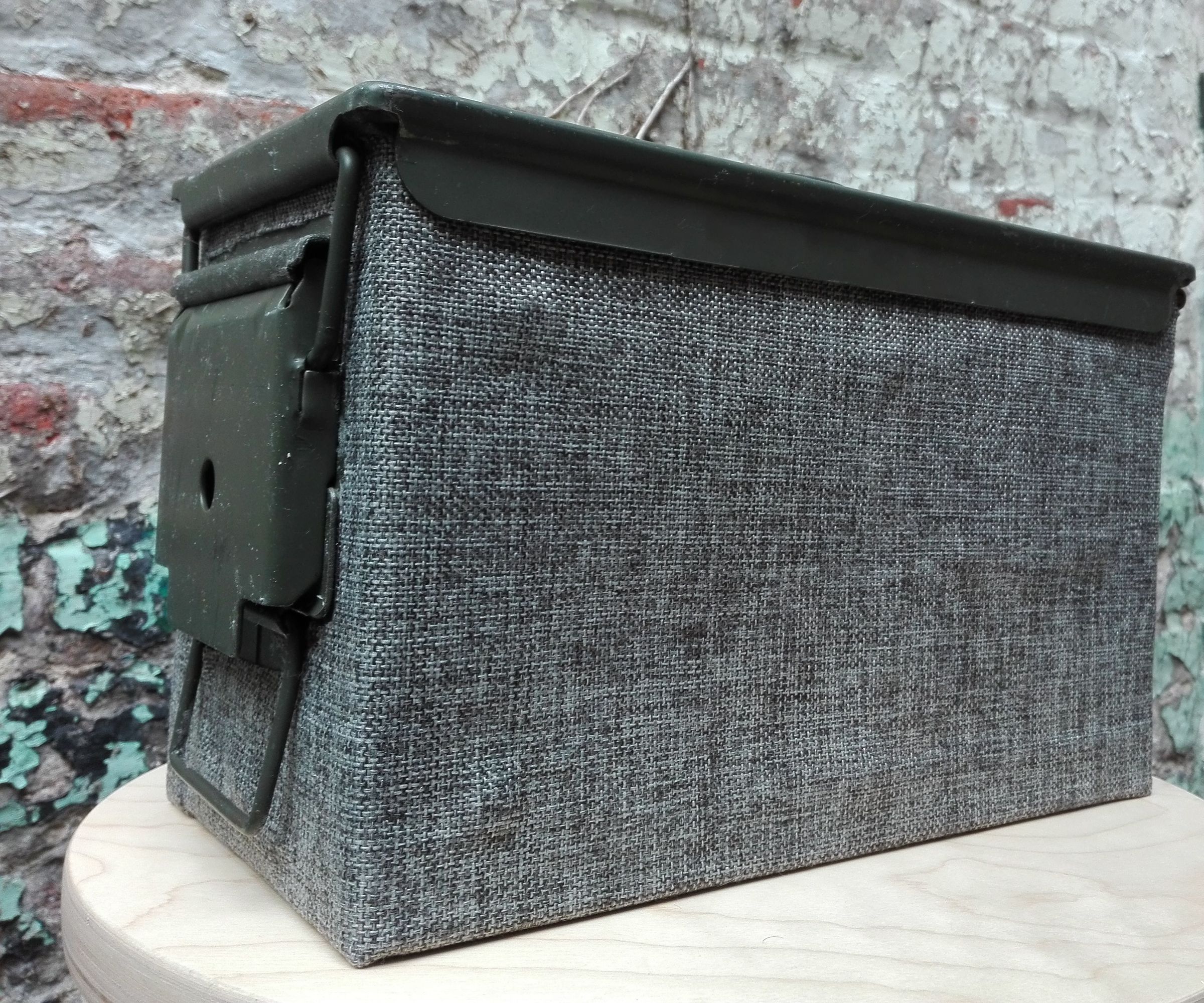

The box
I have used two military French first aid boxes. They are water proof and very strong. I have bought them in a military surplus.

Step 2: The Box
To cut the box I made a muster diagram using a drill, jigsaw and grinder I cut the holes for speakers. That was a quite difficult step and the circles are not perfect but the speakers fit well. Then, I have cut an aperture on the bottom of the first box and on the top of the second to let the air pass through the two boxes. I have sealed the two boxes together with silicone and added 6 bolts to strengthen the structure. After making the cuts and drilling, I sanded down and painted the box before inserting the components. I used hammered effect paint, which I think gives volume to the metal.
Step 3: Inside the Box
Inserting the amp was a really difficult step! The holes that I have drilled are ugly and the more I tweaked the knobs of the amp, the worst it got. So I used the amp face screws to mount it on the box. I have kept the original foam protection around the amp: it does not heat because the power supply is external. Therefore it is protected against potential heat damage.
Wiring the speakers was easy, just weld the wire on the speaker connection and plug into the banana plug amp. After that I wired the RCA of the amp to the female jack frame. For the electrical part I made the mounting shown on the diagram in the first step, including a battery switch DC jack frame and rechargeable battery frame. I used a terminal to mount batteries in series and a switch to allow use of either batteries or AC power. I promise to add more wiring pictures soon.

I applied 3 coats of paint.
Step 5: Paracord
Two metallic handle are already on the boxes. I simply linked them with paracord to make a phone holder.
To conclude, I'm realy surprised by the acoustic power and quality of the speakers and amp. Loud are nice and doesn't need bass-reflex or passive radiator to boost them.
