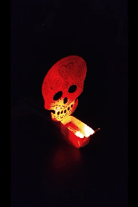

Shine some light on a customizable cut-out figure with this festive electronics project. Make an LED flashlight, a reflector, and a holiday symbol out of easy-to-find materials. Your holiday symbol will come to life as the reflected light washes over it. Make lots and create a holiday atmosphere in your home or classroom. In our example, we are using a skull to celebrate Día de Muertos or Day of the Dead; a Mexican holiday observed at the end of October to remember family and friends who have died. The shape of your Festive Flashlight is up to you – celebrate whatever, however you choose!

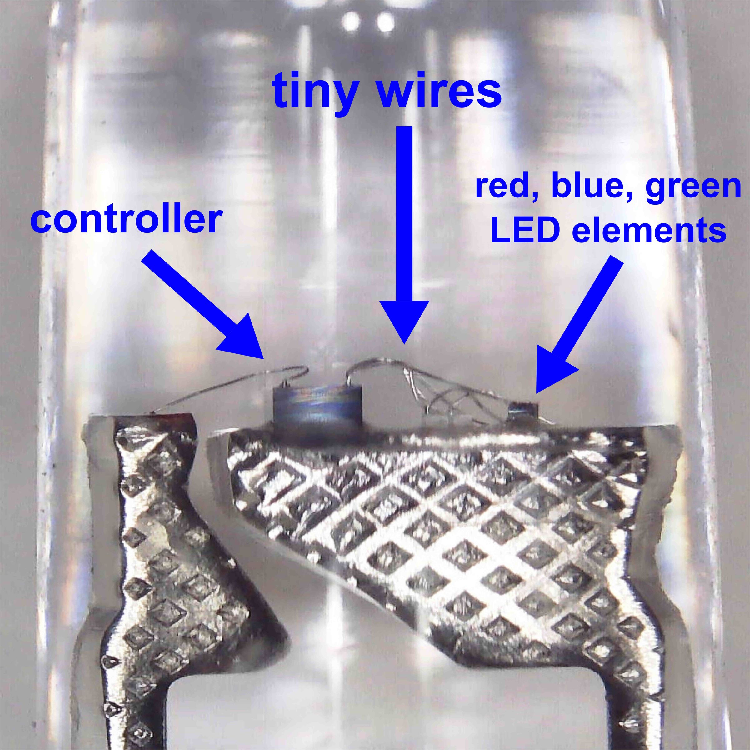

The color-changing LED used in this project is actually three separate LEDs – red, blue, and green – in one component, along with an integrated circuit that controls the cycling and timing of the color changes. All of this circuitry is crammed into a single 5mm LED package! If you look closely, you can see the block inside that contains the integrated circuit, as well as the tiny wires connecting to each LED.

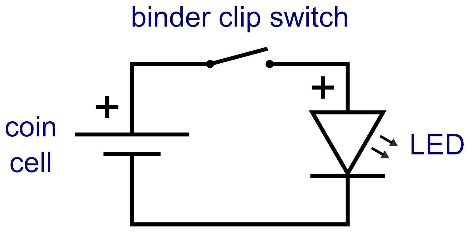

Step 3: Attach the Battery and Power Switch

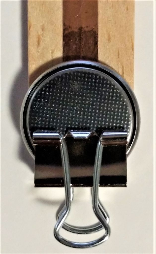

On the opposite end of the popsicle stick from the LED, attach the battery with the binder clip. The positive side of the battery is marked with a + symbol. This side should touch the copper tape that is attached to the positive (+) leg of the LED.
The NEGATIVE side of the battery is connected to the other side of the popsicle stick through the binder clip, which serves as a switch. Flip the handle of the binder clip down to complete the circuit and light the LED.
You have just created an electronic circuit! Flip the binder clip handle to turn the LED on or off by closing and opening the circuit.

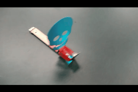

Attach the reflector to the flashlight. Experiment with the distance between the aluminum foil and the LED to get the ideal projection on your figure. Once set, secure the reflector to the flashlight with clear tape or glue.
![](https://content.instructables.com/FV4/5OYP/K4EC0ONW/FV45OYPK4EC0ONW.LARGE.jpg)
For best results, enjoy your Festive Flashlight in a darkened room!
