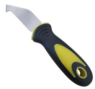

Cutting Acrylic
And, this is one thing I do feel qualified to talk about, cutting acrylic. My source is I worked in a hardware store for several years and learned to cut acrylic there.
First off, to cut it at home you need a tool, see the image on this step. its an acrylic cutting tool. They are fairly cheap, and this is once case where you really need the right tool for the job. The other thing you need is a straight edge longer than your piece. And a way to hold that straight edge, whether its clamps or a friend.
Place the straight edge on the good side of the cut, so any mistakes will go onto the waste side. Again, double check your measurements, and make sure they are to the correct side (the side you'll be cutting on) of the ruler.
Clamp the straight edge or get your friend to hold it down.
Score the acrylic sever tiles, pressing the tool against the straight edge the whole time.
once you have a noticeable gouge in one side of the acrylic. Remove the straight edge and move the score to a sharp edge of a table or counter top. You'll notice in the video I had cardboard under the acrylic the first time and that didn't provide enough pressure. So I removed that then placed a metal ruler under the score line.
You need to hold the good side on the top surface, then apply pressure on the waste side opposite the score line. Depending on the thickness, length of the cut, and how deep the score you made is it may take a bit. If it really feels like its taking too much, you can line up the straight edge and make a few more passes with the scoring tool.
Another thing you can see in the video, is the acrylic film, after the sheet breaks at the score line, use a blade to cut the film on the back side.
I always leave the film on as long as possible, as it prevents scratches and fingerprints.
