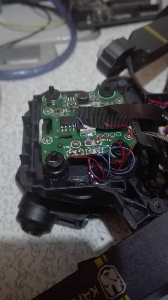

  • Locate the gimbal assembly: Once the casing is removed, locate the gimbal assembly inside the drone. This is usually a small, delicate mechanism that holds the camera and allows it to move smoothly.
  • Inspect the gimbal wires: Carefully examine the wires connected to the gimbal motors. Look for any disconnected or damaged wires that may be causing the issue with your camera gimbal.
Now that you've opened up the drone and located the gimbal assembly, you're ready to proceed with fixing the disconnected wire. Proceed to the next steps for repairing the wire and restoring your drone camera gimbal to working condition.

  • Check for Disconnections: Carefully examine each wire connection to ensure they're securely attached to the gimbal motors. Look for any signs of damage or loose connections that may be causing the issue with your camera gimbal.
  • Trace the Wires: Follow the wires from the gimbal motors to their connection points on the gimbal control board or main circuit board inside the drone. Take note of their routing to ensure they're properly aligned and not pinched or damaged.
  • Verify Connections: Gently wiggle each wire connection to check for any signs of looseness or instability. Ensure that all connections are snug and secure to prevent any further issues with the camera gimbal.

  • Prepare the Wires: If the wires are damaged or disconnected, trim off any frayed or damaged ends using wire cutters. Strip a small portion of insulation from the ends of both the wire you're attaching and the existing wire on the gimbal motor, using wire strippers. This will expose the metal conductors for soldering.
  • Tinning the Wires: Apply a small amount of solder to the exposed metal conductors of both wires. This process, known as tinning, helps improve conductivity and ensures a strong solder joint.
  • Position the Wires: Carefully position the replacement wire (if needed) and the existing wire from the gimbal motor so that their tinned ends overlap.
  • Solder the Connection: With the wires properly aligned, touch the tip of the soldering iron to the joint where the wires meet. Apply a small amount of solder to the joint, allowing it to flow evenly and create a secure connection between the wires. Be mindful not to apply too much solder, as it can create excess buildup and potentially lead to short circuits.
  • Inspect the Joint: Once the solder has cooled, visually inspect the solder joint to ensure it's smooth, shiny, and free of any gaps or cold joints. Gently tug on the wires to check for a secure connection.
  • Repeat for Additional Connections: If there are multiple wires to solder, repeat the process for each connection, ensuring that each joint is properly soldered and insulated.
  • Protect the Connection (Optional): If desired, you can further insulate and protect the soldered connections using heat shrink tubing. Slide the tubing over the soldered joint and apply heat using a heat gun or lighter until the tubing shrinks and forms a tight seal around the wires.
  • Allow to Cool: Allow the soldered connections to cool completely before proceeding to the next step.
By carefully soldering the faulty wires, you'll effectively repair the connection and restore functionality to your drone's camera gimbal. Proceed to the next steps for reassembly and testing.
