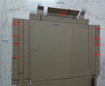

Here are all the pieces to make the table tennis table. Print outs would be to big so you will have to draw them on the cardboard directly. I have marked out the dimensions to all the pieces. i have used a color code to make it easier : Blue = the dimensions of the piece; Red = indicates where the slits are and its dimensions; and Black (dotted)= are where the folds need to come. I have named the pieces so that it is easier to communicate which piece i am talking about. Here are the list of pieces: Ax2, A1x2(they both share the same dimensions other then the flap in A1), Bx2, Cx2, Dx2, Ex2, Fx1.

Draw the pieces in the most efficient way saving as much carboard as possible. After you are satisfied with the placement, you can then cut the pieces in their rough sizes with an x-acto knife and then precisely cut it with your pair of scissors.
TIP : when cutting with scissors only cut along the corrugated line because the other way damages the first layer of the cardboard. Although you will be requiring the scissors not too much because most of the templates have straight lines easily cuttable with the x-acto knife.
